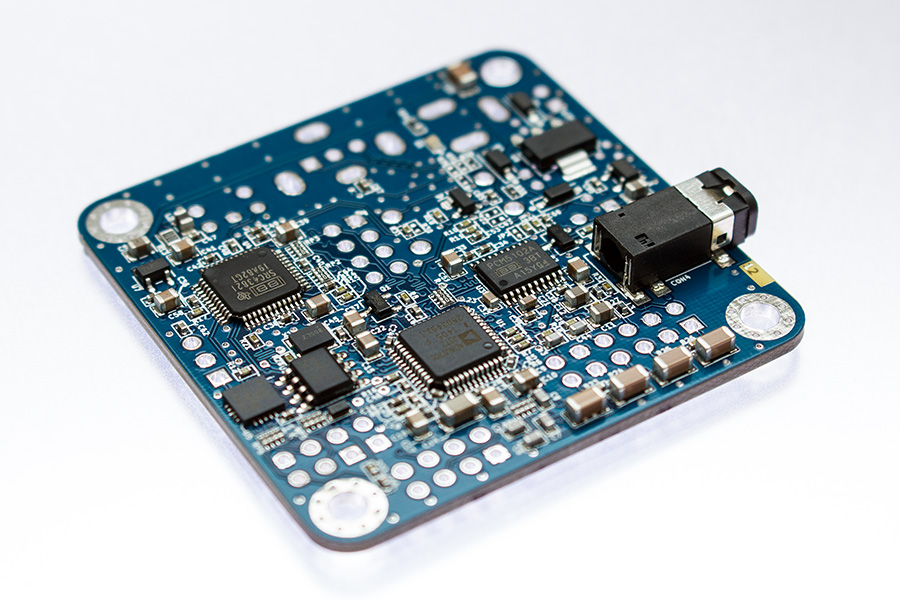

Yessir😎Zero ohm jumpers are my best friends 😉 With only a dual layer PCB and such a complex routing of all the I2S lines it's inevitable. I would much rather go to town with zero ohm jumpers on the top side than interrupt the ground plane!

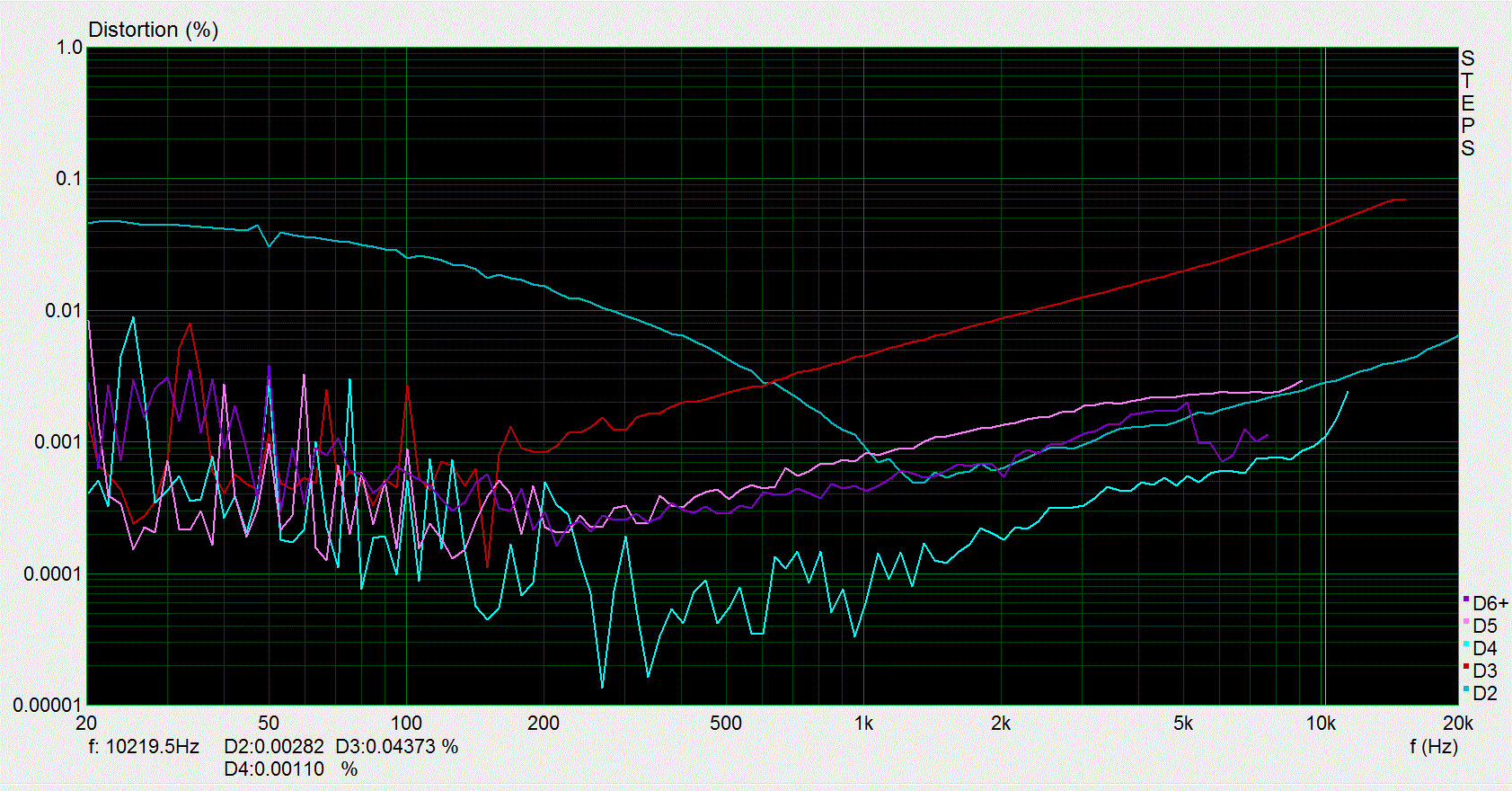

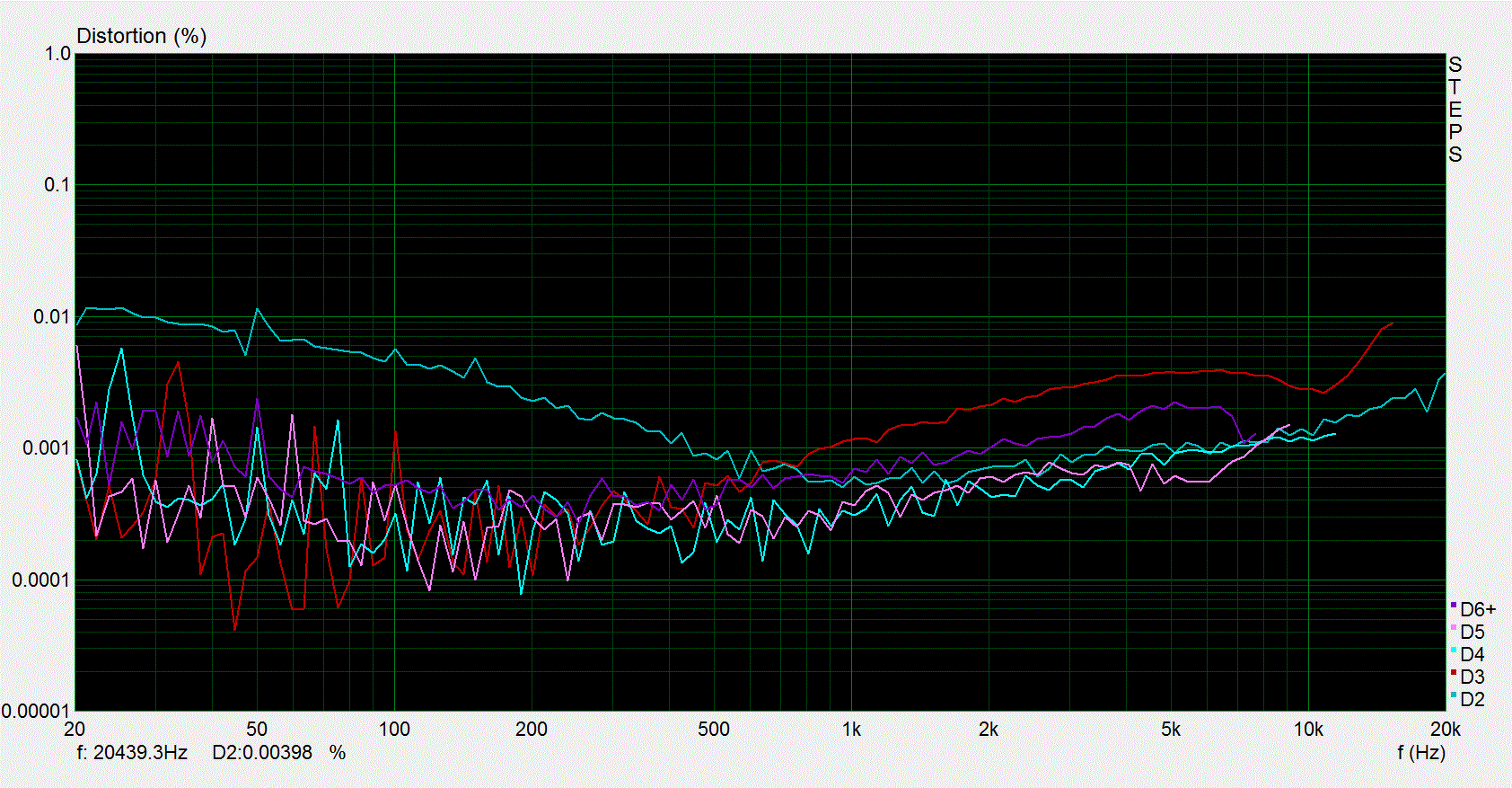

Okay so as mentioned above here are some measurements for the wee little beastie.
These measurements were performed using the SPDIF input to test the absolute linearity of the DAC and amplifier stages.
First up is a measurement of ~1 watt into my 4.7 ohm load.
And now a little over 10 watts into the same load.
This is only one of the channels. I measured both and this is the one that performed the worst.
First of all pay attention to the third order harmonics, the red line. As these are balanced, bridged amps odd order distortion dominates as the even order products are cancelled by the output stage configuration.
The important linearity check, from my perspective, is the magnitude of the third order products at high frequencies and checking to see if these are in line with what the datasheet says the amplifier should be capable of. The higher frequencies are where things always start to fall apart as levels of feedback start to drop inside devices and parasitic non linearities become more dominant inside the inductors. Here though it can be seen that the levels of third order are quite similar to the datasheet, so I am happy.
The other thing that jumps out is the rising 2nd order as frequency decreases becoming more significant as output power rises. This has been confirmed, both by myself and TI, as being a 'design fault' as it were with the device. The PSRR of the device could be to blame for this and certainly the degree to which the rising 2nd order occurs is affected by altering the value of cstart. Here I am using a 0.1uF capacitor and increasing it improves things significantly but it does cause the device to start up less elegantly. 1uf does work but you can sometimes hear a hiss or wooshing sound through the speakers as it powers up.
As far as I am aware the PSRR of the device is flat with decreasing frequency, so certainly doesn't deteriorate, more it's the devices requirement for extremely low supply impedance that causes this. TI use an expensive and high power bench power supply with remote, point of load, sensing, for doing just this and as a result the performance of the amplifier isn't affected. Increasing the amount of bulk decoupling capacitance directly affects the rising distortion with more farads resulting in less 2nd order products so this is one way to help combat it. It is just a good thing that 2nd order distortion isn't particularly audible and especially at these levels. Still it's a fly in the ointment and is clearly an area TI could improve upon.
That aside the rest of the performance is very good, higher order harmonics are well suppressed staying at below 0.001% for the lower frequencies. D6+ appears quite high simply because it's grouping together every harmonic beyond the 6th into one. Individually the higher order harmonics are very low in magnitude.
One thing to note about the performance is that it gets even better at lower power levels with all of the harmonics essentially disappearing into the noise floor. Although I haven't shown an FFT plot it is essentially completely clean when the power is lowered. For me this is important as the vast majority of my listening is done at sub 1 watt levels.

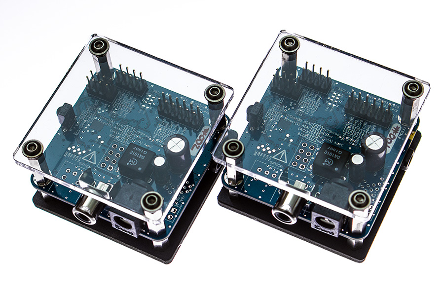

Nice work as usual. If it had a USB input I would probably have to have one 🙂

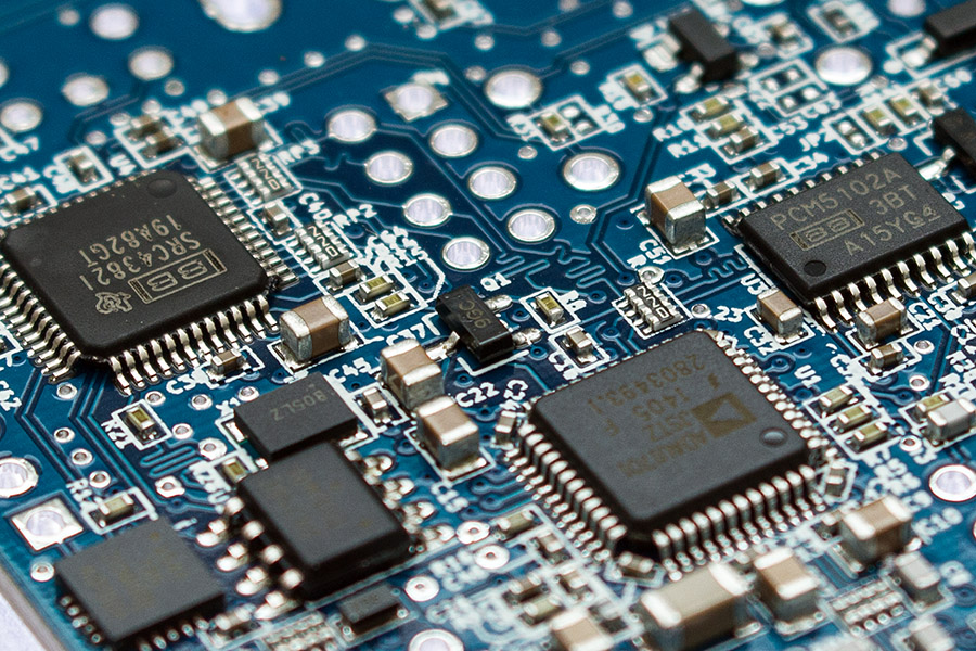

Am i correct in my assumption that the ADAU1701 only does 1024 operations per cycle at <=48kHz? Would seem to add up based on quoted MIPS.
Well, unfortunately there's no more space for another USB-I2S solution. 😀 (As i don't want to have it SMT populated on both sides. But there's another I2S in for the SRC and ADAU so a "shield" would bring in new "magic".
You're right, the DSP is fixed 50 Mips, so increasing fs to 96kHz would half the availble instructions. (Which i wont recommend as the internal ADC/DAC section will still run at 48kHz and just put out "upsampled" data)
USB receivers are a nightmare, so hard to find one that does everything I want, and is also able to be done DIY. I may just have to concede and program my own.
The ADAU can still run DSP operations on I2S in/out bypassing the internal ADC/DAC sections correct?
Also, any reason you didn't go for the PCM5242 or PCM5142 with their built in miniDSP core (same 50 MIPS)? Admittedly I do find the 50 MIPS to be a bit limiting, but only because I have the (completely unnecessary) desire to run the DACs at the full 32/384 they are capable of.

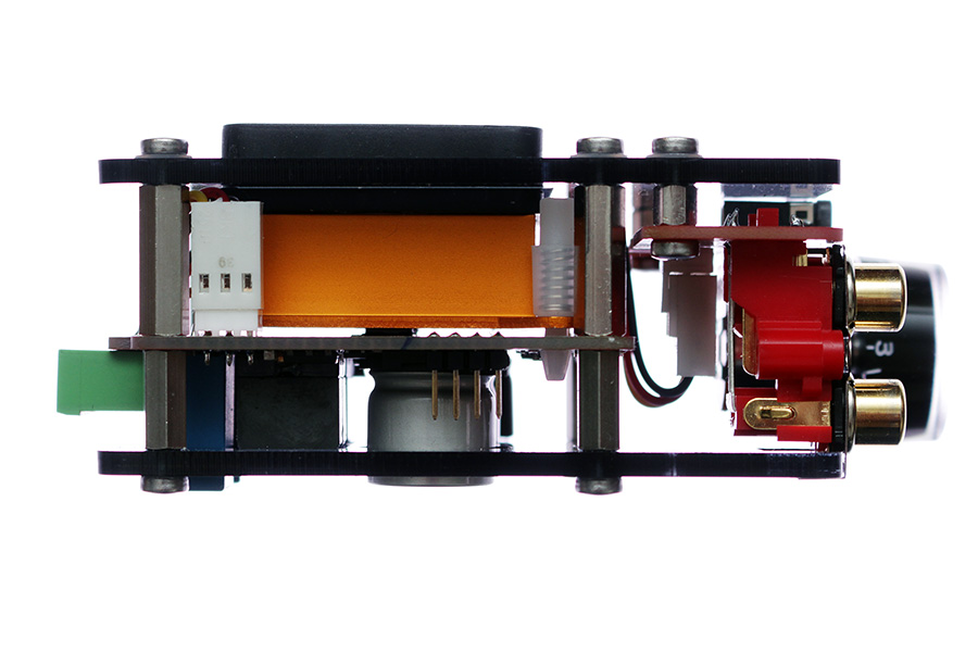

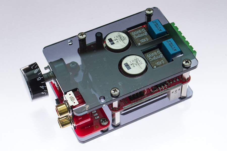

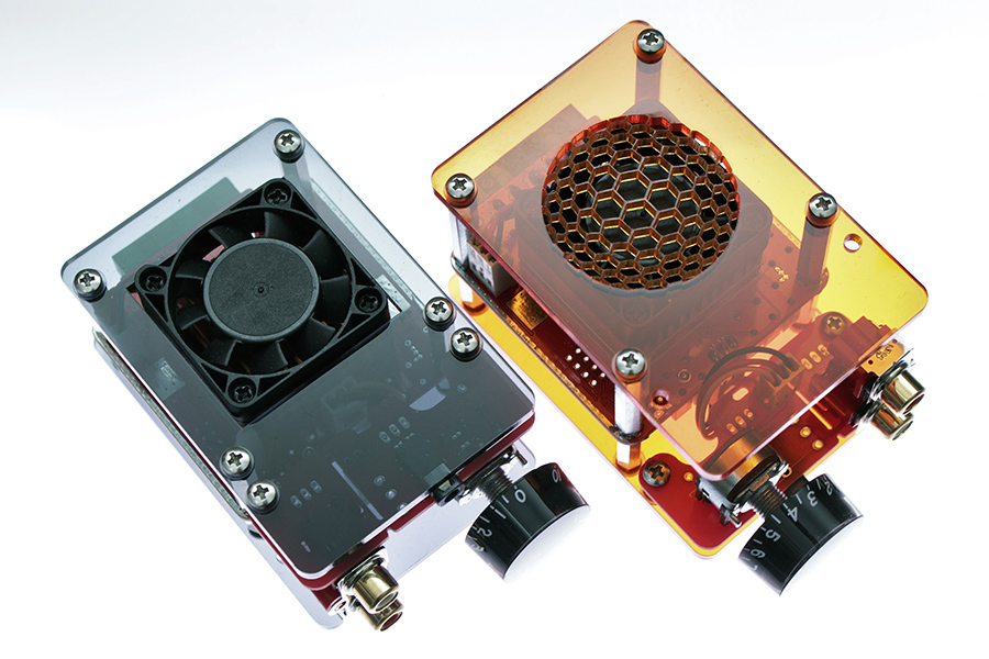

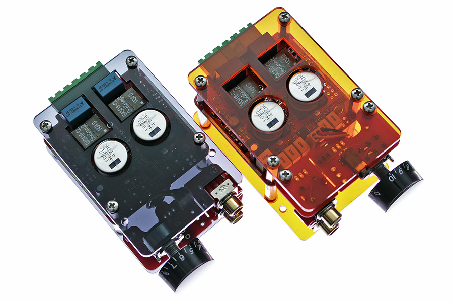

I iterated the case-design to take care for the output caps as well. So this is pretty much the final size/height. 🙂
Om nom nom 😀
