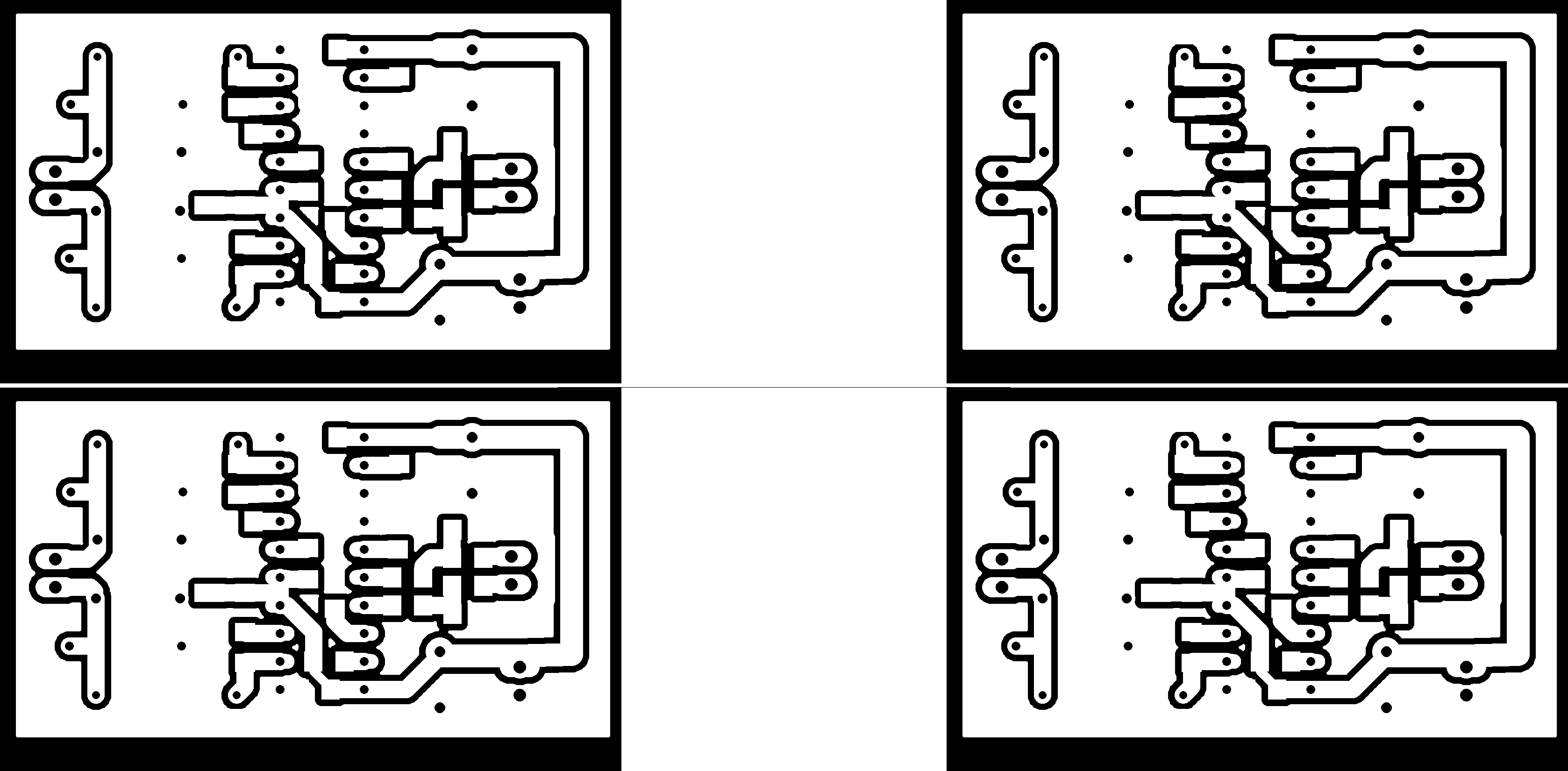

OK, I don't know if this is what you were looking for, but I gave it a shot anyway.....
Yeah, that's what I was looking for. Thanks

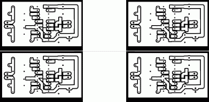

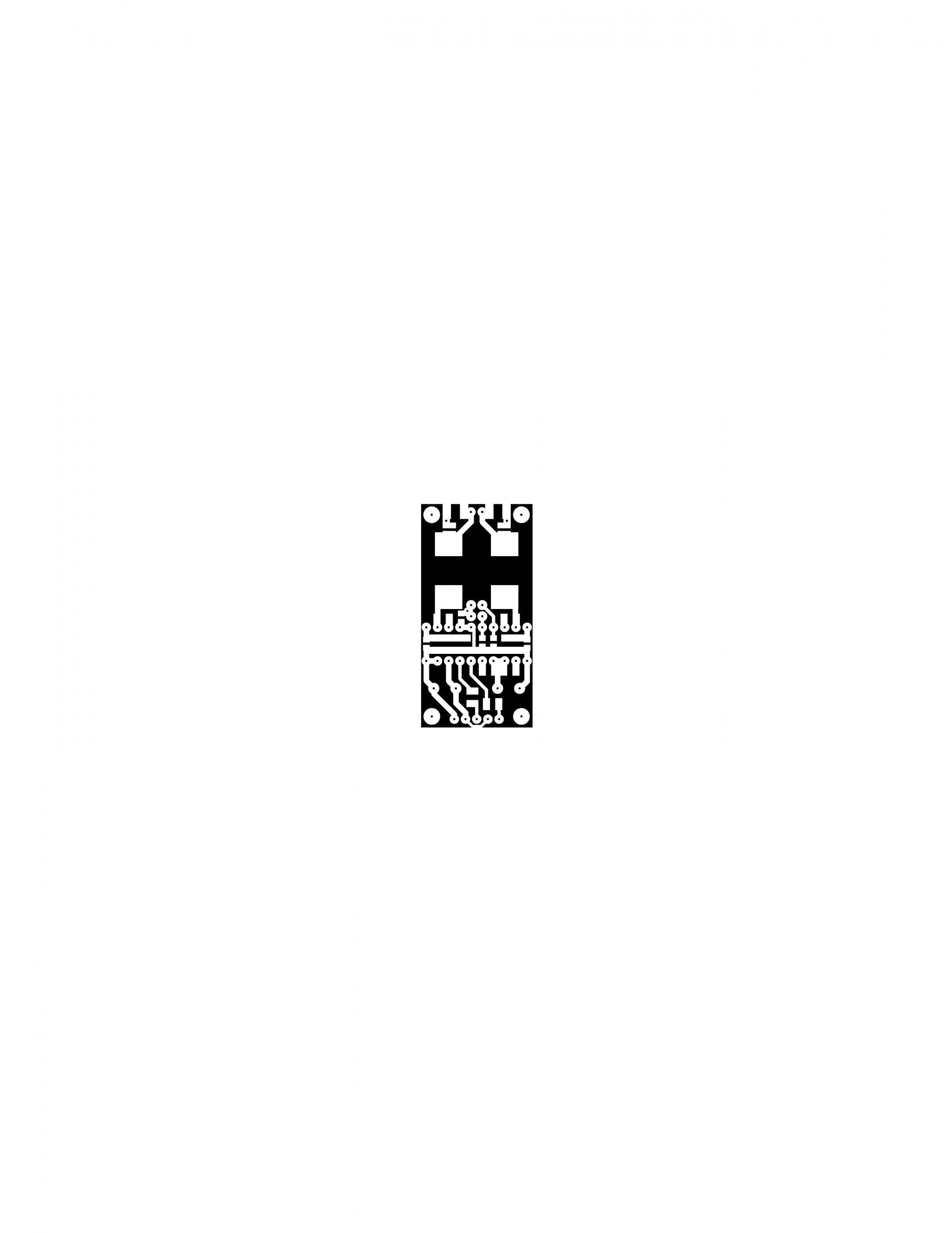

Also, here's the new PCB I made (+ masks), this one is SMD. (the mask has four of them because I made a stereo one, and masks printed with a laser printer work better if you use two of them on top of each other)
