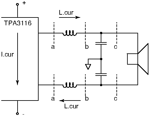

Hi indika,
The chokes are the yellow rings (cores) with copper-wire windings.
I will explain why I suggest to remove the two chokes with reference to the schematic I made.
Considerable current drawn by a TPA3116 chip (from “+” to “-”) is either a load-current (arrows “L.cur”) or an internal current (arrow “I.cur”). Without a signal at the input, a Load current may be due to a wrong signal level at the input of the TPA3116. Such we have a chance to repair. An important Internal current should not exist and if it is nevertheless there, it is likely to be due to a defect TPA3116 chip. That your speaker-cone jumps in-and-out shows that you have an important Load current but perhaps this is because you have an important Internal current as well. How do we check if you have an important Internal current? You have to prevent the Load current from flowing.
Preventing the Load current from flowing would be achieved by removing the speaker, thus cutting at the points “c”. But cutting at the points “c” would leave the LC output filter un-dampened (the load provides the dampening) if a resonance is exited. Such would put a risk to the circuit – see the very first postings in the very long TPA3116 thread (by DDAPKIS). Thus, just removing the speaker would be unsafe. Therefore, we have to disconnect the output filter while testing for current consumption. This is done by cutting (de-soldering) at the points “a”. BUT, a rather heavy choke fastened to the PCB with only one lead will move around and risk causing a short-circuit to something else. This is why I recommend removing the two chokes by cutting the circuit (de-soldering) at both the points “a” and “b”.
When the output filter and the speaker are no longer connected to the TPA3116, only the Internal current (“I.cur”) can cause a high current consumption. Said in other words, if your amplifier plays well with the remaining stereo channel and the sub, and the supply voltage ripple is low, we have a chance of making the faulty channel work. If the amplifier does still not function well and the supply voltage ripple is high, it is a sign that the Internal current is high. A high Internal current is likely to be due to “shoot-through” current in a push-pull stage of the TPA3116, used for the faulty channel. Such is most likely a TPA3116 chip defect that cannot be repaired.
NO SUPPLY VOLTAGE when you remove the chokes!
I hope that this explanation makes it clear why I suggest removing the two filter chokes.

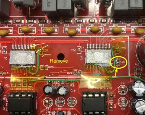

Hi indikaperera-San,
I've read this threads, now I can say "Something wrong on your TPA3116D2 Chip(s)." Perhaps you need to replace it anyway.
There are several points to improve the sound performance, reliability and usages.
But I strongly recommend following two points only before replace to new TPA3116D2 Chip(s).
1. Replace all Toroidal Core Inductors change to Hi-Current Capable Power Inductors (10uH - 22uH).
2. Remove C40 capacitor on clock synchronous line.

Hi..Thanks..mate..2nd step means that box capacitors next to the coils..isn't it? so to which item to be replaced..
thanks..indika
