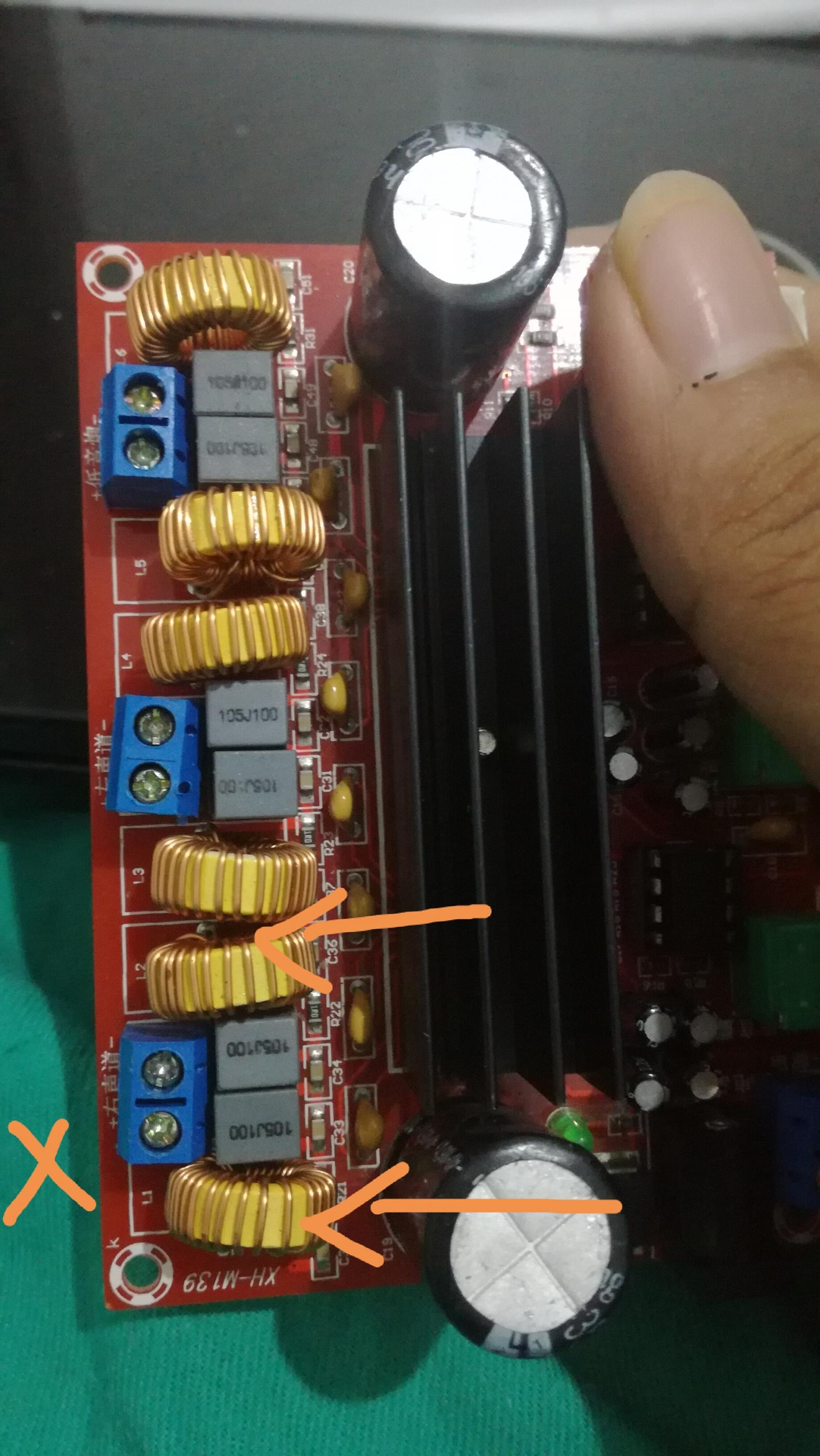

Can you please post a photo of your board with the connections you used (no power)?
hi thanks mate....here is attached my board pics

Thanks for the photo.
You are not the only one having this problem.
Try for a start to do the following measurements: NO power connected, speakers disconnected, Ohm-meter in 20KOhm range - measure from all 6 output lines (2 for sub, 4 for stereo) in turn to power "+" and then to power "-". Do any of these measurements give you less than 1KOhm?

Hi..friend.. I have checked all the ports along with + and - so reading as follows,
(-) --- all the port pins give arround 12k
(+)--- all the port pins give around 70k
any idea?

Hi indika,
My wife has put me to work so there are delays in-between my postings.
I have removed some 5-6 defect TPA3116 chips and all of them showed less than 100 Ohm between one output line and one supply terminal. You passed that test so there are chances for repair.
Can I persuade you to remove the output filter coils (two) for the channel where the speaker just moves in and out? We need to see if large current is running through that output (and load) only or it is also inside the chip (from the supply pin and down to ground directly).
When you have removed the two filter chokes, put speakers on the two outputs with filter chokes and see what happens when you put power ON.

No, not as I understand you. It is not a matter of just removing the speaker because then you end up with and unloaded class D output and that may damage the chip. You have to disconnect at least one of the wires to each of the two chokes (toroidal inductors), eventually remove the two chokes completely.
I have a doubt inductive coils are just a coil though..so how they misbehave..����

there are few coils..which one should I remove? sorry friend I am novel to this electronics..I am not genius like you..thanks , indika
If it is the channel with the cross that misbehaves, these are the two coils to remove. It is not the coils that misbehave but we cannot just remove the load because the coils form part of the output filter (LC) that may damage the chip if the load is removed. This is an inconvenience compared to class AB amplifiers.
You will have to connect the coils again when the fault is found and corrected.
