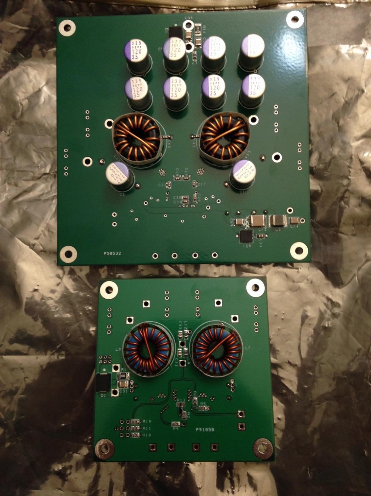

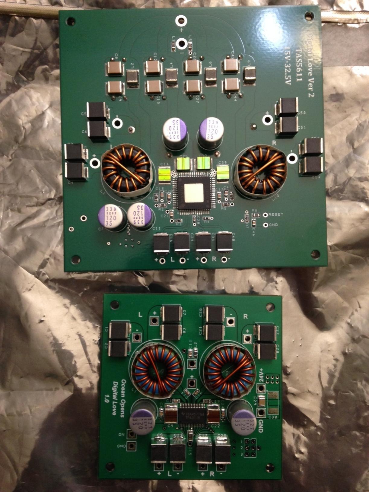

TAS5611A & TPA3118D2
The TAS5611 needs a bit more room. 😉

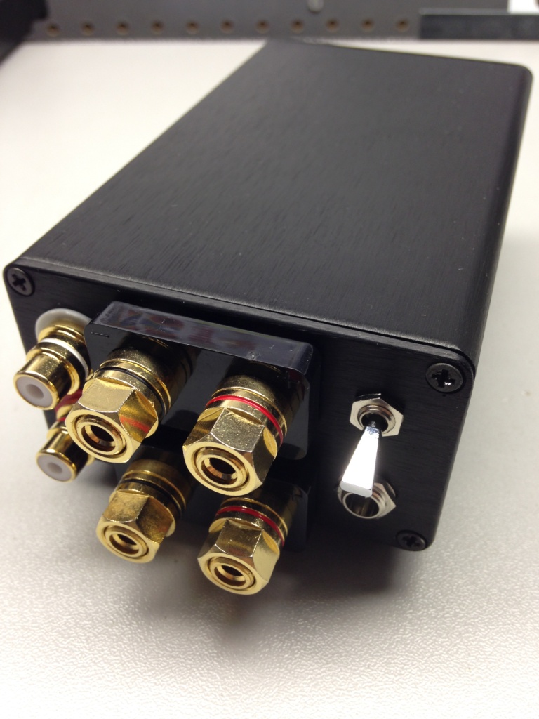

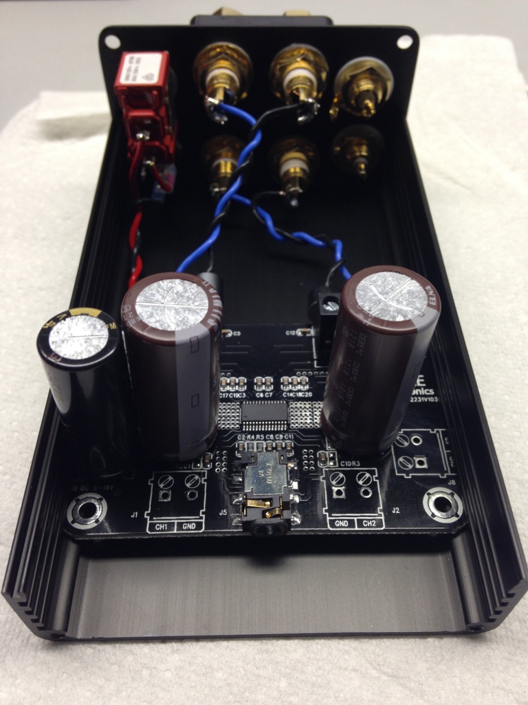

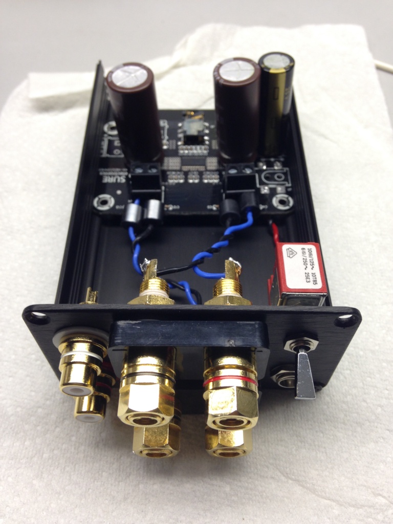

In the meantime, I've been playing around with the Sure Electronics TPA3110D2 amp boards and I really enjoy them. Here is my latest build in progress. I am waiting for delivery of some Belden 88641 shielded hookup wire to connect the RCA connectors to a Panasonic EVJ 50kohm audio taper volume pot that will be mounted on the front panel. I installed a pair of Elna Silmic II 1,000uF / 25V caps next to the TPA3110D2 chip, and a Panasonic FM 2,200uF / 25V cap on the thru-holes where Vcc and GND from the power supply are connected. The Ferrite beads are Bourns part no. FB43-287-RC from Digikey.
For a perspective on scale, this split Aluminum chassis from Context Engineering is the same length and slightly wider than my iPhone 5.

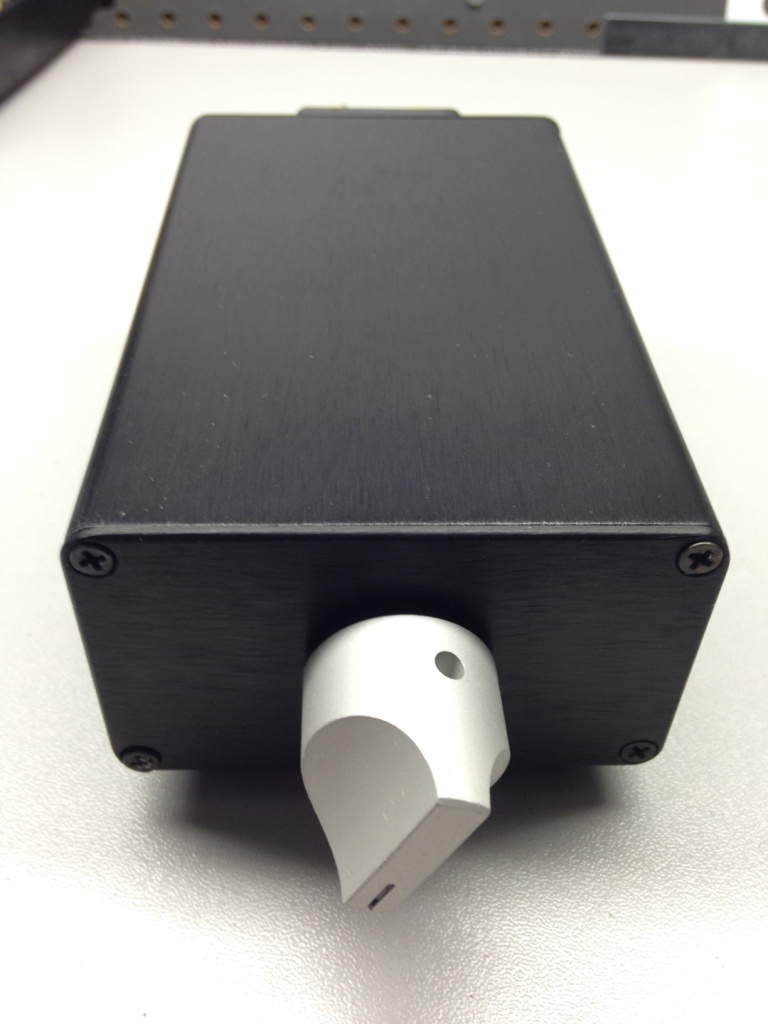

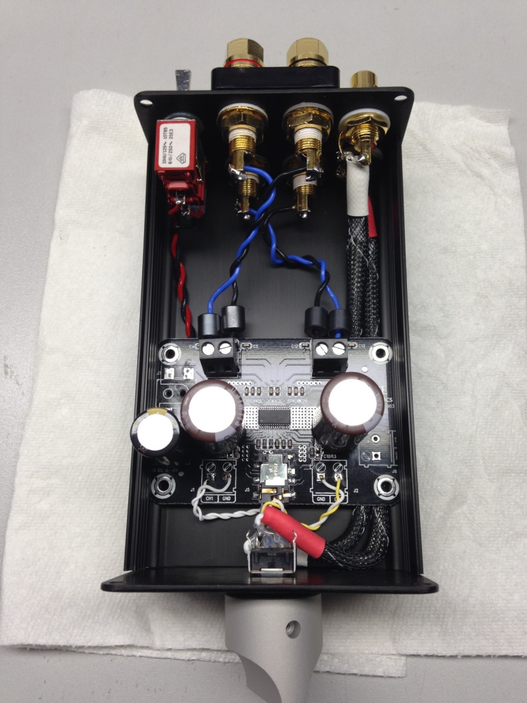

Okay, I decided rather than wait for the Belden 88641 shielded hookup wire to come in, I would make my own using some Mundorf Silver-Gold wire I have in my parts stash, Teflon tubing, Teflon tape, some Tinned Copper braided shielding and Techflex. The results are very positive, and I think I like the Mundorf Silver-Gold wire for the greater amount of detail and frequency extension compared to the solid core Copper wire I've been using lately. Once the cables were made, I wired everything up and now the amp is playing now. I'll have to give it some time before drawing conclusions, but I think I now have a recipe for some custom-made shielded wiring.
I have the little Class D amp connected to my ARC PH5 phono stage, ARC LS7 line stage and my upgraded Klipsch Forte II's. It's really amazing how good this amp sounds.

Very nice box you made - this is the Sure 3110 that you added big caps and ferrite beads to right? I used a cheap plastic snap lid lunch container box from the dollar store. 😀. On my 3116 I use Alpha wire rg174 shielded coax as signal lines from RCA to the inputs. Works great and is very thin (1/8 in dia). I happened to have a spool of it from another project.
Thanks. Yes, the amp module is the Sure Electronics TPA3110D2. The Alpha RG174 shielded coax is a good idea for shielded hookup wire. Is that a plenum-grade coax? I had previously used the Belden 88641 when I restored and modified a Dynaco SCA-35 6BQ5/EL84 integrated amp. It worked well in that application, and I had ordered some more.
Impatience and curiosity got the better part of me though. I had purchased the Tinned Copper braided shielding and Teflon tubing over a year ago from a local surplus electronics store with the intention of making shielded Mundorf hookup cables. I was just too lazy to actually do it until now. Necessity is the mother of all invention, right?
