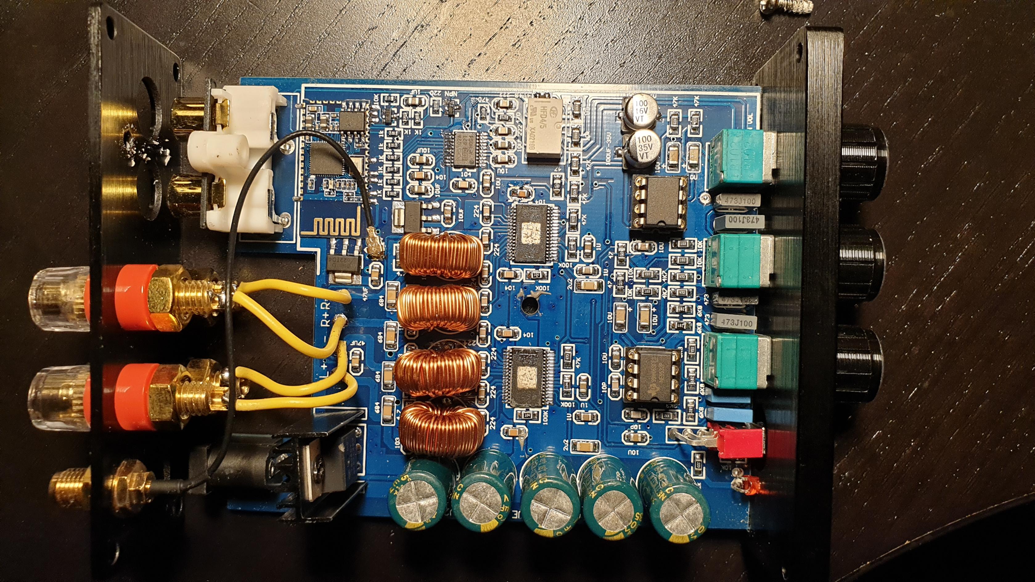

Hey guys,
Tried everything to get the low frequencies running with my 2.0 TPA3116 board but it was not working at all.
So I decided to buy a new one with bass adjusting knob. This one (Nobsound NS-G15 Pro) should go down till 10 Hz according to spec sheet. Tried it out today and get a (barely) hearable sound down till about 20 Hz which is pretty good so far. Buuuut the damping is raising significantly below about 35 Hz. But at least no cut off.
Do you have any quick and dirty idea on how to deal with that issue?
Most of the caps are smd which surprised me a lot. Hope this is not a show stopper for my aim to get low frequency output down to about 20 Hz with the lowest damping as possible even below 35 Hz.
Attached a pic of the board. Please let me know what else I could provide to give you further details.
Just checked the input impendance resistors and found a 100kOhm and a 47kOhm resistor for each TPA3116 chip. The inner ends of the two resistors are connected to each other (continuity tested) and the other end of the 100kOhm goes to the TPA chip.
Seems to be a very high gain then and I have the hope that removing the 100kOhm would already bring a great advantage in regards to volume raise for low frequencies (20-35 Hz).
What do you think? Worth a try?
If I do so I loose warranty and the chance of sending back the amp (in Germany we have a 14 days return policy)...
The TI datasheet:
https://www.ti.com/lit/ds/slos708g/slos708g.pdf?ts=1617188781476&ref_url=https%253A%252F%252Fwww.ti.com%252Fproduct%252FTPA3116D2
, Table 1 and Figure 27 show how you can change the amplifier gain and input impedance. 100K/47K most likely implements 36dB gain but an input impedance of only 9K! The reason why you have little low bass may be that the signal coupling capacitors value is to low compared to 9K input impedance. It may also be the coupling capacitor value at the output of the source.
To get better bass, you can lower the amplifier gain and get a higher input impedance. If you remove the 100K resistor, you have a gain of only 20dB (10x) but an input impedance of 60K. You also have less hiss.
Such boards typically need some modification to play best. If you prefer returning the board instead is your decision.

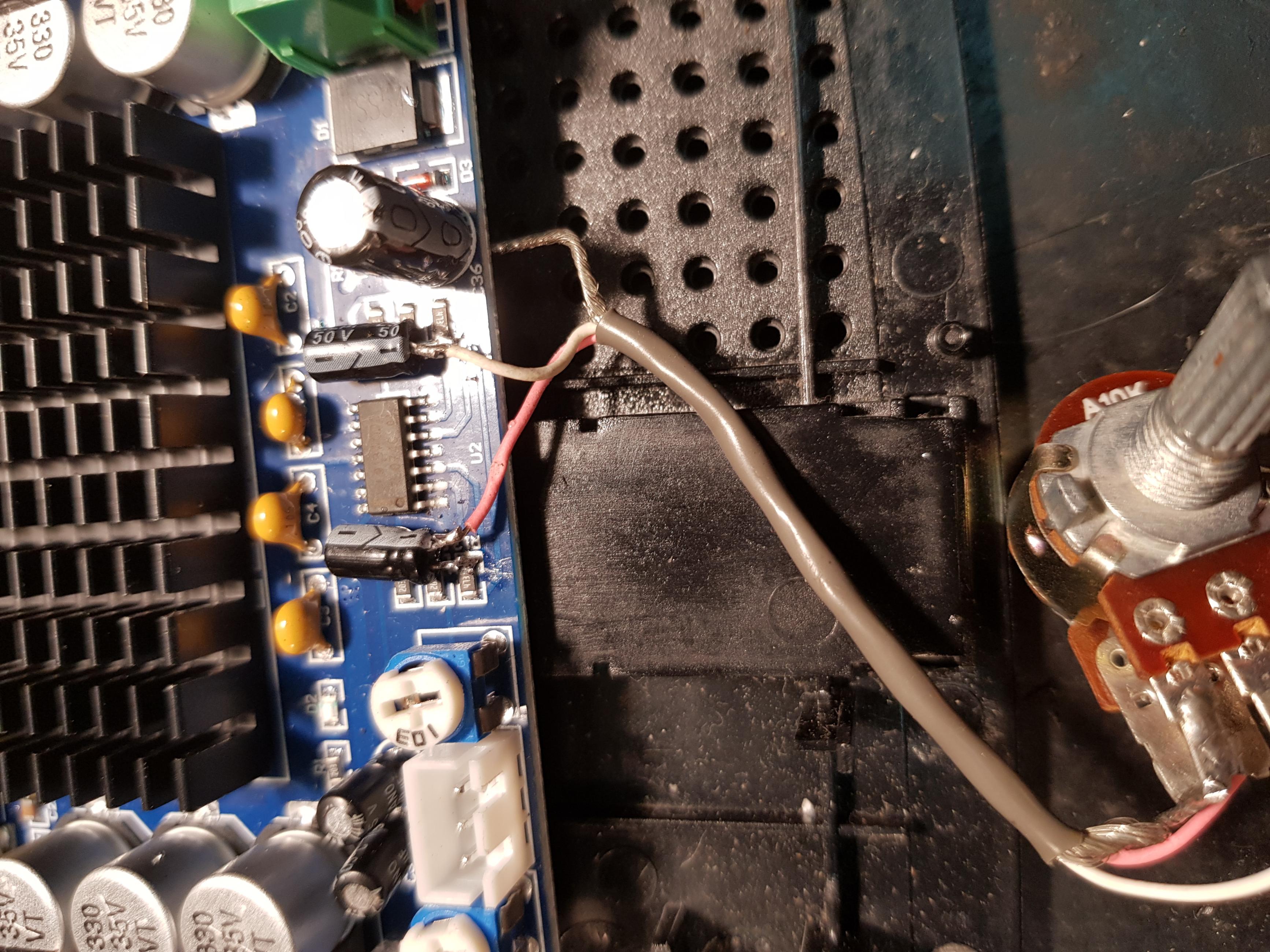

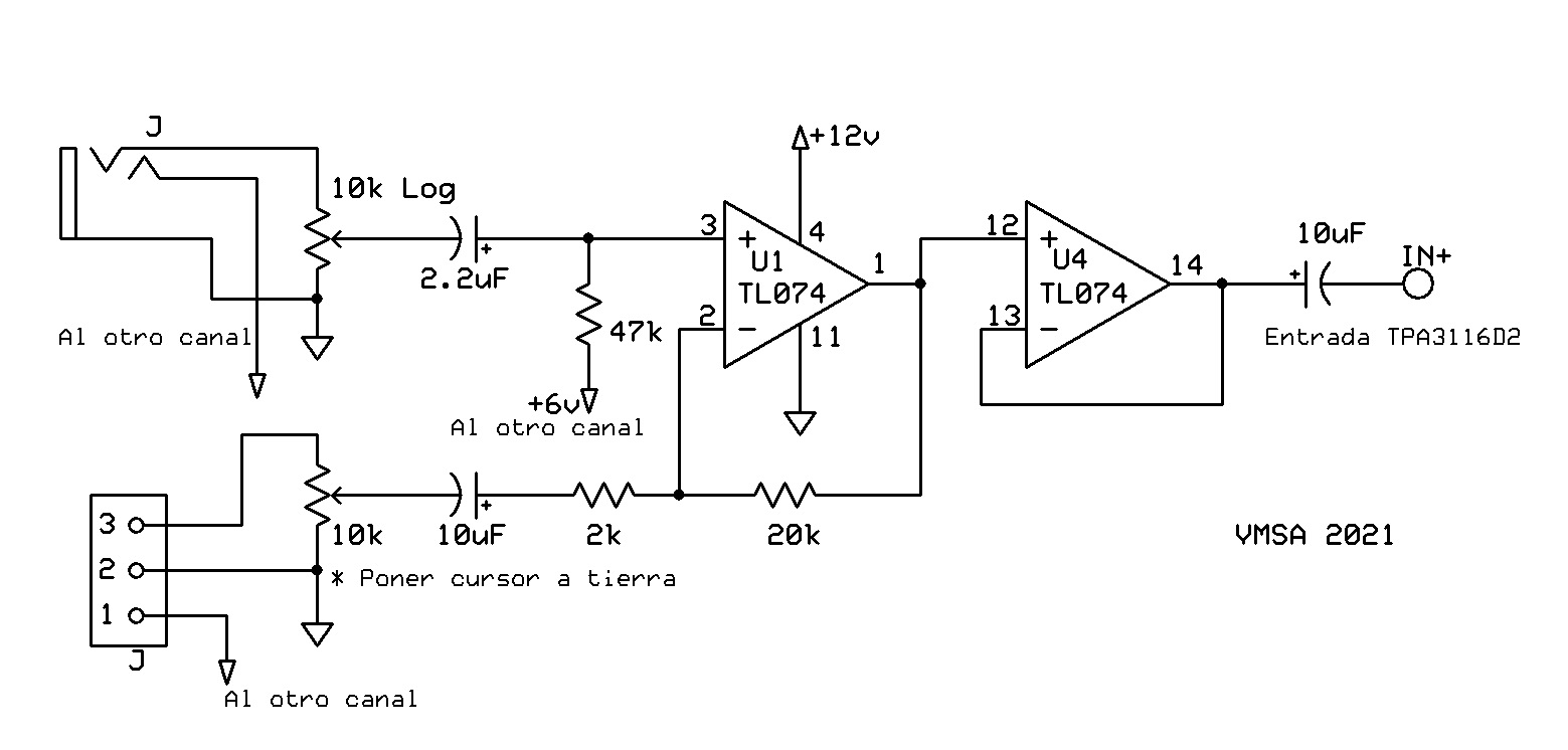

Hi!
Trying to improve a HX-M543 board and looking for information about it, I found the site commented by Cyber Pit very useful. And I reached to the same conclusions. But I made a different modification on the input preamp, which seems practical to me.
Circuit and Photograph testing of the mod implementation. (the legends are in Spanish but I hope you understand) 🙂

Thanks FauxFrench - I removed the two 100K resistors. Gain has definitely changed, I need to raise the volume to get the same output. Also the lowest frequencies (20-35 Hz) are not cut off anymore. BUT the volume curve still seems to drop down dramatically below 35 Hz - even with the bass volume being on max. I've now downloaded an win 10 equalizer so that I can adjust the low frequency range manually. It is "okay" now - but still not what I was hoping for.
Pretty bad to have all these smd capacitors on the board instead of some big ones. I am not even able to identify which capacitors are the main input caps and what I had to change to get more bass (20-35 Hz) out of that little amp.
One more info: I am using a 19V 4.7A power supply. Could it have an effect if I changed to a 24V something A power supply? I could try with a lot of effort (I have a 24V power supply on my ceiling for indirect LED lighting - quite a hassle to get it removed from underneath the indirect ceiling...). Worth a try? Could the power supply have an effect on the damping and the dropping of low frequencies? Or is it just "more power in total" then? Power in "total" seems to be fine at the moment.
Increasing the supply voltage should not have a significant influence on the frequency range. My TPA3116 boards are, as far as my rather untrained ears can detect, capable of delivering signals below 35Hz at good volume. I do not think that your missing low bass relates to the TPA3116 part of the circuit. Do you happen to have access to an oscilloscope? On YouTube you can download a frequency scan in the range 1Hz to 100Hz and with that (and an oscilloscope) you can check if your perception of little deep bass is objectively founded.
Apart from a TPA3116 power section, your amplifier board includes a pre-amp section with tone-controls. The reason for little deep bass may relate to this circuit which we unfortunately do not know how is made.
