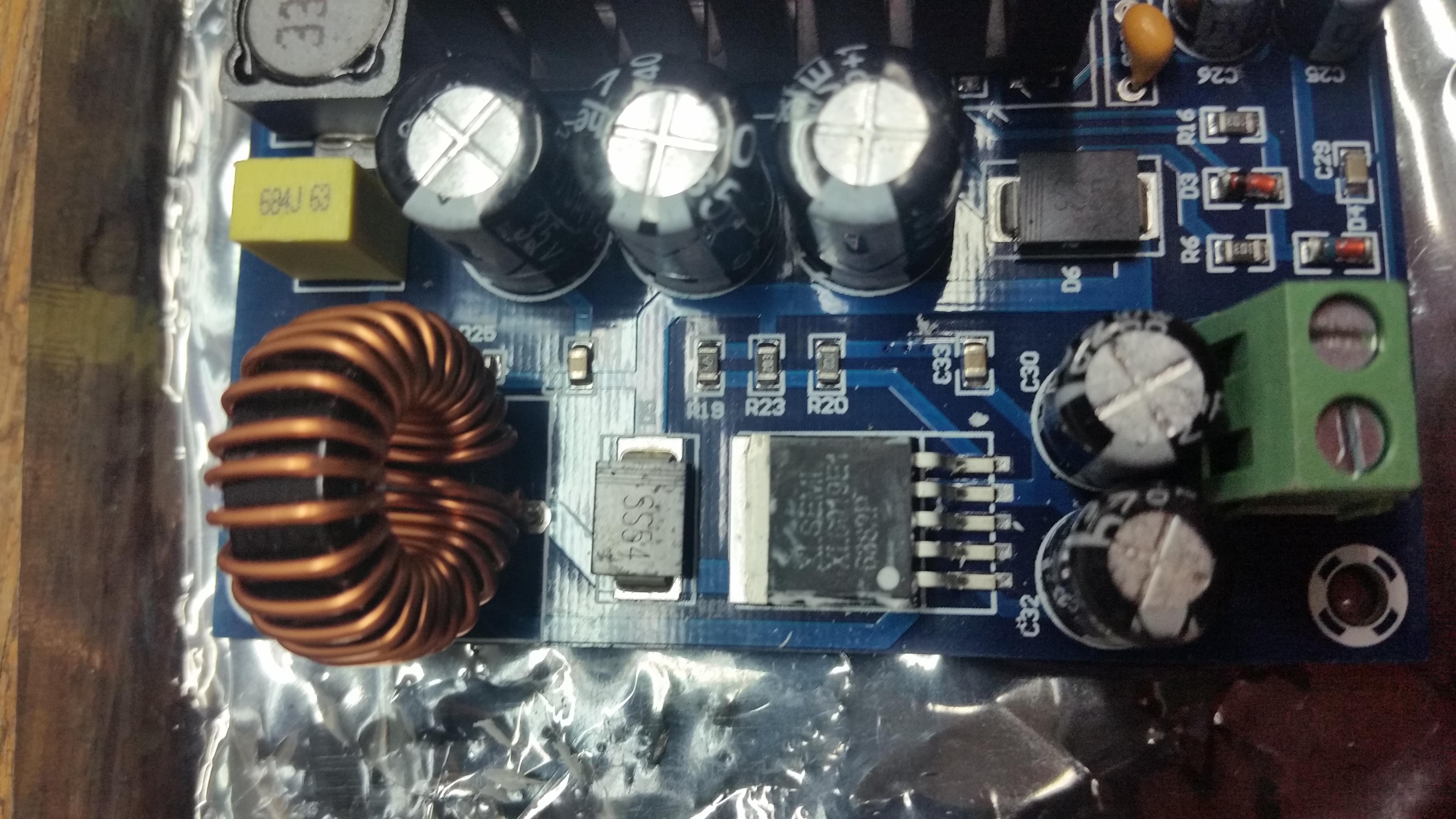

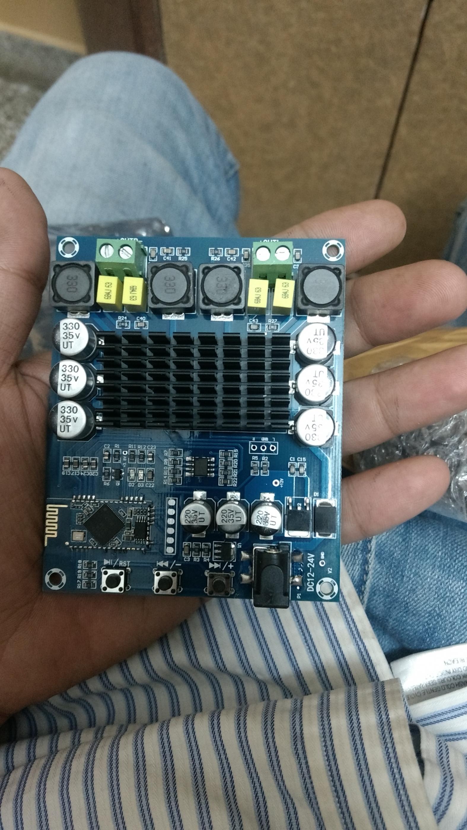

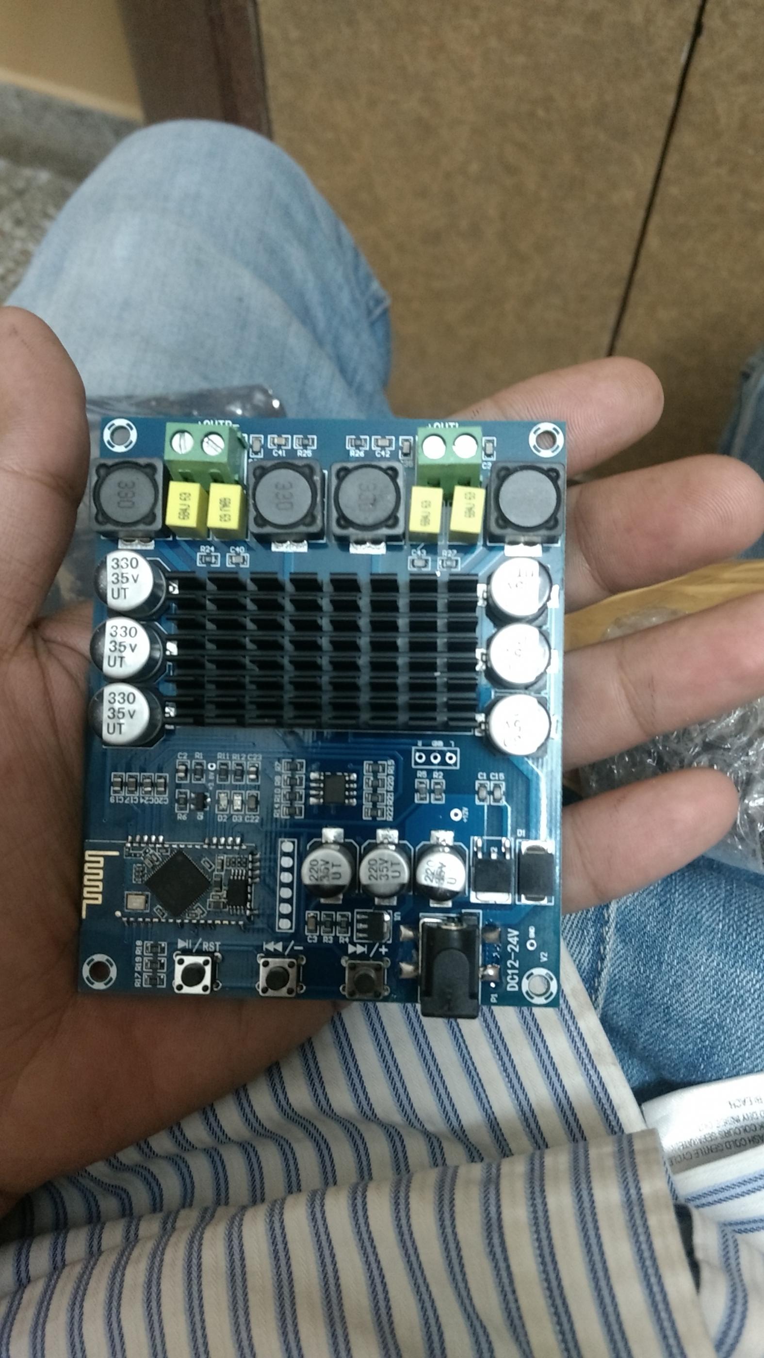

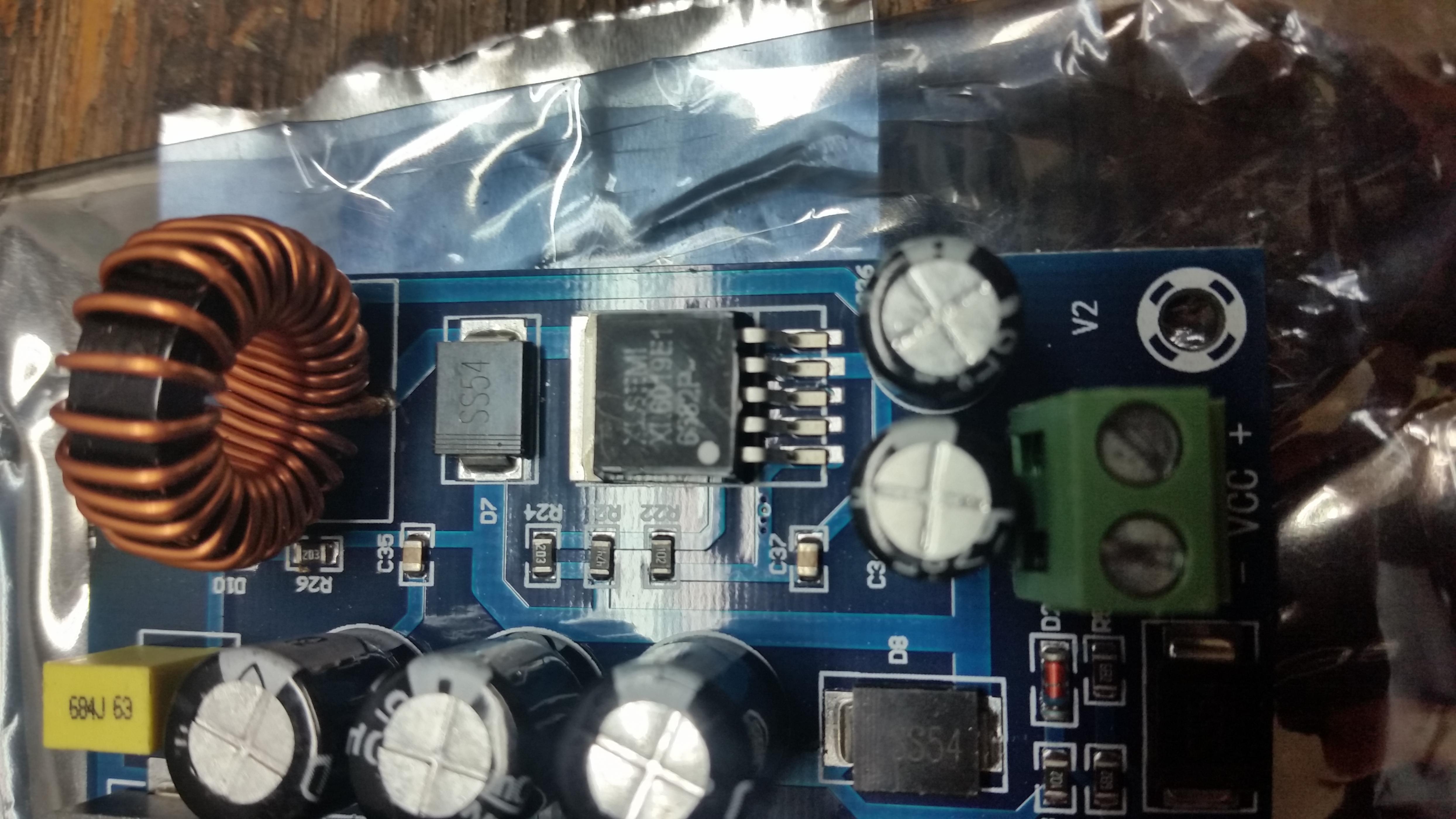

TPA3116 board with integrated dc/dc boost PSU
I have received the board I referenced in the previous post. I can confirm that there is in fact a dc/dc boost circuit built into this TPA3116 board, as I have taken the heatsinks off to check the chipset.
There are twin XL6019E1 on either side of the board as the drivers for the boost circuit.
Twin XL6019E1 - Inverting DC/DC Converter
Datasheet PDF for the XL6019:
XL6019E1 pdf, XL6019E1 description, XL6019E1 datasheets, XL6019E1 view ::: ALLDATASHEET :::
The two XL6019 could theoretically boost 12v to 24v at 5a each, giving this board a max PSU of 24v at 10a. That's a 240w boost power supply I doubt the pathetic heatsinks would support that amount of power though. Haven't had a chance to really test it yet, but I will report back with supply voltage to the TPA3116 as well as wattage out. Again, I doubt you could get 150w out of this board at all, at least without WAY more serious heat dissipation.
Attached are several pictures of the board in question. Always open to ideas and input...

I think you've misread/misunderstood the listing; the power input is recommended to be between 12v and 24v. There is no step-up...
There is indeed a step up, please check my previous post above.

Almost all class D boards I buy (monolithic) are supplied with too little decoupling capacitance (expensive and bulky). Clearly the same apply for the basic-board you show. But, that is not a problem because you can add what is missing of decoupling capacitance just outside of the basic-board power terminals. The little decoupling you have on the basic-board is sufficient to ensure that the chip is not oscillating. The remaining (external) buffer capacitance will fill up your on-board decoupling in microseconds when the voltage starts to drop. So, the worry about sufficient decoupling to ensure good bass can be solved.
The basic-board has obviously got no output filter and you can design your own to be connected at the basic-board output terminals.
I cannot see for sure, but, small ceramic SMD capacitors are probably used for signal coupling at the input. They should be removed/shorted and replaced by foil capacitors located just outside of the basic-board input terminals. So far - so good.
Cooling - here may be a problem: Close to each end of the TPA3116D2 housing are some rather big chip capacitors located. These ceramic chip capacitors seem thicker (measured from the board surface) than the TPA3116D2 housing. Thus, it will be very difficult to mount a heatsink on the cooling pad of the TPA3116D2 housing because you will hit the ceramic capacitors before touching the TPA3116D2 cooling pad. Hence, cooling of this basic-board is a problem. Unless you intend to use the board for low voltage operation (up to 15V), you will need a heat-sink. The designer did not take that issue into account.
Using such methodology you can foresee what you can do with the board from just a photo.
The TPA3116D2 basic-board I bought allows for a heatsink to be mounted. Else, it is probably a very similar quality as the one you show.
You show an Ebay TPA3116D2 mini board. I have a similar TPA3116D2 mini board with a slightly different layout. But, I haven't had time yet to implement and test it.
I believe that such mini boards, or basic-boards as they may be called, are made with the philosophy that we provide you with the chip and the minimum configuration components, produced cheap with robotized SMD technology, and you add whatever you prefer for the more costly parts (output filter, decoupling capacitors, heatsink etc.). Not a bad idea considering that I often replace more of the initial components anyway when I buy a complete amplifier board.

Thanks for your attention. Some answers and some questions:
I'm assuming you were looking at the second board linked which is all SMD. The TPA3116D2 chip has the highest profile on the board so you can fit as large a heatsink on it as you like. An old CPU heatsink seems like a perfect match if I don't mount higher profile film caps on the same side. Will the larger foil capacitance with longer leads you suggest be better than the ones already there? It's hard to say at this point, I'll know more tomorrow after they're delivered.
