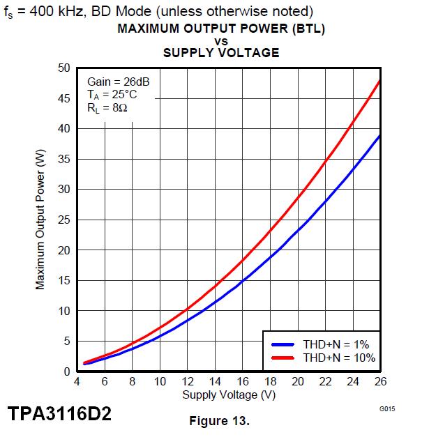

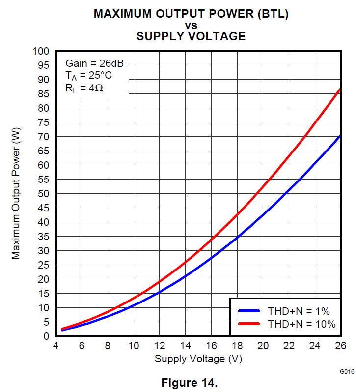

I have been searching through the data sheets and this thread to try and understand the 4r vs 8r output power relationship for the tpa3116d2 implementation. The rating is 50wpc into 4R but would this not halve to 25wpc into 8r which would make it less than the 3118 implementation?
Or will the 3118 only manage a maximum of 30w into both 4r or 8r due to current limitations and effect on chip temperature whereas the external heat sink will allow the 3116 to achieve the higher total power rating.

Because the loading of 8R is less than 4R, the amplifier is able to drive the 8R with more voltage swing,
Therefore slightly more than half of the output power rating at the same distortion level.

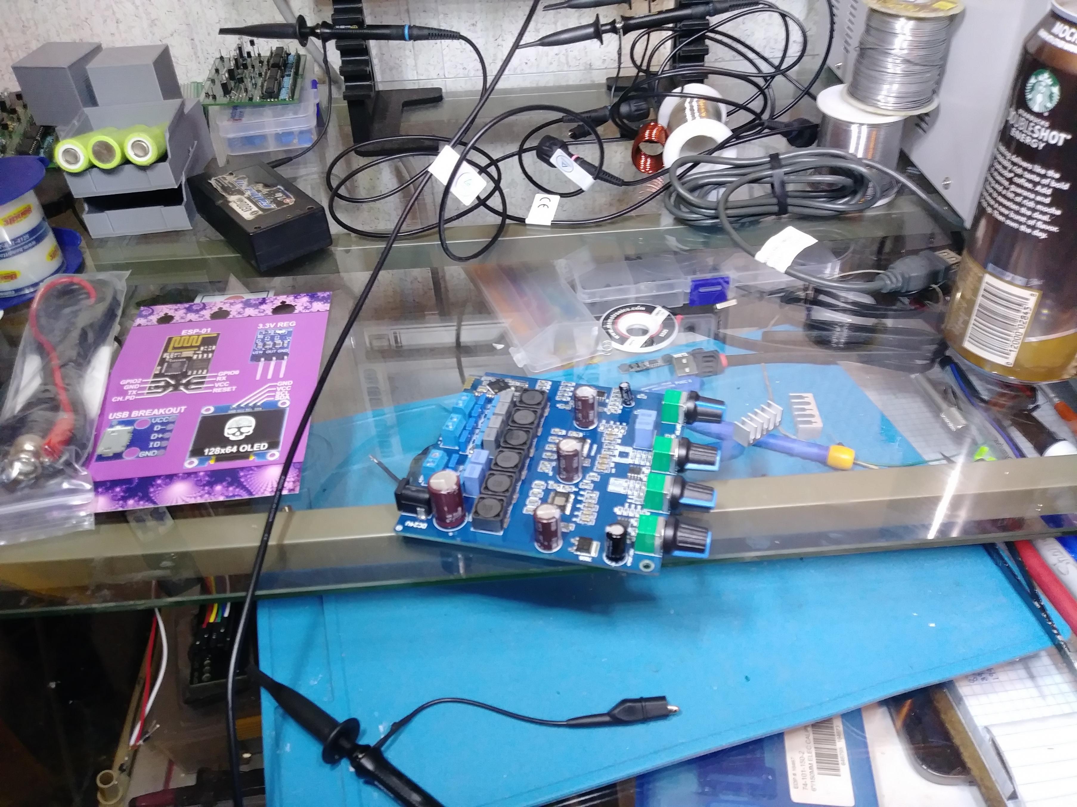

i need some advice:
i ordered this amp here: Aiyima Assembled HIFI digital power amplifier TPA3116D2 2.1 high power board 12 24V subwoofer bass board-in Amplifier from Consumer Electronics on Aliexpress.com | Alibaba Group
but it arrived damaged:
I msged the seller, but he doesn't want to resend. I made a dispute on alie, but the denied it based on the photos
i checked the resitance of the potentiometer, on the solder points and it goes from around 15kohm to 42 kohm on the outside legs. So it seems to be working.
But when i play music i am not able to adjust the bass frequency
So, what can i do? How can i send prove to alie
Desolder and straighten it up, that is what I do, but be very careful, as the solder pads on these cheap boards evaporate very easily. Just run a lead from the pot leg to where the trace ends up if that happens.

Well, to me the voltage swing is pretty much the same.
at 26V the voltage swing is about 26V*0.707 = 18.4Vrms
Rds_on in the output fets is 120mR (ideally at 500mA and 21V) x2 (high/low-side).
So Pout is for 8R:
18.4Vrms*18.4Vrms/(8R+2x0.12R) = 338.5Vrms/8.24R = 41W
Power dissipated at output fets: 2.9%(*) -> 1.2W
Pout at speaker: 41W - 2.9% = 39.8W
(*): 0.24R*41W/8.24R
4R:
18.4Vrms*18.4Vrms/(4R+2x0.12R) = 338.5Vrms/4.24R = 79.8W
Power dissipated at output fets: 5.7% -> 4.55W
Pout at speaker: 79.8W - 5.7% = 75.25W
That pretty much corresponds with the datasheet specs. (But of course) The missing 5W in the 4R plot at 26V is from the increased Rds_on due to internal power dissipation.

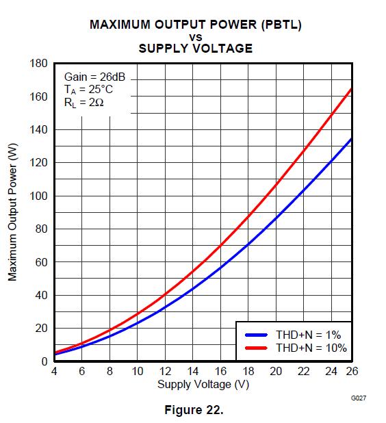

It has only one speaker connection, so presume parallel 2 ohm operation. 150 watts from a 100 watt rated chip? Why the 3 heat sinks? One of the photos shows the heat sinks are not connected. Also 2 large inductors and 2 small ones.
At 24 V, the TPA3116 in PTBL mode will put out 150 W rms into a 2 ohm load at 1.0% THD (direct from the ti datasheet graphs). Officially that exceeds the 100 W thermal limitation of the chip.
However, the thermal limitation is based on a continuous sine wave. Music is never as dense - maybe 1/2 to 1/3 as dense as a sine wave. And the dynamic peaks that would reach 150 W are short lived. The chip / heat sink combination has thermal inertia that can dissipate the peaks before the thermal threshold is reached. And the chip has thermal protection-auto reset for over temperature.
So if you have a 24 V PS and two 4 Ohm subs in parallel, I think the chip can handle it.
Data sheet says it can. (at > 1%thd, 26V and 2R load)
At aprox 88% efficiency That leaves aprox 20.5W of heat.
Junction to case is 1.2 deg C / W
Thermal trip point is 150 C
I guess it depends on the heat sink.
However.
They recommend 12V / 10A or 24V / 5A This is only 120 W input power.
They recommend 4 or 8 ohm speakers So probably not 150W
So at most this amp will do what the data sheet shows.
Can't do more...no magic was mentioned.
