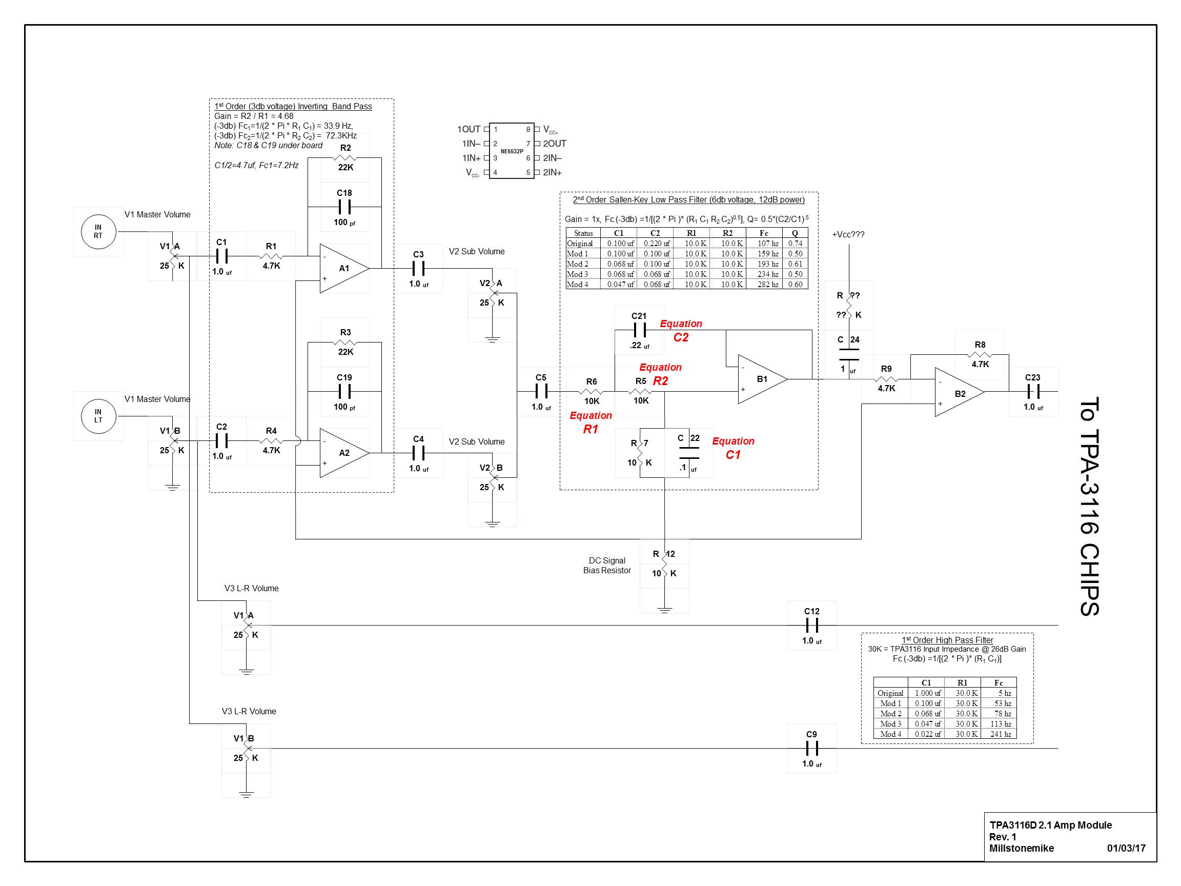

I've got one of these:
TPA3116D2 2x 50W +100W 2.1 Channel Digital Subwoofer Power Amplifier Board | eBay
I suspect that it has the same schematic.
Anyways when powering up I have a horrendous turn on thump. I suspect it is due to R??? and C24 in the schematic you posted.
I modified my board by placing a 4.7uF cap between MUTE and GVDD. This alleviates some of the turn on thump, but does nothing for the turn off.
Anyways, do you, or anyone, know what the purpose of C24 is in that schematic?
Also, I used Arctic Silver (a thermal paste meant for CPUs) on the thermal pads with good success. But honestly these amps are so efficient I have yet, even without the paste, to drive them into thermal shutdown. And I'm running 6 Li-Ions in series for a 24V supply, into a 2 ohm sub (and 8 ohm speakers) so not the lightest of loads. Anyways I'm quite impressed by these Chinese Ebay boards, if only they didn't have that horrible turn on pop. So hopefully someone on here has already figured this out. (why re-invent the wheel I figure)
Thanks,
-Judtoff.
EDIT
I should be clear. The turn on thump is almost completely eliminated by removing both OP-Amps from their sockets. The thump is definitely due to the on board pre-amp etc. What I'm talking about it more than the typical TPA3116 turn on pop. Cheers,
