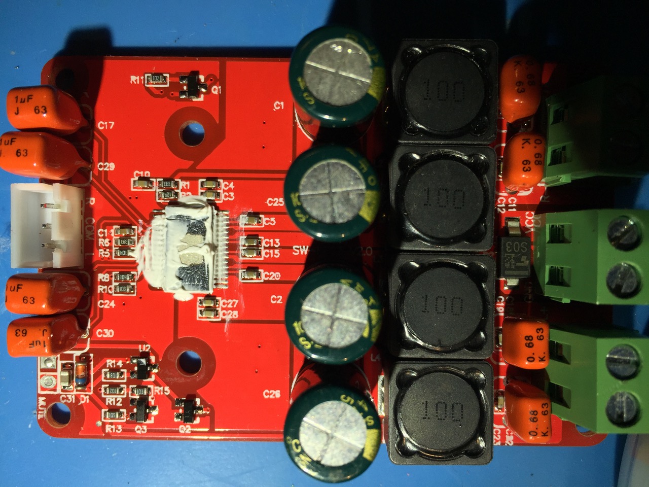

In case anyone is interested, this is what it looks like under the heatsink of the Sanwu TPA3116 board. No bootstrap snubber hiding under there.
Does anybody know what transistors (???) Q1, Q2, Q3 and IC (???) U2 in the picture are for?
Are they for a delayed start (anti-bump) ?
