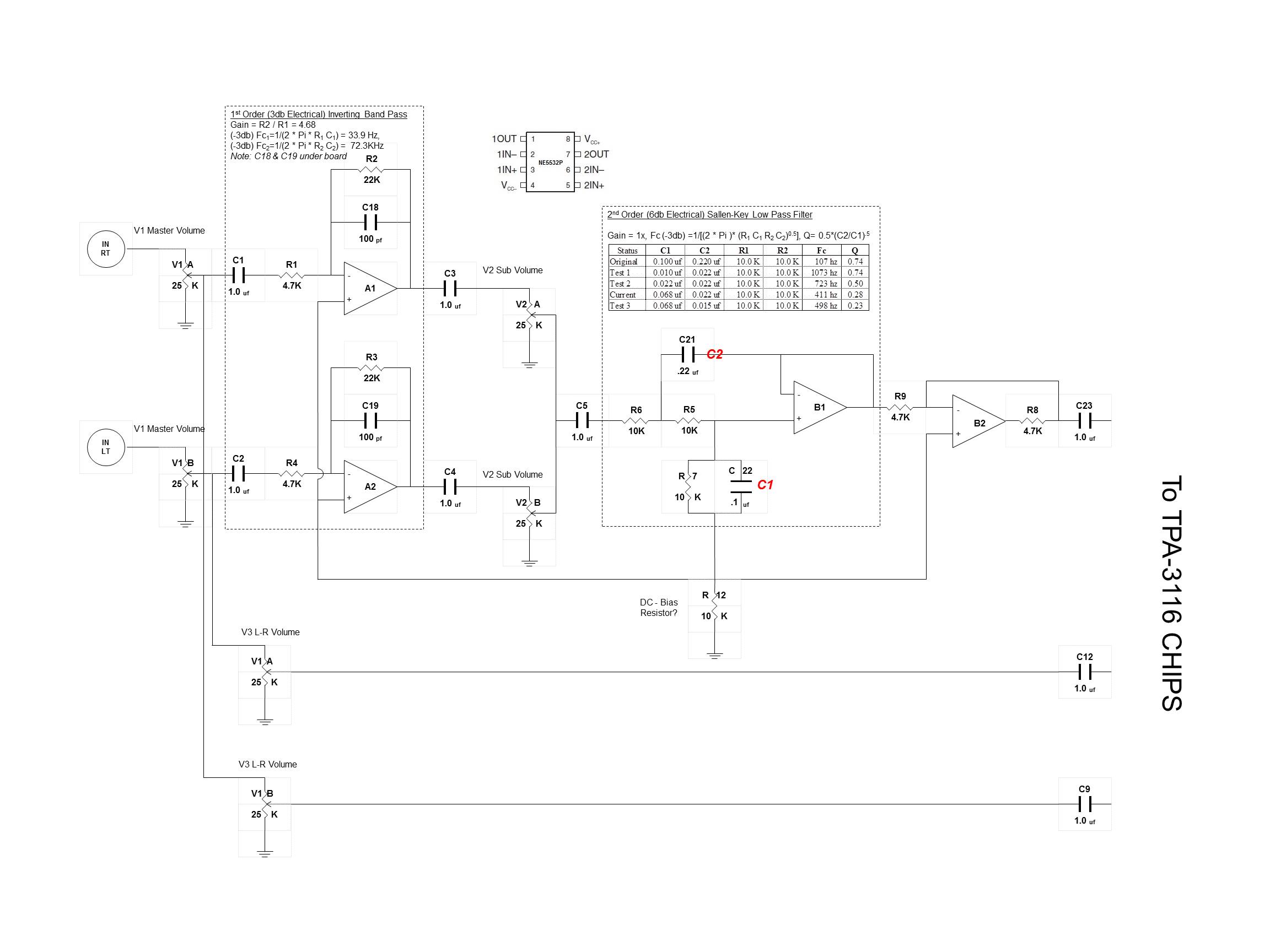

I have one of these. Changed those 1uf to 10uf (don't forget those in sub filter output - this board has original better frequency response in stereo than in sub channel because if these caps! ! ! ).
Will change frequency cutoff to 80Hz.
Don't forget these boards have both ICs in master mode. One must be changed to slave to avoid a nasty ground noise they have.

I'm using the existing HP on the sub channel to control excursion on my sub woofer in my 2.1 boombox system. But I may change out the caps to see how well the woofer does.
I've only looked at the signal paths, not the actual chip implementation. Do you have any instructions, etc. for chaning the ".1" chip to slave mode?
