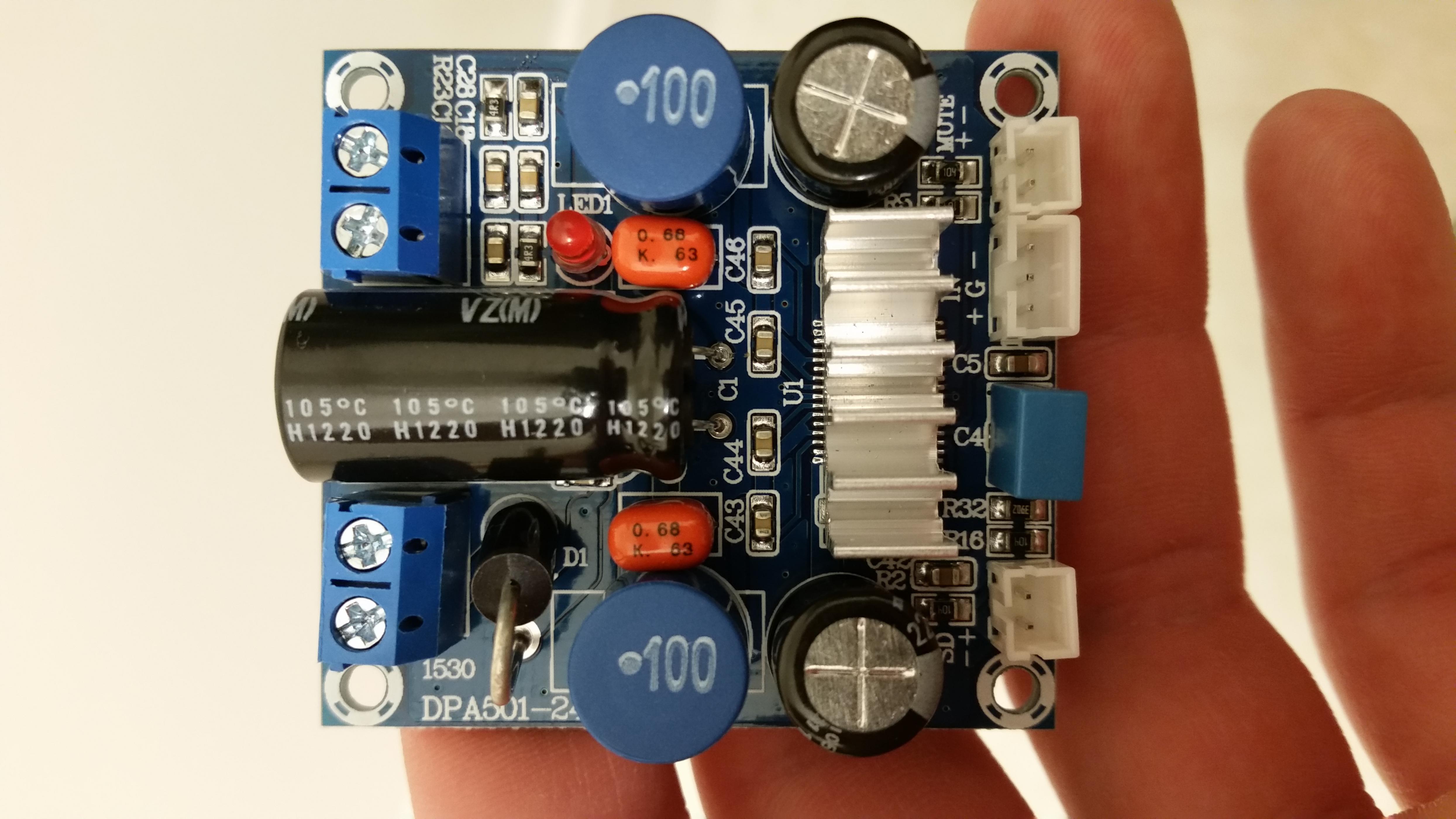

Got a nice box from China today. First impressions of the mono PBTL board are very good. I got mine from seller "kiss_buy" and it appears to have genuine nichicon caps (or at least heat shrink that says nichicon on it). The stock gain setting seem very low, so far I have only tested with my phone as an output device, but at max volume it is much quieter than my other 3116 amps using the same setup.
Overall sound is very clean, I need to put them in a real setup that isn't dangling by wires to do a true comparison, but I would say at least as good as the dual chip board, probably as good as the sanwu 3118. Right now I am running with 8-ohm Polk TSX110B speakers, so I wouldn't see a power boost anyway.
Anyone know the best way to remove the white heat sink glue so I can get a shot under the sink without pulling the chip with it? I think the only thing hiding under there are 2 little ceramic caps, but a nice high res photo so people smarter than me can reverse engineer it would probably be good.

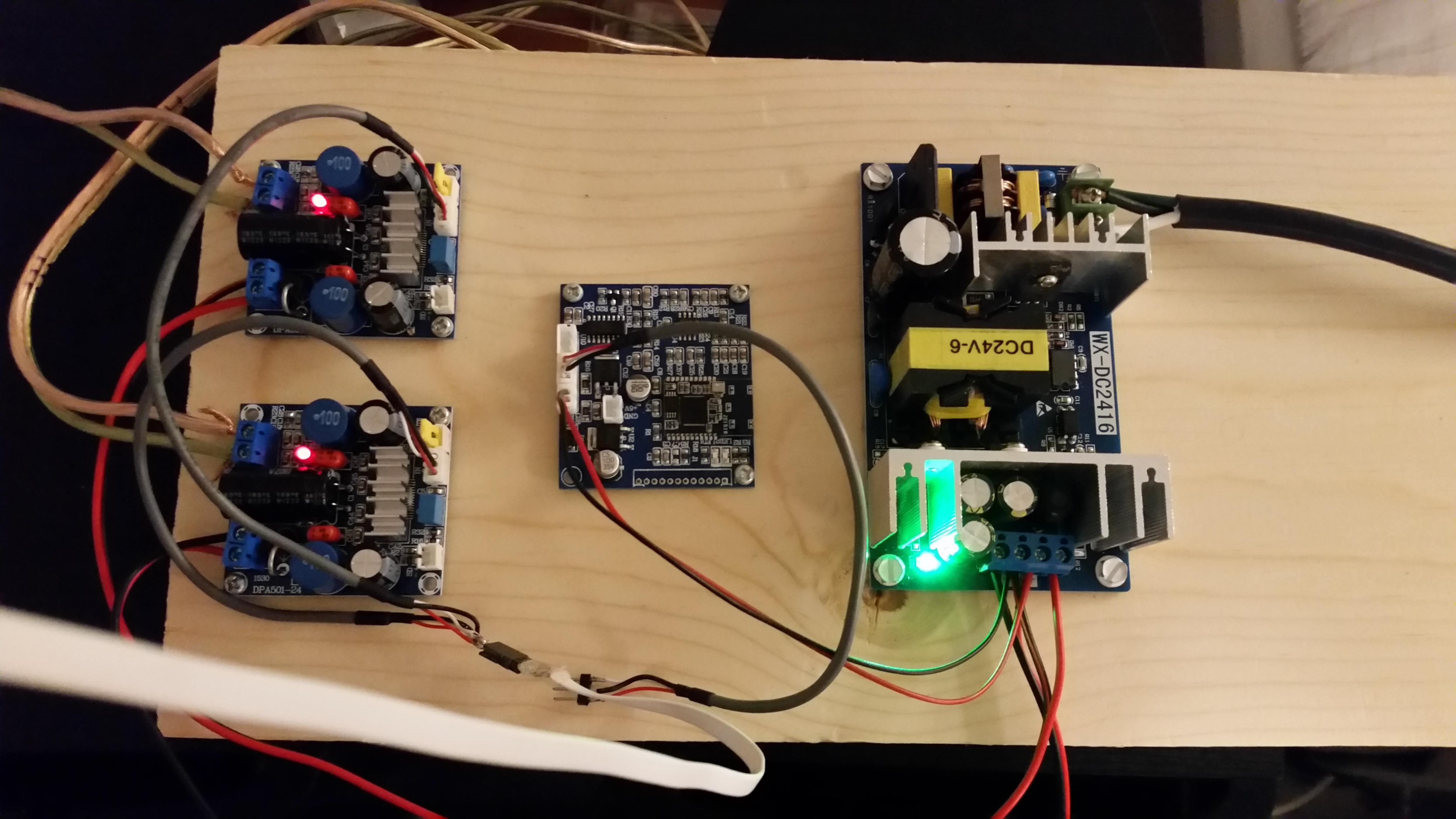

I also like the little smps boards I got with them, 24V, 6A cont. 9A max. Can't recommend the bluetooth module yet as when it plays music there is horrible interference which I need to work out. It's the type of sound you get when you put a cell phone near unshielded signal input lines, only it is constant while the music is streaming.
This is mainly due to the BT chip is disabling its outputs when not streaming. Seems to be a common problem. You may want to try to remove the one ground wire going to the psu, it's then grounded via the amp only. You actually build a nice GND-antenna.
Next, I'd link the amps ground planes together at their mounting holes (If they're ground-connected) and remove the ground-wire of the top amp.
The mounting holes are not grounded, but I will link them up locally between boards with a nice fat wire. They are linked also by the signal ground pin and the signal minus pins (again ground, just another attachment point).
Thanks for the tip on the BT board, I will try that. If that fails, I will see if I can build some shielding onto the board with a makeshift metal can or something. The bluetooth board was just thrown on the order for fun though because I hadn't tried this one. So it is low priority.
This is nowhere near the final setup either. I plan to use the Sanwu 3118 board to run the full range 8-ohm speakers, and the 3116 boards will run a 4-ohm woofer. Each 3116 + 3118 pair will have its own SMPS, and be located within the speaker tower, essentially creating powered speakers.
Lies! I am obviously trying to pick up and listen in on the Voyager space craft. Ideally I think a big copper bus wire for the ground, bridging all the ground pins between both boards in a single run would be the way to go. I may do something like that between the 3116 and 3118 boards in the final setup.
