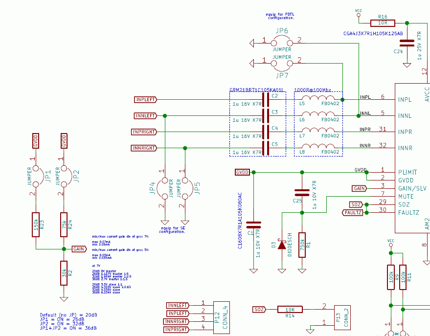

Hello folks, I'm new here. I was inspired by chicks chromecast audio build and I was looking to do something similar. My gf has been taken by all the Sonos commercials, and I would like to build a few "single wire" bookshelf speakers. I dont see the point in doing stereo pairs for whole home audio (one in the bathroom, kitchen, etc). I figured a tpa3116 in PBTL mono mode makes sense.
So I was wondering if anyone has any experience with the board I ordered. I found this guide, but it doesn't seem to be applicable. There are 6 jumpers on the back you can reconfigure for PBTL mode... is it really as simple as that, and then bridging the outputs?
Here is the Amazon listing, and a very similar board which has a good photo of the back of the pcb.
I went with this board because I hope to have at least one built by Christmas 🙂
The version you linked is an updated earlier ampboard that was sold as SMAKN on Amazon, now with added "bootstrap" snubbers. Yes PBTL is easy, yes lowering gain to 26dB is also easy.

Sure i did, and i still don't see a relationship between dc-offset and the RC-filter.
The 10R+1u is from an older TI chip implementation - there's none for the 3132 in the datasteet but several ppl complained about noise without in the E2E forums for their 3116/3118. 10R+1u has kinda low/none influence on dc-offset.
700mV DC offset.. would mean, the AVCC is sagging and pulling some 35-70mA to have this drop on 10R.

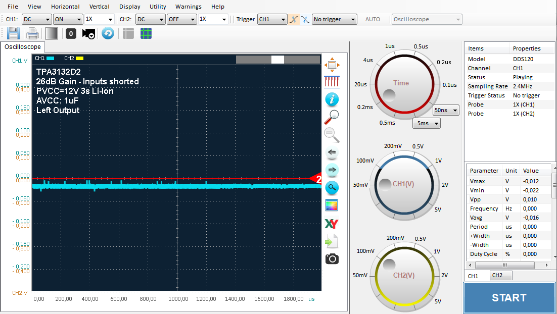

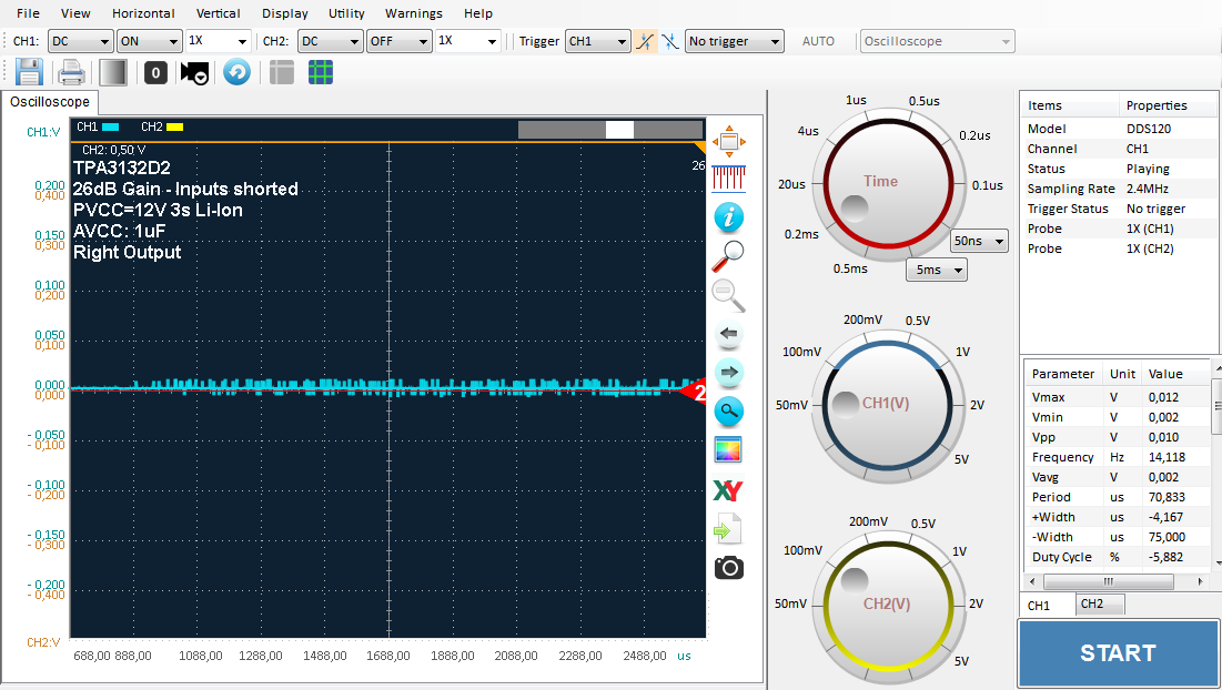

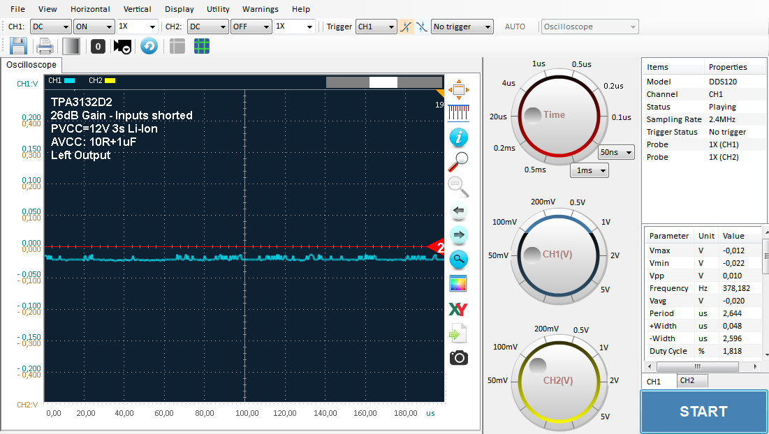

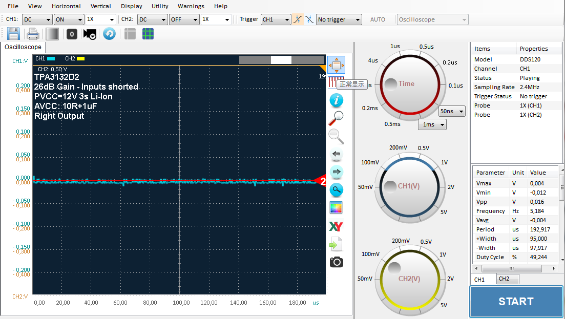

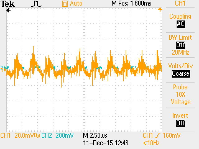

For further discussion i measured the DC-offset of my TPA3132D2 implementation.
Parameter:
TPA3132D2 board Rev 0.C
Li-Ion 12V 3s battery pack at 12.51V
DDS120/BM102 USB Scope
60Mhz probe
Analog inputs grounded
Gain at 26dB
400kHz switching frequency
No load connected
No bootstrap snubbers
no filter at all (straight out)
10R+1uF AVCC filter vs. 1uF only
DC-offset on left channel is about 20mV, right channel is about 3mV. Offset is not altered when R is bridged (zero ohm) but noise increases.
RC-Filter Left Channel:
RC-Filter Right Channel:
C-Only Left Channel:
C-Only Right Channel:
Conclusion:
On this board, DC-offset is not affected by AVCC-RC-Filter, but output noise is slighty improved compared to no filter.

TPA3132D2_DC_Offset_with_AVCC-RC-Filter_Left_Channel.png98.9 KB · Views: 494
TPA3132D2_DC_Offset_with_AVCC-RC-Filter_Right_Channel.png.png104.9 KB · Views: 494
