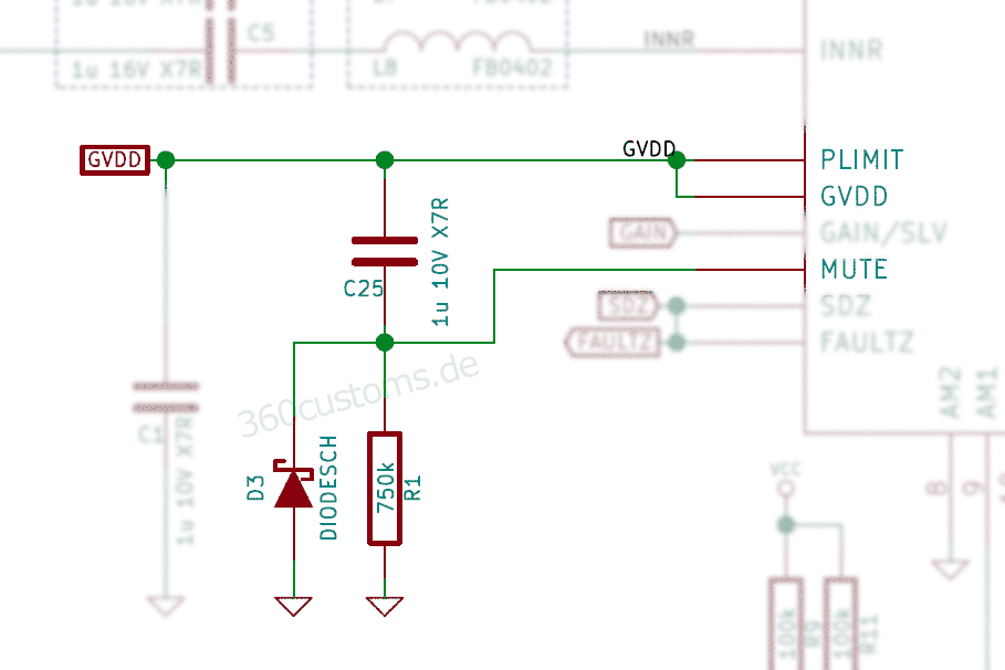

From the data sheet, page 15:
"The tolerance of the input resistor value is ±20%..."
Would you use a 20% tolerance resistor in a HPF?
For turn on pop there is giancarlo's addition, what remains is turn off pop
To fix both problems, go for this circuit:
attachment.php
Source
It also has the advantage of having a PVCC independent time-constant.
