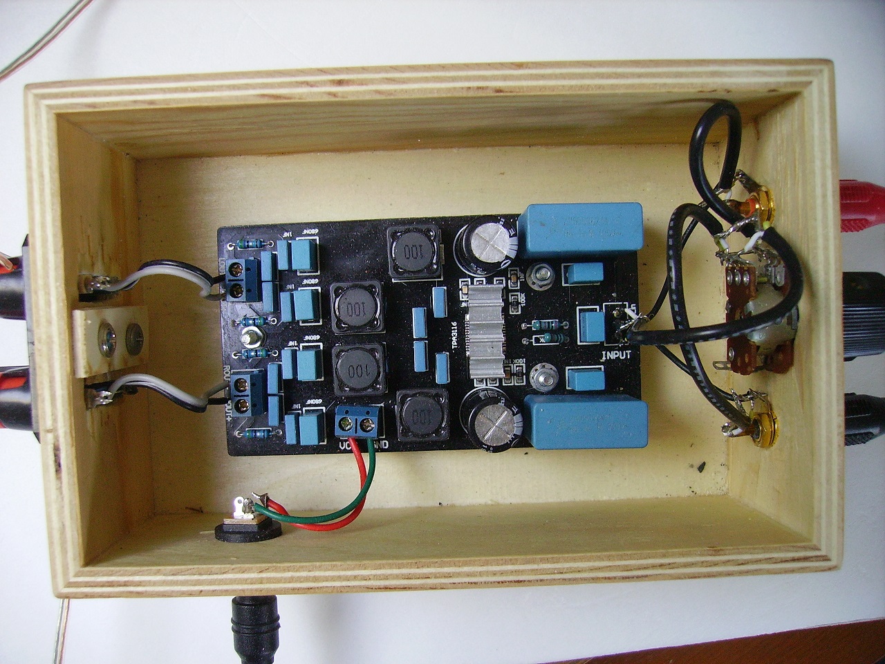

Photo attached, it IS stock really doesn't show much .. I think.
Also evident that I had fitted an NOS Japan made Alps 100k pot to this one not the blue box one 😱
Currently stuff the PS brick into a stamped tin cookie can.. helps the RF noticeably, but not completely.
Speakers are Mark Audio full rangers and Tannoy GRF's (briefly)
Sadly 'Decoupling caps' is undecipherable to me.. Where/how? if you have the patience .. please??
Source, as in the CD player I've been using with it might be a suspect, a good point actually.. will explore that.

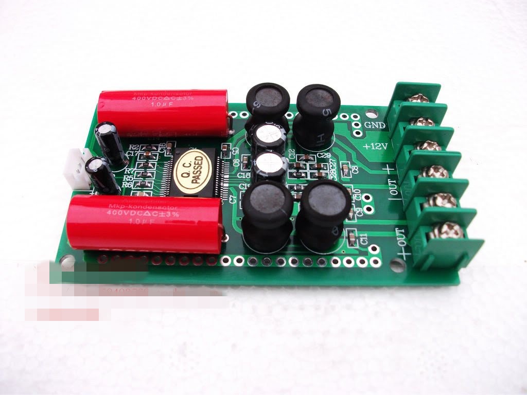

Attach a wire from board ground to the case (metal part) of the pot.
These amps can pick up a bit of noise if the input is not low impedance.
Ceramic caps on YJ BB for psu decoupling. TI has a maximum distances layout example for same power and same die according to TI support forum. They suggest 100nF and 1uF for that chip and maximum distance for the 100nF parts is 2mm from chippins. In this thread you can find scopepictures ripple supply lines I remember, that poster had YJ BB and only got rid of/reduced ripple by using two 1uF's on each side, I mentioned 100nF and 10uF each side seems to work for me, 100nF and 2uF might also work. But you start with first ceramic < 2mm close to chippins. 100nF=104. Picture is YJ BB, not "official version" copy that isn't sold by YJ. YJ isn't quality reference, but pcbtraces differ between the two lookalikes.
The 100nF are mainly there for EMI reasons to keep the HF switching noise in a small loop within the chip area. The 3132 is using 10nF here but, if your layout is tight, are optional. Haven't seen a rise in radiated HF nor did they changed be noise profile if left off.

Uhhh Guys! Just Now fitted my old YJ Ta2020 amp where the YJ 3116 was.
NO (Zero/Nada) changes except for the Amp board gizmo.
Ta 2020 is WAYYY better sounding.
More Bass, Lovely Sweet Highs (none of the harsh tizzy highs from the 3116 board)
ALSO NO Turn on unpleasant 'Scooortch' noises and NO RF noises.. (audible in the 3116 gizmo, both with CD turned off or on).
Sorry People.... But from this simple stoopid comparison.
The Ta2020 is the Unquestionably Superior contraption.

Applying the cold logic of a decent night's sleep..I redid the A/B test yet again.. moments ago.
Results seemed as even more striking than last nights.
Major audible differences; ta2020 one is Much more listenable, (poor descriptor Pleasant sounding may be a better one?) with deeper more solid dynamics/bass,
Sweet clear highs
Plus the Bonus benefits of: No power up noises.. None!
No Rf noises... it's dead silent.. period.
The 3116 board sounds quite Harsh and Tinny.. unpleasant.. in direct comparison.. No other descriptor seems as succinct /accurate.
Bit of a surprise actually, I guess I had adapted to it's sound signature.
Ta board is notably down on pure DB power though, If that matters.

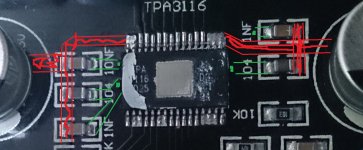

LOL you need to solder, don't replace capacitors, just move them closer to chip🙂 gvdd decoupling next to inputsocket is totally useless, ~20mm closer to chip you already have pcb hole left by resistor you removed, other leg you just solder on neighbouring resistor, you need to do something befor you trash YJ BB 🙂
Ya, those TA2020/TA2024 aren't that bad, even the cheapest chinese boards.

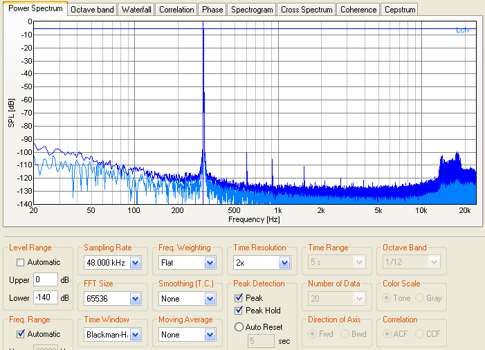

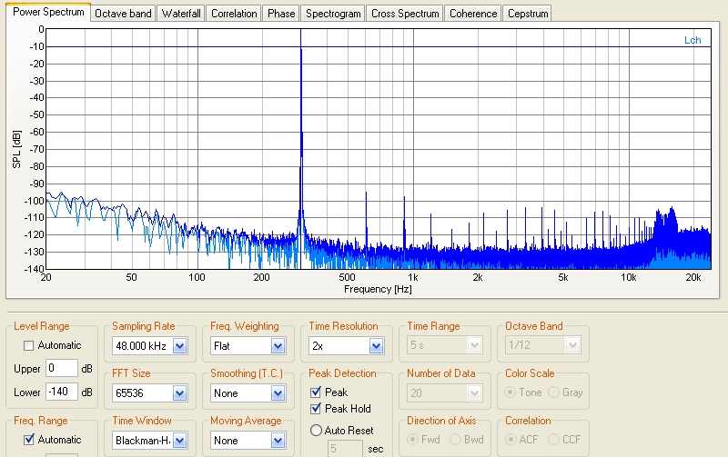

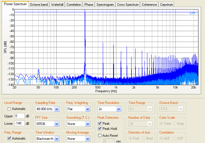

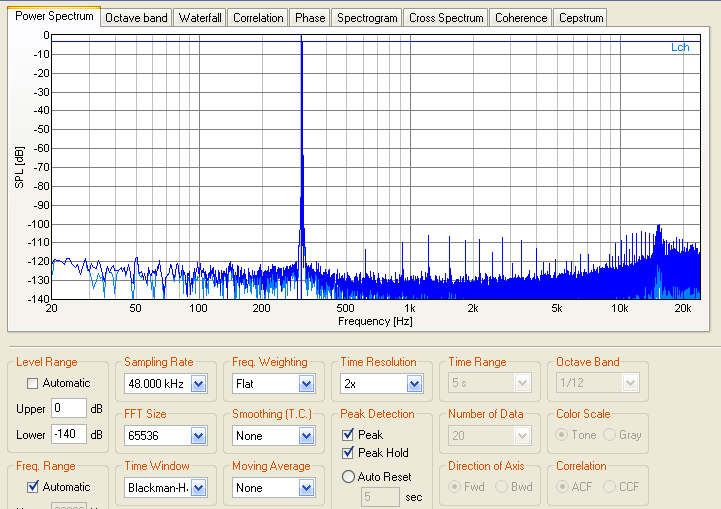

Measured without load:
MAX9709 filterless SSM (spread-spectrum-mode):
TPA3132D2 filterless:
TA2024 with filter (Delta-Sigma-Modulator at ~900kHz):
TA2024 1W 8R load:
TA2024 is this one:
TA2024 1W 8R load:
TA2024 is this one:
