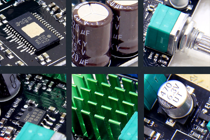

Hello. I have finished reading through all this huge topic because I have been advised that the TPA3116 might be the best or one of the best class d amps now available. The fact that is also cheap doesnt hurt also.
There are a few implementations I have seen on Aliexpress that were not presented here. I can see why, in my little knowledge, they seem to lack output filter, but still, what are your opinions on them?
TPA3116D2 2.0 CH Class D 50W+50W High Power Stereo Digital Amplifier Board 50W*2-in Amplifier from Consumer Electronics on Aliexpress.com | Alibaba Group
mini amplifier tpa3116d2 100w 2.0 stereo dual channel high power digital amplifier board-in Amplifier from Consumer Electronics on Aliexpress.com | Alibaba Group
I am curious as I would like a small amp but with some tone controls. If they are not ok, I will probably settle for this one, with or without separate tone controls:
TPA3116D2 Class D Digital Amplifier Board 2x50W Dual Channe Stereo 12v 24V car-in Amplifier from Consumer Electronics on Aliexpress.com | Alibaba Group
It will be in use with a MarkAudio CHR-70a pair. Thanks

The "filterless" modules have ferrite-bead filter equipped. From my measurements, if these components are choosen well, there's no problem - EMI wise.
Measurements, for a similar device are shown here:
Tpa3132d2 vs. MAX9709 Messungen EMI/EMV | #360customs
Ok, EMI-wise. But it affects sound quality in any way? I mean is it a ok implementation or lower quality, as far as you can see from the pictures? Thanks
I use the TPA3132D2 filter less without any issues (It's basically a 3116 in a different package). I don't see any quality issues (with the parts I used) nor does it affects the sound if the speakers provide enough inductance. If you are planning to run small speakers or just tweeters with it, there might be some thermal issues as the drivers gets heated up due to the HF. I can't speak for the boards shown at AliExpress. They might be okay or they are from the same "quality" as the other Chinese boards around.
The ferrites on the first link look a bit small, I use 1206 Murata parts here, they fit the needs even for "high power". Those in the second link looks a bit bigger footprint. At moderate levels the system should work good, those 220uF caps "might" be a bit undersized if you go for high levels and <=4R load resistance.
I'd give the second one a try. 🙂
(Update options are the ferrites and the bulk caps, but only if needed for high SPL)
