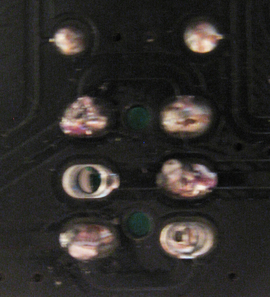

What DAC is this? Where did you get it from?I am planning on putting this amp and dac in the same box but I'm not sure which terminals on the 3.5 to use for L R G on the amp.
Suggestions please so I don't blow up anything 🙂

I have taken a closer look at the pins on the dac output and found that the one I identified as 0 is not used. It is trimmed off the jack. So I'm not sure which pins to use.
B (earth) goes to 4or5. If you mix up the other two you only mix up right/left side so no biggy... But 0->L and 3->R. I have actully tried that dac and it sounds decent!

Prezden, to me it looks like the pins is connected together with traces on the pcb. I suggest that you just hook it up like I said 🙂 You can also wiki the 3.5mm jack to learn about that connector.
