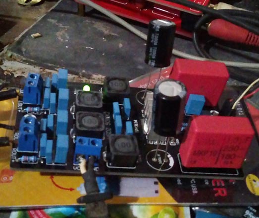

I've replaced 10uH with 22uH (Coilcrafts), and DC power caps with Elko 1000µF/35V BC on YJ board a year ago, or soon as I've noticed this issue!
I have replace dc caps on yj blue black with Rubycon ZL 680uf/35v and input caps with wima mkp 10uf, Sound improve so much and I want to replace dc cap on sure TPA 3116.
Is easy to remove original DC caps on sure 3116 like removing DC caps on YJ blue board ?
The Sures are a little harder to work on replacing the caps. It took a lot of patience and a conical cone solder tip to remove the solder in the small holes. My solder sucker did not work well, nor did the desolder copper braids.

FYI, regarding through hole cap swaps: I've never had any luck with a solder sucker. I've had some success with solder wicking braid.
But I've had 100% success using a "pin vise" and tiny drill bits to clean out the holes after pulling the cap. Heat one lead of the cap, and tilt the cap as much as possible. Repeat with the other lead. Might have to go back and forth multiple times, but it's pretty easy. Then use the hand-powered drill to clean out any left over solder.
On those cheap boards, I find I generally want to get rid of as much stock solder anyway, as mine is much easier to work with.

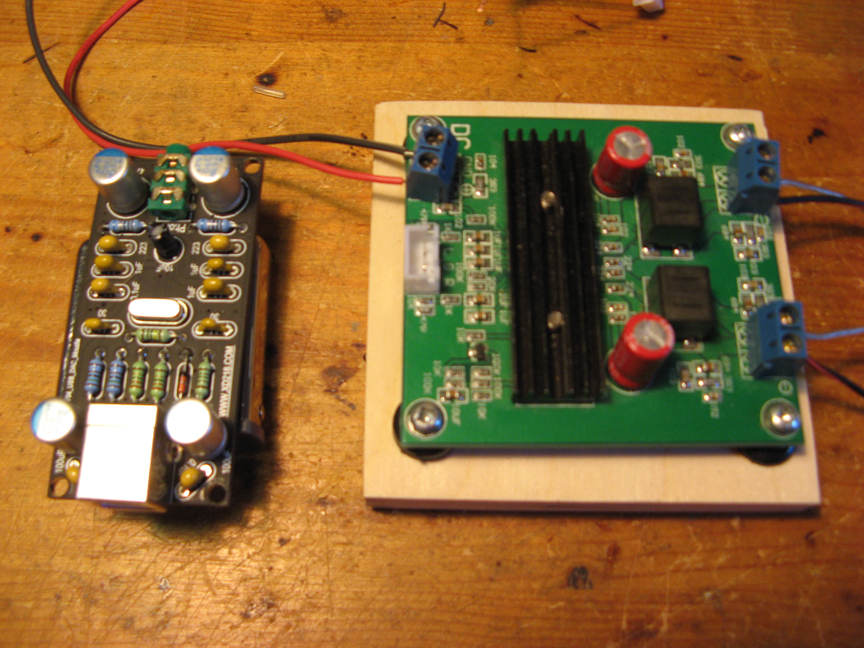

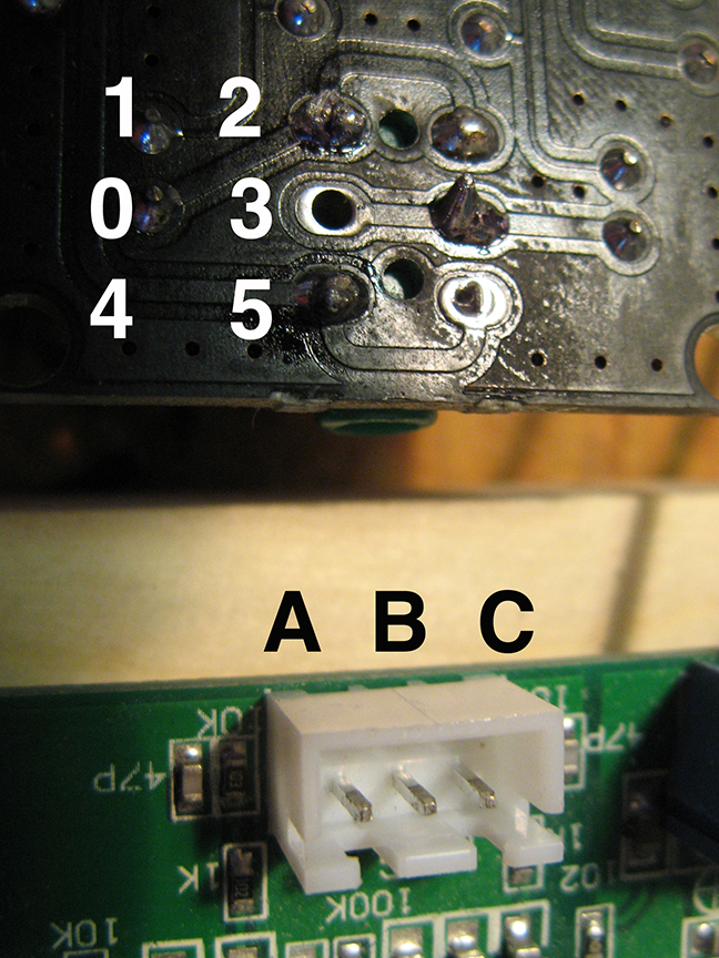

I am planning on putting this amp and dac in the same box but I'm not sure which terminals on the 3.5 to use for L R G on the amp.
Suggestions please so I don't blow up anything 🙂
