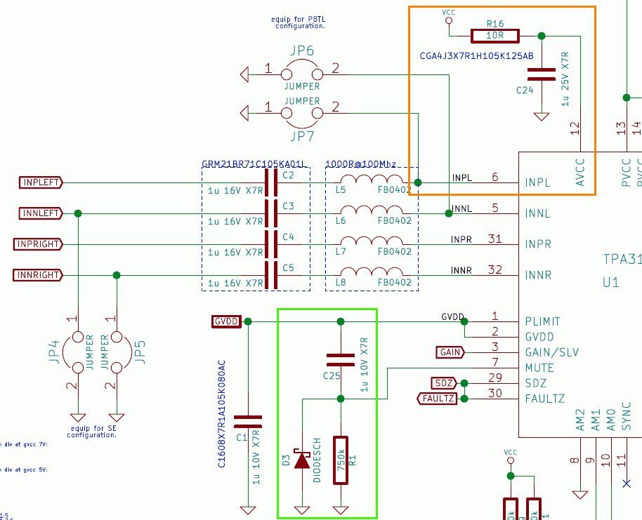

Is the 10R+1uF in series with Avcc rail between Vcc and Avcc or Avcc to GND? That is a simple cheap mod for sure, I have never tried it but notice that the 3116 has hiss at zero input when I put my ear to speaker.
Have a look into:
attachment.php
Orange: AVCC decoupling
Green: PVCC independent antipop time-constant (about 1 second)

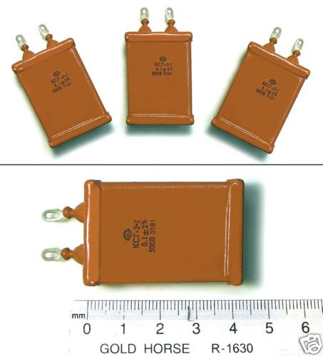

Its more the type, don't rate x7r caps much, and lower classes even more so. Was considering mica, tantalum or possibly an oscon SEPC.

Your boards have 1uF MKT filmcapacitor on GVDD, c15, don't they???, somehow it seems you are talking about another capacitor ???
Dont know if MKT, crazy I didn't notice that. They are same as the two small blue "neg" side input caps! I am talking about c15 though. I have checked the trace lines going through resistors to it from IC.

In that location the caps need to be low ESL, stable capacitance over freq & temp. ESR not a huge issue here.
From the research I've done into it from various sources the cap in this situation is usually recommended ceramic (high class), and many use mica if values allow.
I don't see why an SEPC wouldn't go nicely either. Clearly the answer to my original question is "no". 🙂
