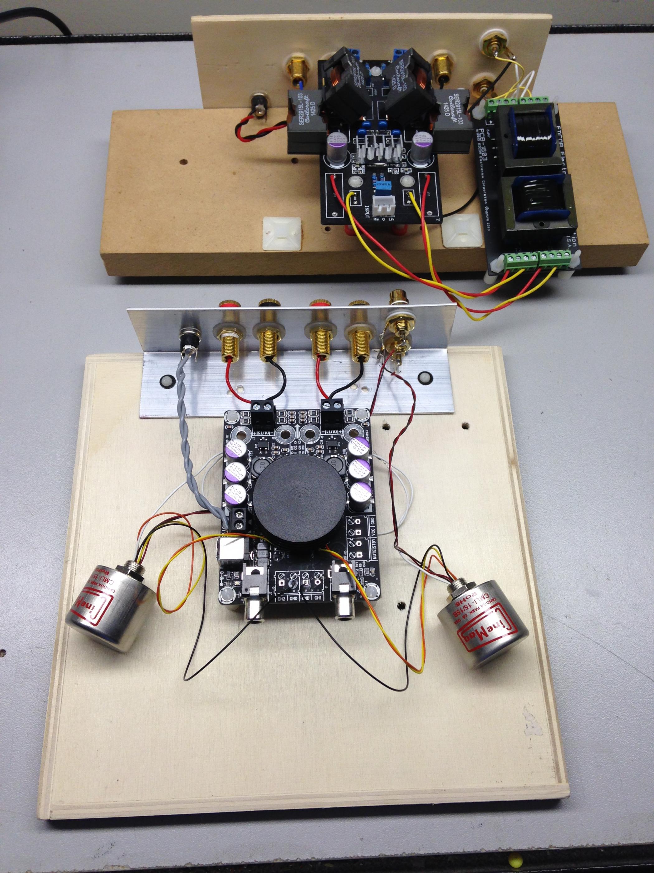

Follow-Up on Edcor TTPC15k/15k Input Transformers
After a busy January traveling on business, I finally got around to swapping input transformers on my two modified TPA3116 amplifiers.
I had loaned my TPA3116 amps to a friend prior to swapping the input transformers. My friend clearly liked the modified YJ blue amp with the CineMag CMLI-15/15B transformers over the modified Sure TPA3116 with the Edcor TTPC15k/15k transformers. It sounded cleaner and more detailed on the top, and it had a bit more low end definition.
We compared this to his modified YJ blue which was identical to mine with the exception that my amp had the CineMag transformers and his had the stock Epcos film box caps. In this comparison, the modified YJ blue amp with the CineMag transformers was the clear winner. The soundstage was more three dimensional, the tonality was more balanced and natural-sounding, and the imaging was more clear and focused.
Now comparing the modified YJ blue amp with the Edcor TTPC15k/15k transformers vs. the modified Sure TPA3116 with CineMag CMLI-15/15B transformers is a different matter. These amps almost sound identical. I'll have to do more critical listening.
In any case, using good input balancing transformers significantly improves the sound of these TPA31xx amps. The amp becomes more transparent and revealing of what's in front of it. This is very apparent when switching from my Sony ES DVD/CD/SACD player to my turntable and Audio Research phono stage. For some people who don't want to spend the money on higher end transformers like CineMags, Jensens, or Lundahls, these Edcor transformers do a very respectable job in taking the TPA3116 amps to another level of performance. A big benefit of using the input transformers is eliminating the turn-on and turn-off pop. I only hear a faint tick when I switch my Astron power supply off.
Thanks again to matt_garman for lending his Edcor transformers for the comparison.
