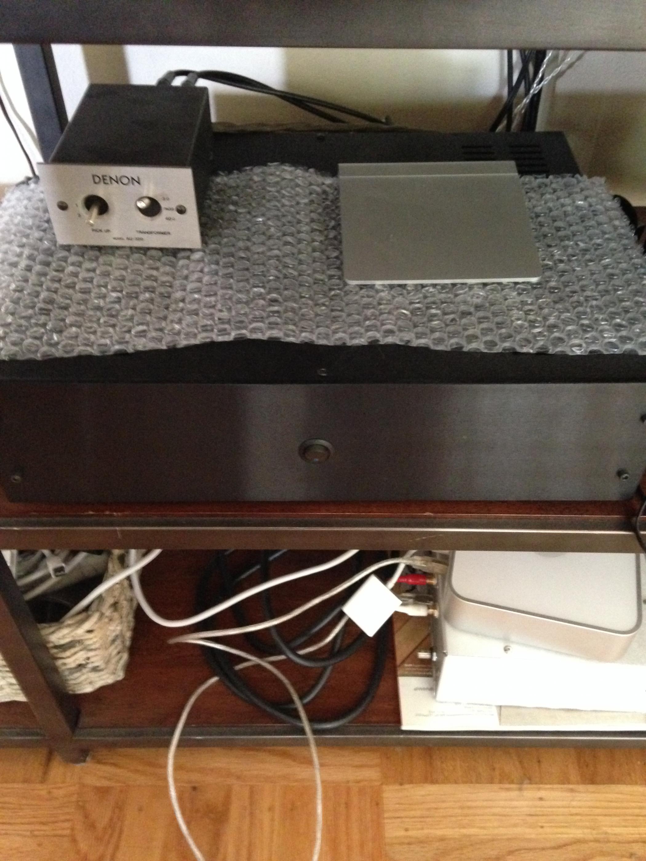

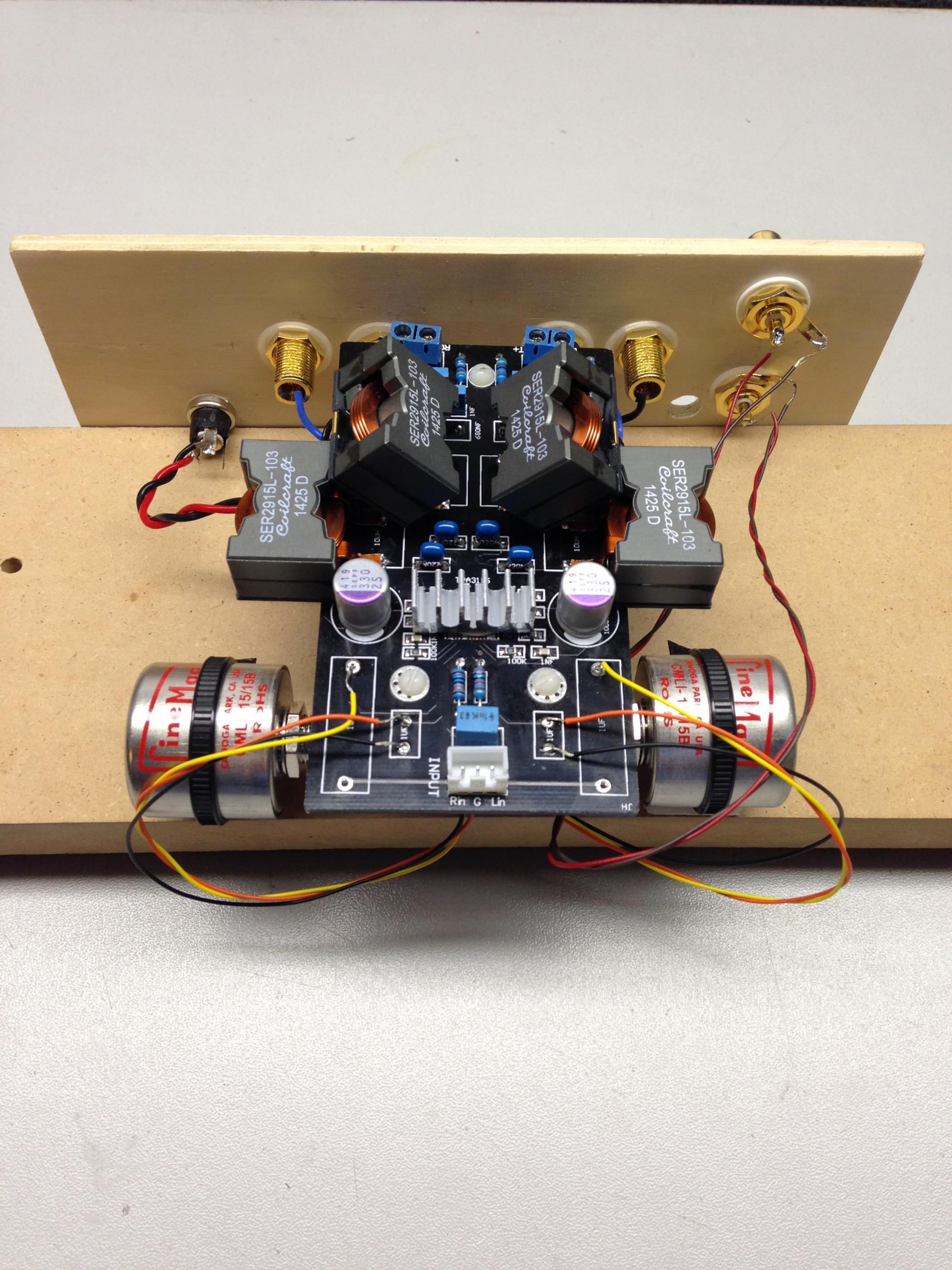

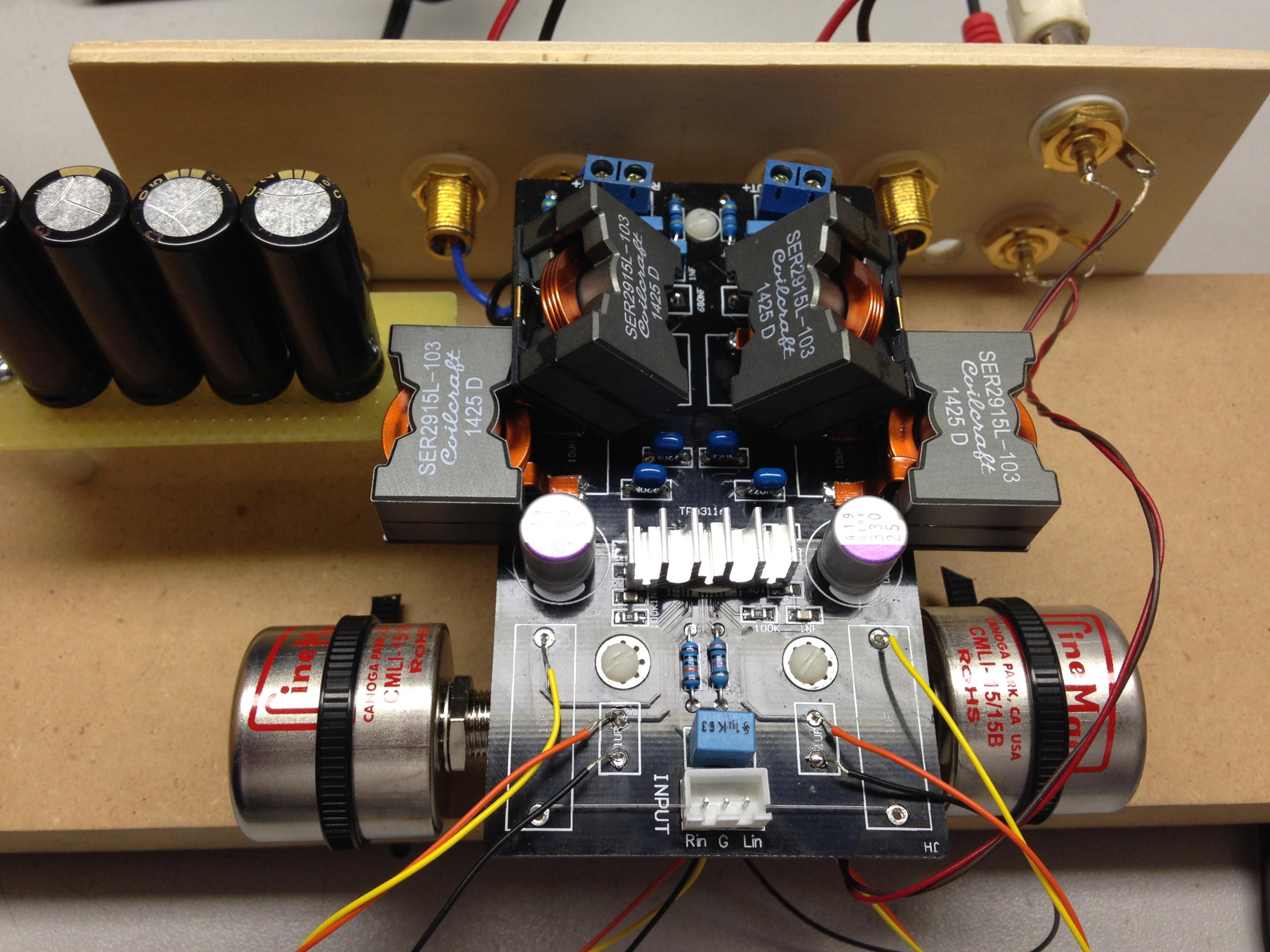

I just modded my Danzz board with the snubber mod and Panasonic OSCONS (inductors are coming) and was very pleased with the sound. Then, I saw an Astron RS-20A on CL today for $50 and picked it up. I just plugged it in and OMG: the best sound I have ever heard coming from my speakers! The bass was just pounding me in the chest and the details are just crazy stupid.
But here's the rub: there is a hum coming out of the right speaker (and the Astron is also buzzing a bit when I put my ear up to the unit). What's going on here? I switched power supplies to a laptop brick and it was dead quiet. I hooked up the Astron to my Sure TPA 3110 in my garage and couldn't hear the hum. This is weird. Is it a grounding issue?

How close is your amp to the Astron? Big transformers have big stray fields, so you may need some distance. Does the Astron also buzz without a load? Transformer mechanical buzz is not uncommon (generically speaking, nothing to do with Astron per se).

It was about three feet. The Astron buzzes without a load. I thought it wasn't a good idea to have long power cables to the amp. Maybe I got that wrong. I will try moving it around.
3ft is more than enough to avoid stray fields - I was just making sure it wasn't stacked directly on top of the Astron. Make sure your RCAs are also not up against the PS transformer. To help isolate speaker hum origins you can short the RCA inputs and listen for it again. Is your hum-less brick a 2-prong type?
Thanks for your help. I really do appreciate it. The hum-less brick is three-prong; the same as the Astron. Now that I am thinking about it, I should have mentioned the board has not been housed yet. Could that be part of the problem? The Sure board I tested without hum is housed in an aluminum Hammond chassis. But why just the right channel?
I don't have enough experience with the TPA amps to predict if casing it up might help. For quick and dirty tests I'd short the inputs first to exclude your source components, then if you're comfortable with the safety implications temporarily lift the ground on the Astron to see if it makes a difference in the hum. Only one channel could be your input/pot wiring, recent modifications, etc.

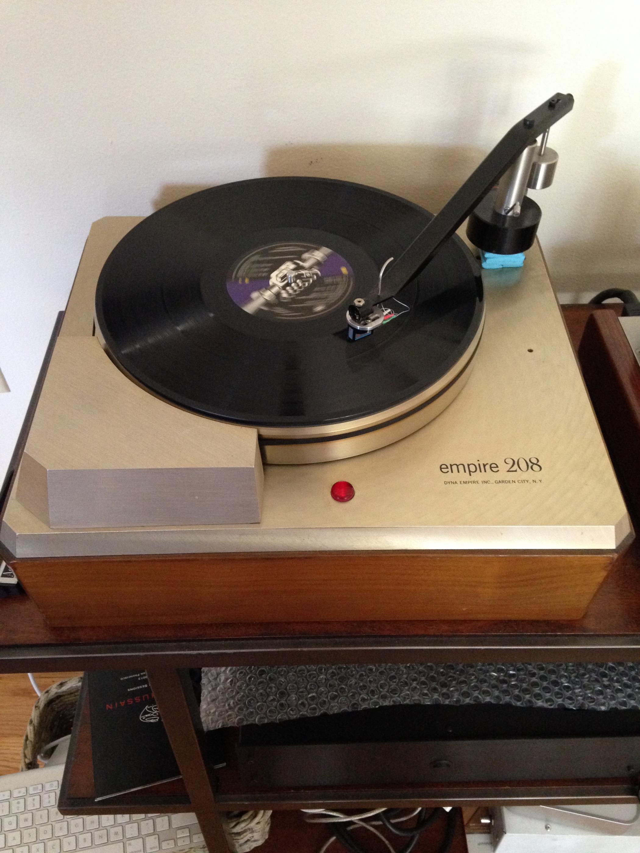

- Empire 208 belt drive turntable with RS Labs RS-1A tonearm and Genesis MC cartridge

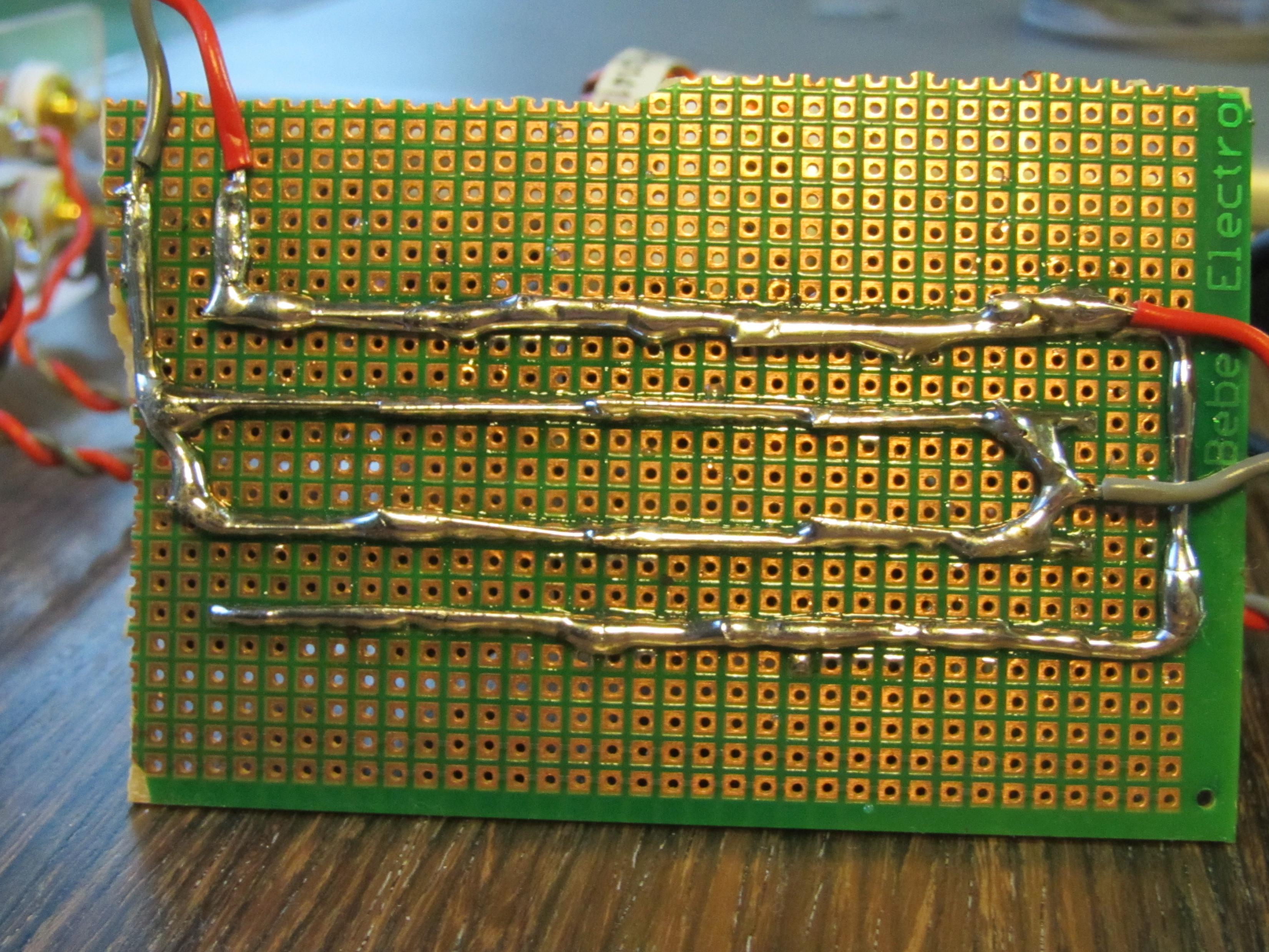

camelator: SMPS's can benefit from a capacitor bank, yes. But some of them will go into current overload protection as well, when you turn them on. To fix that you either 1. have less capacitance. 2. Add an inrush current limiter. 3. Flip the switch on and off quickly a few times to get them charged because you're cheap.
Thanks Destroyer,
sorry to be stupid, but can you post a circuit schema?
What can be the capacitance ?
another question: I understood what you say about current protection, so, what current limiter do I need ?
3 questions 🙂
thanks for your answers

As for off-board cap banks, I used to have four 2,200uF/25V Panasonic FM caps connected to my amp. I've pulled them out, because I found that the bass was too heavy and masked the mids and highs. My Astron RS-12A linear supply upgraded with a Kemet (Rifa) PEH200 filter cap, a Nichicon KZ filter cap and a Panasonic FM filter cap gives me plenty of bass and dynamic slam. This power supply and amp combination had no problems driving the Altec Model 19's 15" woofers.

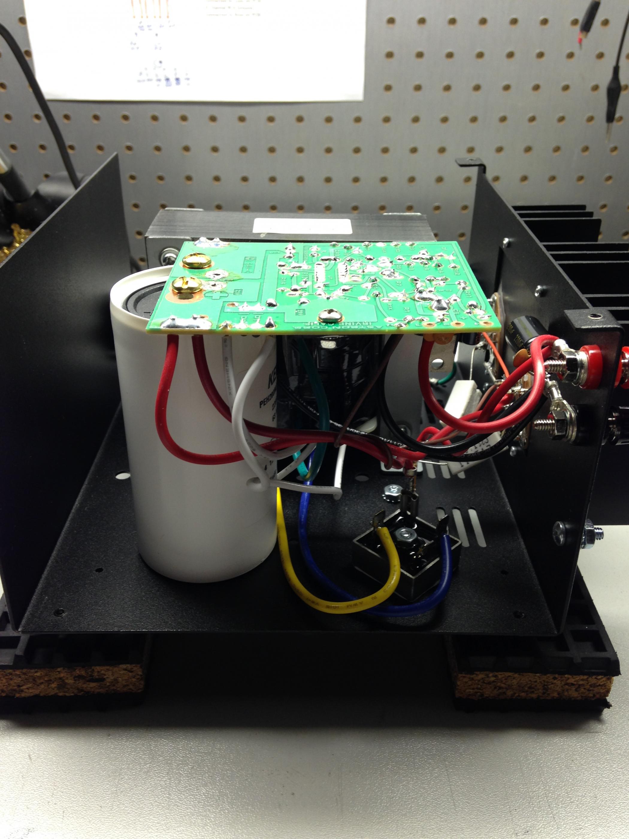

Shorted the inputs and still got hum. Took a stock board to see if it was my mods producing the hum (the snubber grounds are close to dc power traces) but still hums. Lifted the ground on the Astron by using a two prong adapter and no hum! WTF? I understand so little about power, but why would the ground produce the hum? I just had an electrician properly ground many of my outlets in which electronics are plugged (including where the Astron is plugged). So for the added safety, I now get crappy sound? Great. I'll go with sound every time. Thanks again for the help!
This inbetween ground on cord and Astron should eliminate hum while retaining safety. It's made for this specific issue.

Thanks! Will order when I need more parts for these projects which seem to grow week to week.
As for off-board cap banks, I used to have four 2,200uF/25V Panasonic FM caps connected to my amp. I've pulled them out, because I found that the bass was too heavy and masked the mids and highs.Panasonic FM shouldn't be used with tpa3116, unless subwoofer amp is made.
Excellent trouble-shooting! Some form of "ground loop breaker" should get you squared away and retain all safety. Tracking down and resolving household ground issues related to audio can be a real rabbit hole. I suppose we can't really rule out something funky with your particular Astron, but maybe that's now moot...

Yes the cap bank orientation puzzled me here as well as what I see from the top...would need to see under the hood for it to make sense...
It's just ten 2200 uF caps parallel together. Negative sides on the middle for easy soldering. 😉
