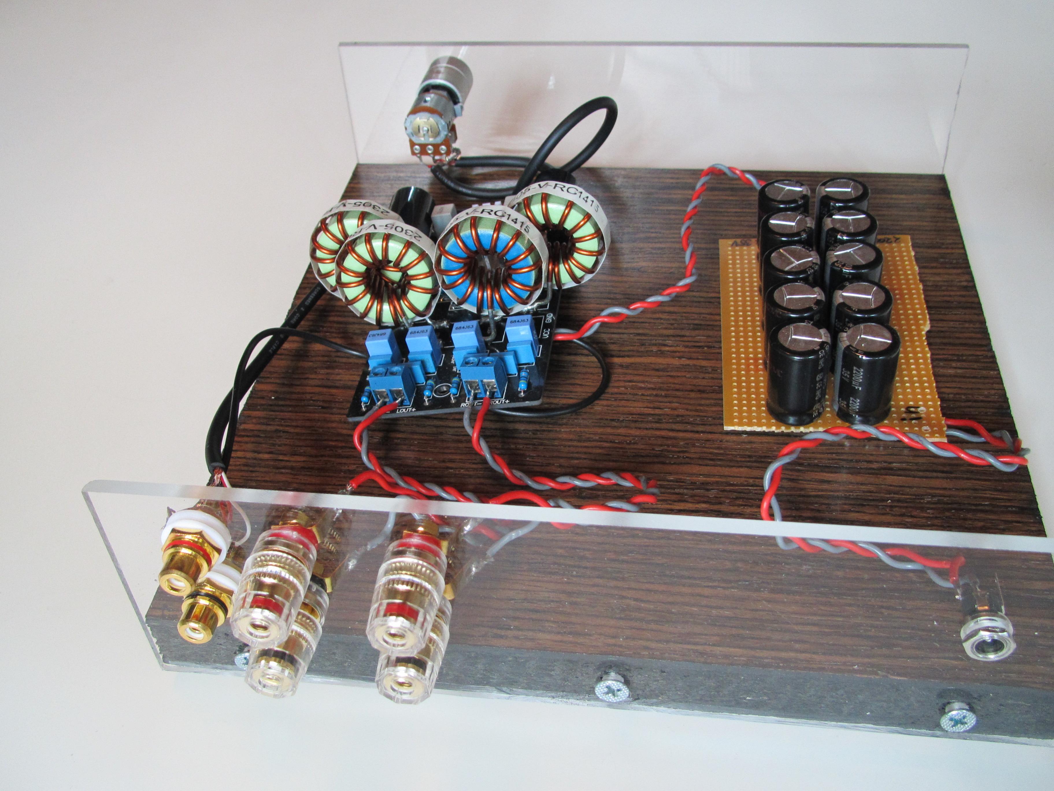

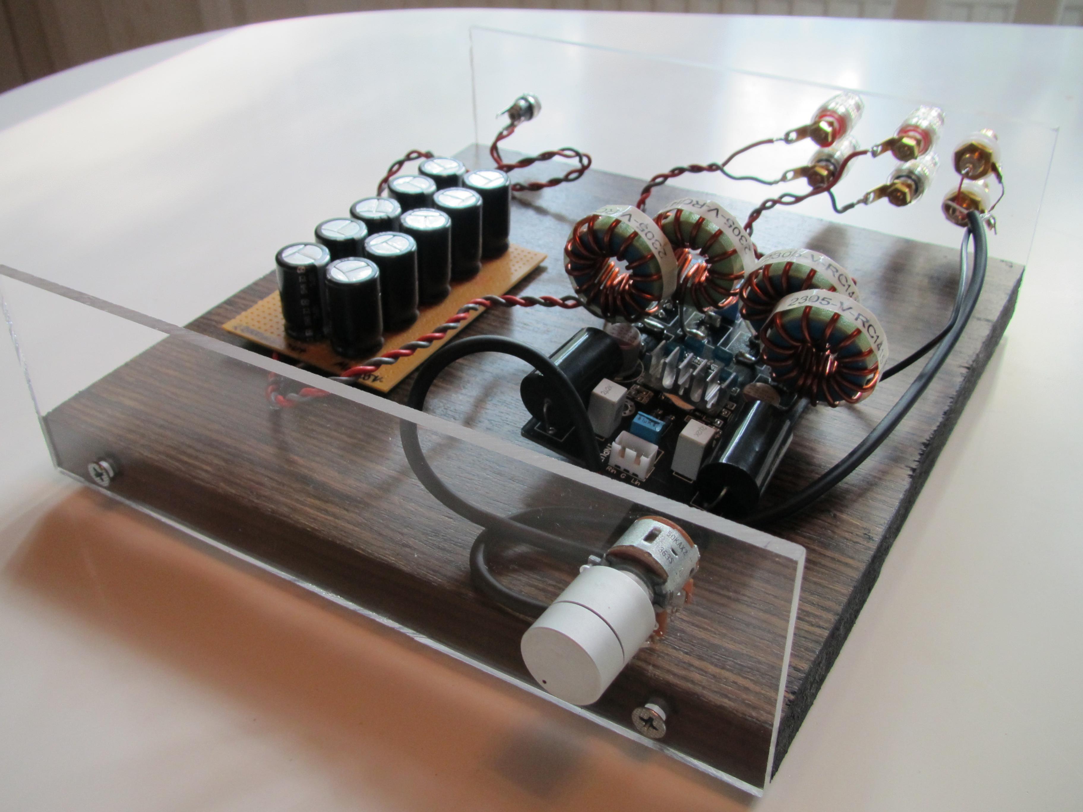

Finally managed to mod and put decent connectors for my blue/black board.
I'm not good with mechanical parts, so I build an enclosure that I could with what I had.
Mods are as follows:
Oscons for tank caps
2,2 uF Jantzen caps for input
Kemet 2.2uF ±10% 40 V ac, 63 V dc for negative side input
2305-V-RC Bourns for chokes
Murata 220nF ±10% 250V dc X7R as bootstraps
I didn't have parts for bootstrap snubber and I don't think I'm doing it any time soon. Also added 22000 uF as off board cap tank.
I like the way the amp sounds now. I still need to get some stand offs and maybe make the wire between amp and cap tank a bit shorter.

You're creating uncessary effects and letting others go because your capacitor bank isn't canceling by having the negative face a positive side.
Trust me, I've wired them like that before, for convenience, but you'll get better performance if they are not like that.

Can you please show how to wire the capacitor bank in your diagrams.
Would be a great help to the technically challenged.
Thank you.
That's a diagram for physical orientation of the capacitors, not the electrical wiring orientation.
The grey indicates the negative side of the capacitors.
They are not bi-polar.

Yes the cap bank orientation puzzled me here as well as what I see from the top...would need to see under the hood for it to make sense...
camelator: SMPS's can benefit from a capacitor bank, yes. But some of them will go into current overload protection as well, when you turn them on. To fix that you either 1. have less capacitance. 2. Add an inrush current limiter. 3. Flip the switch on and off quickly a few times to get them charged because you're cheap.
Pardon my ignorance - if the cap is not "bi-polar (di-polar??) why are there +ve and -ve leads? Typically only electrolytic caps are polarised and one has to watch out for the polarity during connection.
I don't even know what you're asking. We're talking about electrolytic capacitor banks. This is the most rudimentary stuff there is for amplifier construction.
I was confused by your post earlier when you said the caps are not bipolar. I guess I did not trace the question far back enough.
