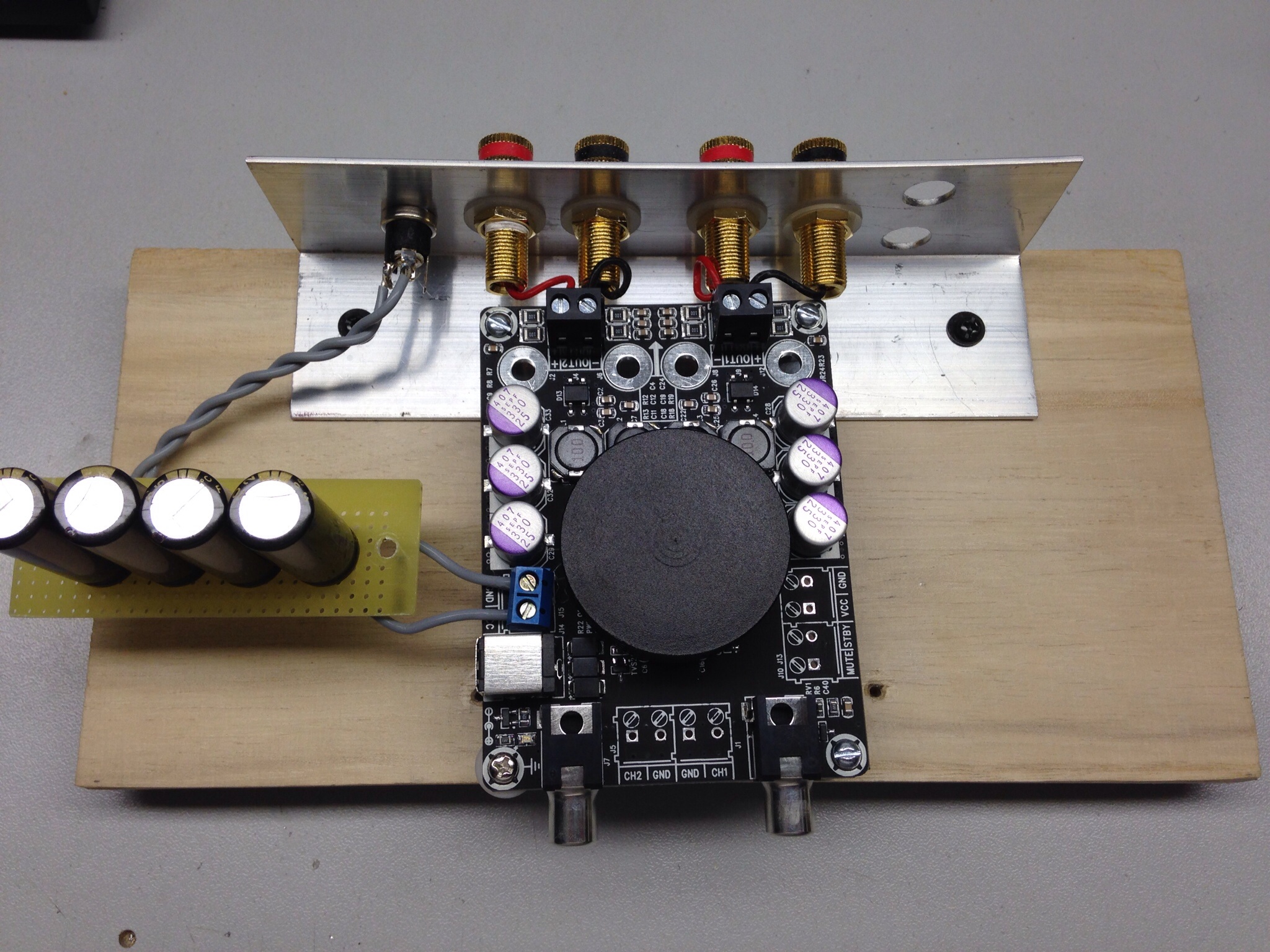

I've juste received two sure TPA3116 boards.
The stock board sound pretty good 🙂 .
As I remember much better than the YJ 2.0 red board, I will try this board again.
I will try changing the main power caps to OSCON type.
Concerning the snubbers mod, maybe I'm wrong, but I've read that this mod is already part of the design ?
PS : As writen before, don't' forget to swap +and - on out1 on this board !

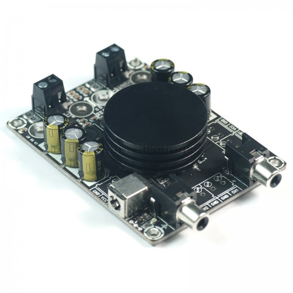

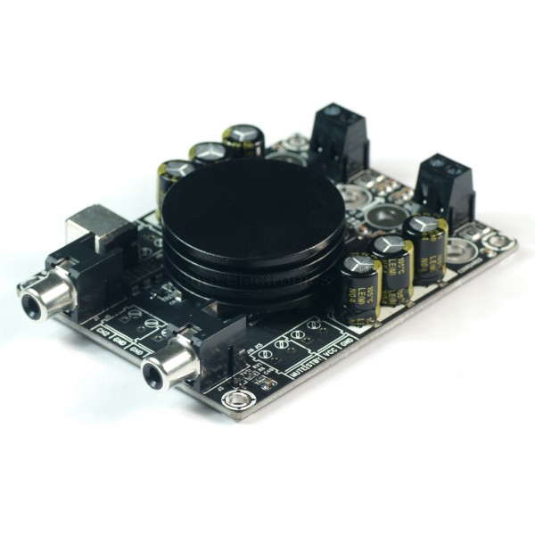

The 330uF/25V Panasonic SEPF OSCON caps have been working very well in my Sure TPA3116 amp. This amp includes the bootstrap cap snubber circuit, so aside from the OSCON cap upgrade, this amp is almost plug and play-ready. KJA 2013 says a higher power supply voltage >14VDC seems to bring the most out of these Sure TPA3116 amps.
Note that I took the 4x 2,200uF/25V Panasonic FM off-board power supply caps out. This amp doesn't need them.
Sure TPA3116 amp
