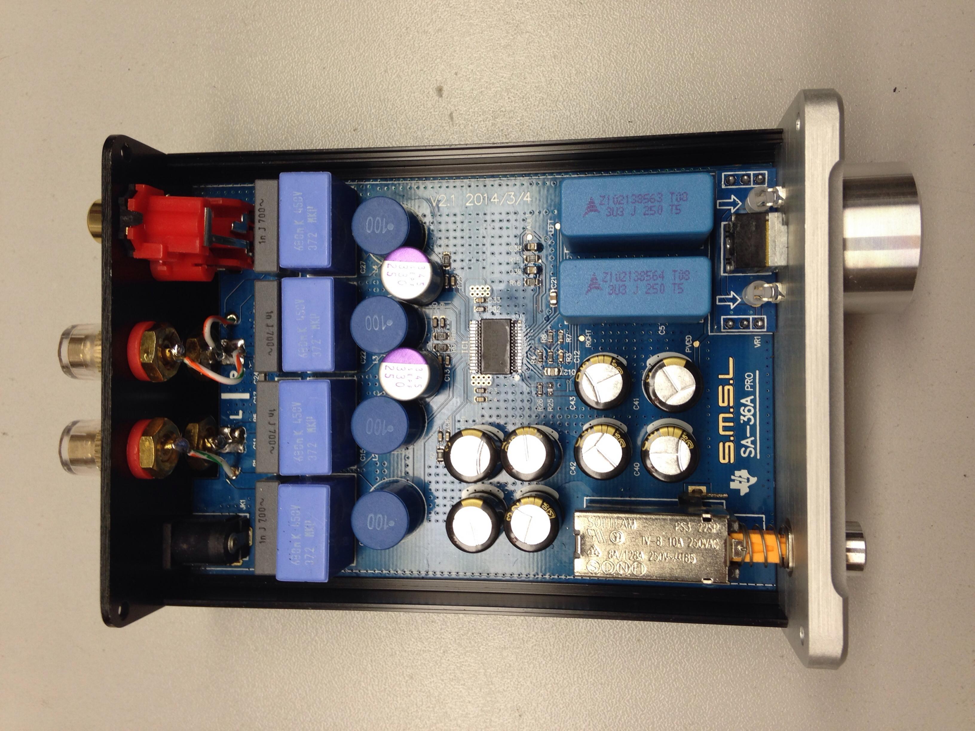

Anyone tried other caps( 8x 470uF/25V Panasonic M electrolytic caps) in this place (FC/FM or polymer)?
In my SMSL SA-36A Pro TPA3118 amp, I first replaced the 2x 47uF/25V DC decoupling caps (not sure if these are OSCON-type or hybrid-type) with 2x 330uF/25V Panasonic SEPF OSCON caps. This made a significant improvement in sound quality in terms of articulate bass, cleaner treble and warmer midrange. The sound stage became bigger too. After several weeks, I replaced the 8x 470uF/25V Panasonic FM electrolytic caps with 8x 470uF/25V Panasonic M electrolytic caps. My preference would have been to use 4x or 6x 680uF/25V Panasonic FM caps as these have a lower ESR than the 470uF/25V Panasonic FM caps, but they were too tall to comfortably install in such a compact enclosure.
Never the less, the upgrade made a subtle improvement with dynamic transient response and extended bass. Also, the very slight background hiss I heard before with my ear next to the tweeter was further diminished. Overall, I am quite pleased with the parts upgrades, and I've been using this amp as an integrated amp on very warm weather days when I don't want to use my tube amps.

Looks really nice there. Where do you get your cases?
Blacker blacks huh? Intriguing...
Thanks! My last two cases came from Ebay. That one in particular was from seller "fan_computer", who is actually in the USA (so fast shipping to me), but still price competitive with the overseas sellers.
I've also built a using case from Context Engineering / San Jose Scientific, as well as one of the Sure branded cases that Parts Express sells. The Sure cases are nice, except they're not a split-body style, so not as convenient to work with (see mine and Lacro's recent posts over on the AudioCircle thread for pics).
As far as the "blacker blacks" comment, don't read too much into that. I spent all my time building the thing, and very little listening to it. I've always noticed a subtle difference in "character" between the 3110 and 3116, though I can't quite put my finger on it. I could quite happily live with either though.

Keep in mind that the stock Epcos film caps are 3.3uF on the "+" differential inputs. There are two 3.3uF SMD caps (assuming they are ceramic) on the "-" differential inputs. If you are changing the stock film input caps to 2.2uF Mundorf Silver-Oil caps, then ideally, you want to install 2.2uF caps on the "-" inputs to maintain equal impedance on the differential inputs. This was not an issue with modding Tripath Class D amps, but it could be an issue with these Texas Instruments TPA31xx amps.
I should also mention that I installed an Epcos B32921 series 0.047uF/305V metallized film X2 safety cap across the power switch leads on the underside of the amp to eliminate the turn-on pop. The exact part no. is B32921C3473M189. This fit nicely underneath with the proper lead spacing once I trimmed the lead lengths. Sorry I don't have a photo of this installation.
