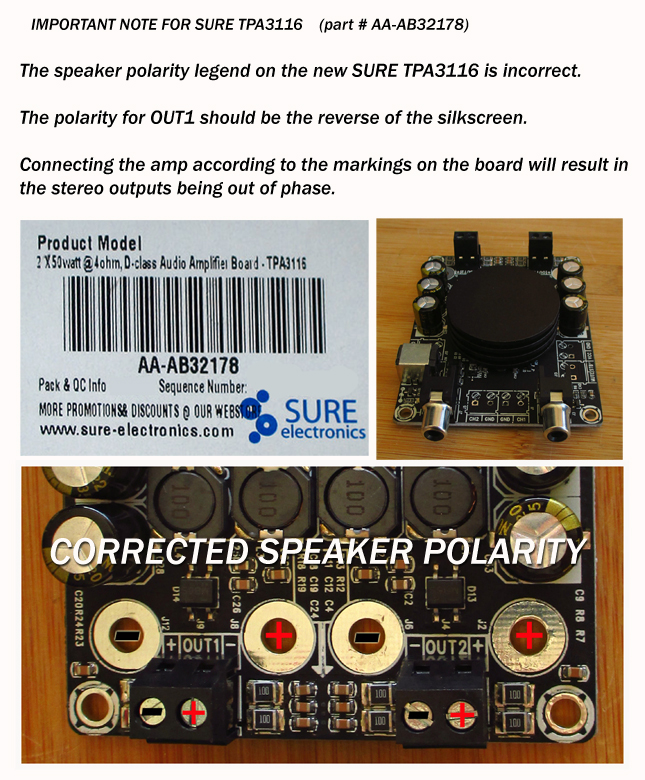

I noticed some confusion about this here and on another forum. Hopefully this will clear things up. While it's possible that SURE will correct this in the future, I'm guessing there are a bunch of them now made with the incorrect output polarity markings.

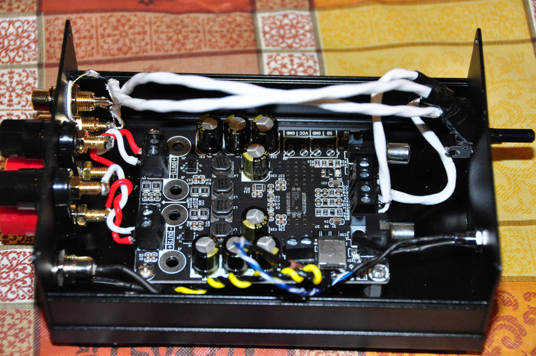

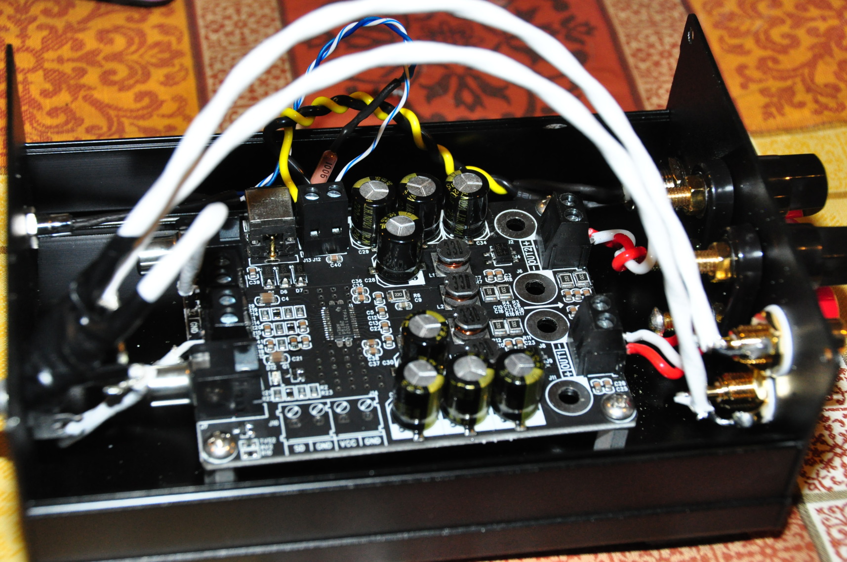

Here was my weekend project: putting together a little amp using the new Sure tpa3110 board. The original Sure tpa3110 board got me started down this rabbit hole of intrigue and obsession.
Nothing special about this build, just thought some might enjoy the pics. The board is stock (except for the screw terminal blocks I added). I intend to replace the stock electrolytic caps with the OSCONs (soon as they are delivered).
Have only done a minimal amount of listening so far, but I really like what I hear. I always liked the original Sure 3110 board. Might just be a case of "new gear syndrome", but right now I'd have to give this one the nod over my modded YJBlue 3116. Can't really put my finger on it, but the best analogy would be that this amp has the "blacker blacks" if we were talking plasma TVs. My only complaint with this board is that there is a power-off pop. To address that, I'm going low-tech and will just add a little rocker switch to connect the "SD" and "GND" pins. Using a paper clip right now, while I wait for additional screw terminals and a switch to be delivered.

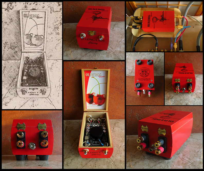

I really like these two new boards from Sure, especially the 3116. Here's what I did with mine. With only a set of Oscons a good home made power supply, quality wire and hardware, this board has fast become my favorite by a good margine. These dark boards with dark solder mask make it hard to see exactly how everything is being implemented... maybe it's just a better match with my speakers....whatever it is, I like it a lot.
