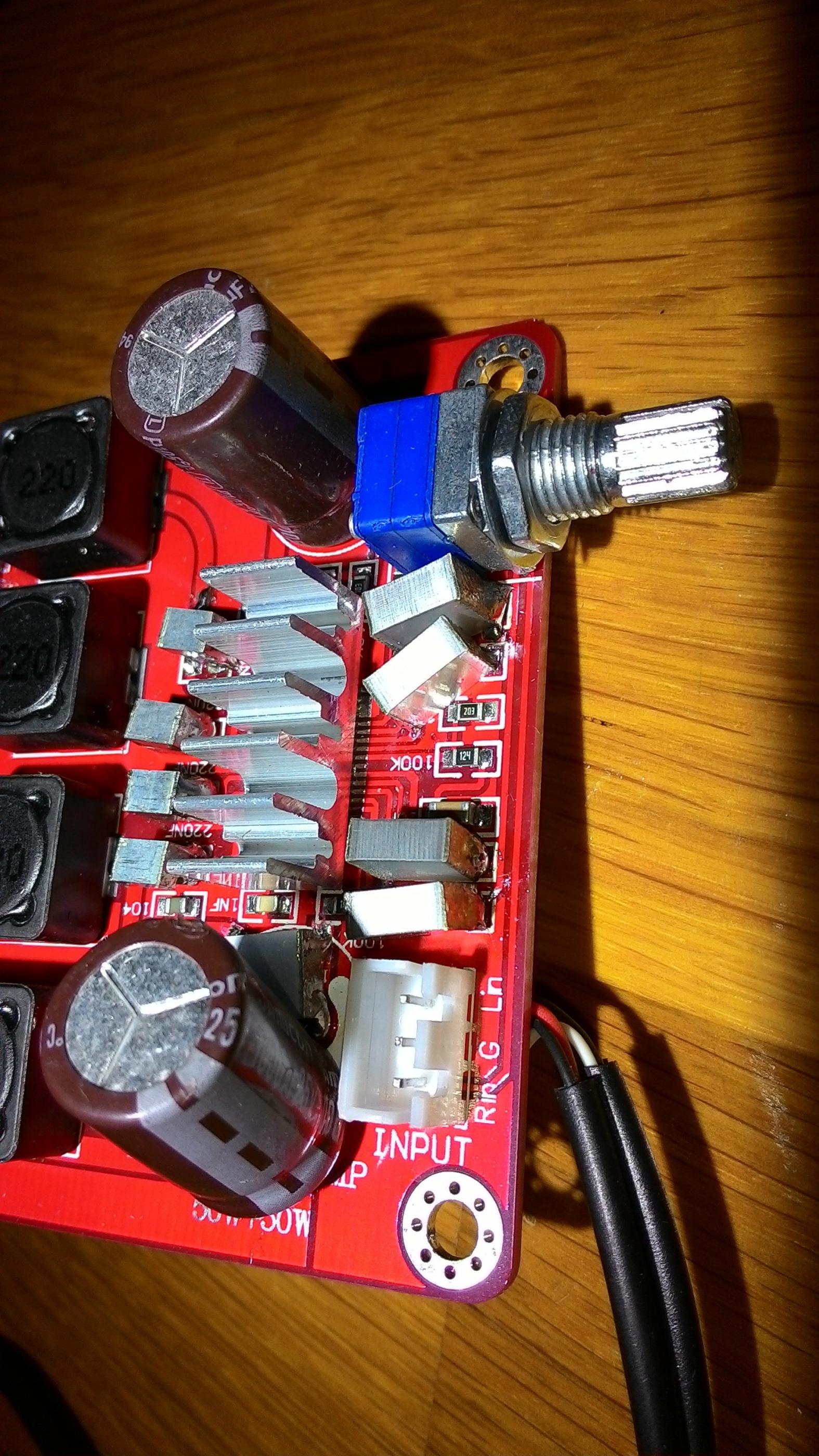

I finally got the film smd capacitors installed🙂 2x100nF as bootstraps (soldered on top of each other) and 1uF as input capacitors, same (1uF) instead of 680nF output caps and same in parallell with the power caps. It has to be said that the film smds were a bit expensive but I think they are worth it! I've only been listening for a couple of hours but the amp sounds more transperent, and not stressed at all when maxed out. Noise is minimal and the ringing is as low as my other modded cards even with the wrong inductors. So far I'm really impressed with sound, it truly sounds like a large amplifier! I need to do some more listening before I can vauch for this hard mod.. But I do recommend these as input caps since they doesn't seem to give any coloration. (Btw, they are bought from the same eBayer: 5X CF057D0105KBC Film Capacitor SMD 2824 1uF 50V 10 PX 0396 | eBay).
Here's some eyecandy😀

Hmm... it may be combination of capacitors and resistors that you have on post inductor? I know that they parts vary from design. I have 560 nF instead of 680 nF and 5.6 ohms instead of 3.3 ohms. I am using stock bootstrap film caps too. Anyhow, it may be that your speakers have a very sensitive high end.

Nice work getting those SMT's to fit there. Interesting how many people with Danzz blue/black are switching away from film to ceramic for bootstraps and you went to film but SMT. Are those the stock main power electrolytic caps? If so that should be your first upgrade. Try new Panasonic 330uF 25v SEPF OSCON's. How did switching to 1uF vs 0.68uF on output filters sound I wonder? Smoother and less HF hash?

I am not suggesting different values just wondering if variation in parts from YJ a today may be cause. Mine happens to have 560nF for main LC filter and 5.6R for snubber vs 3.3R as recommended.

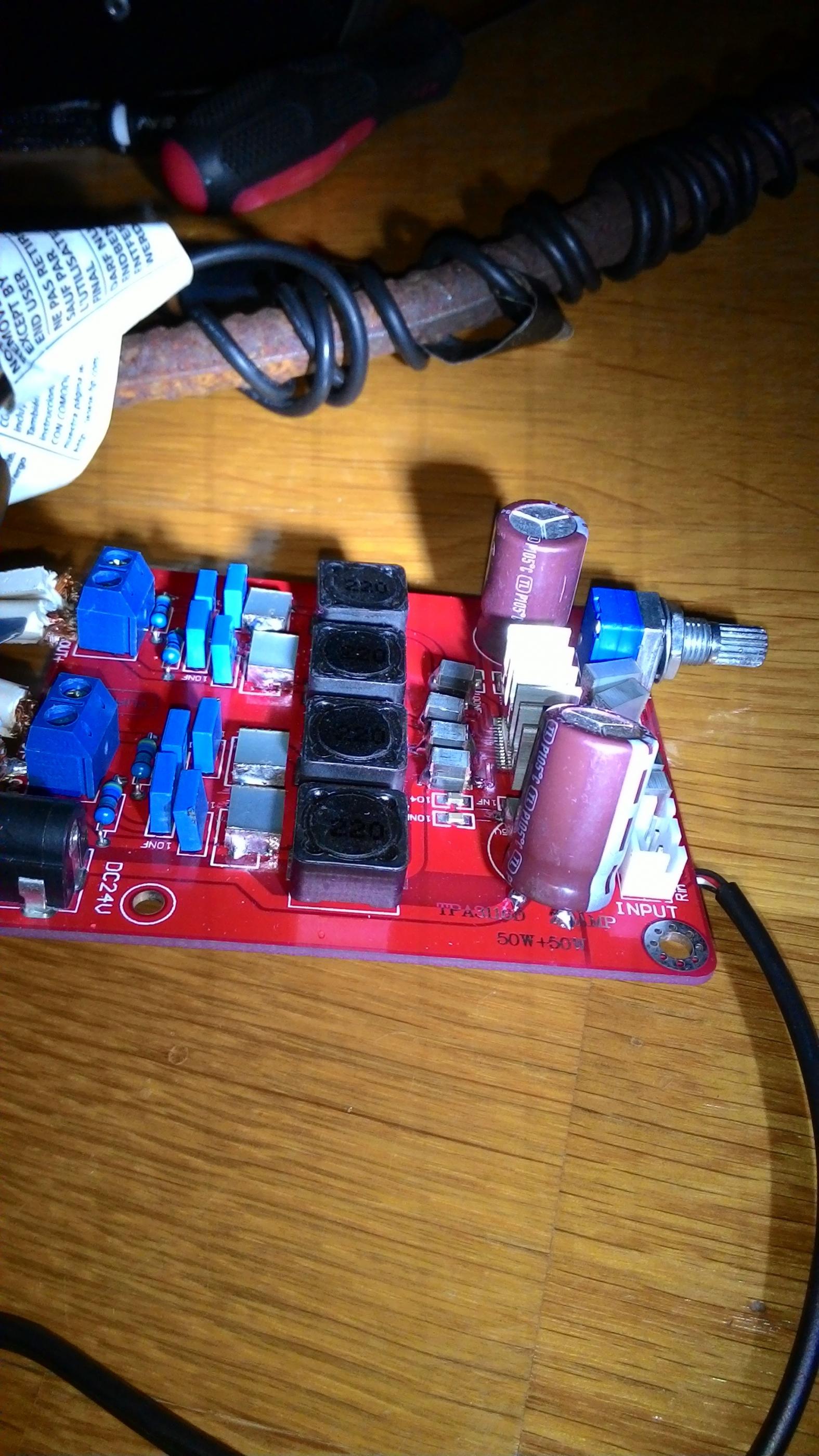

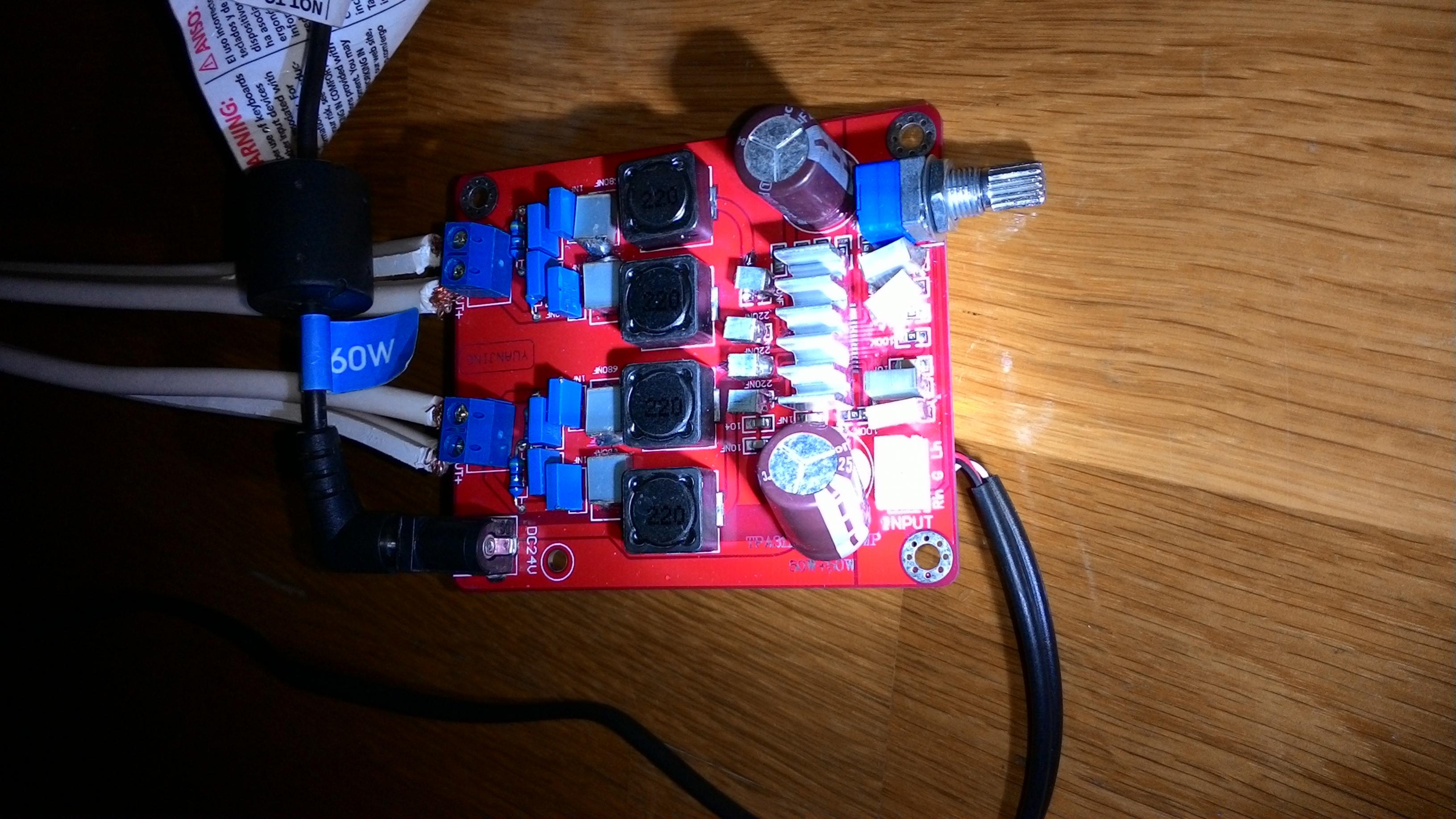

Here's my YJ Blue/Black in its permanent home. Mods include Pany Ceramic bootstraps, Wima and Nichicon caps and Coilcraft inductors. I'm using a Tocos Cosmos 50K pot. It's perfect for my little discreet living room setup using Markaudio Alp 7.3s in the Pensil cabinets (which still need to be veneered.
The power supply is a 24V supply that I purchased on Aliexpress. Plopped it in a black plastic Hammond box to make it stealthy.

Looks good! Curious what inductor value you used for the Alpair 7.3s. I have a set as well that I treated like 8 ohm speakers, and so used 22 uH inductors.
Also curious where you got the amp case. I like it!

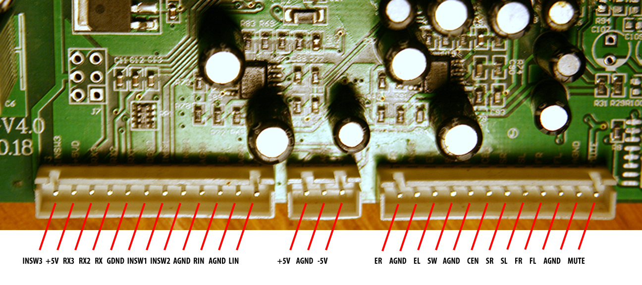

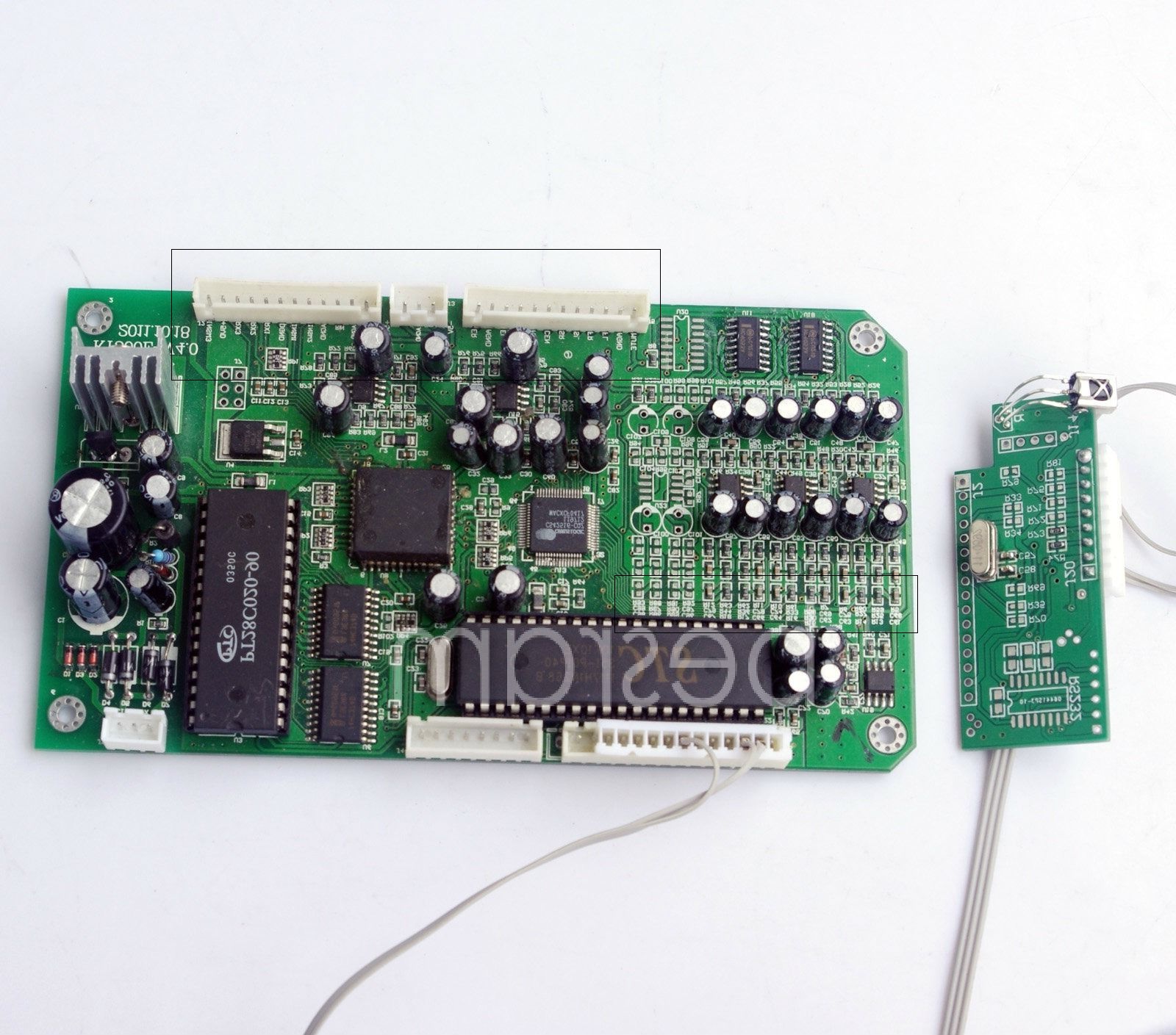

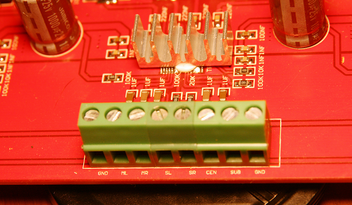

I have a YJ 5.1 TPA3116 board that I wanted to put in a cabinet with a decoder board. Problem is I don't know enough to wire the 2 boards properly. The amp is straight forward enough; it's the decoder board that's baffling and the supplier is no help at all.
Any directions would be mostly appreciated. 🙂
