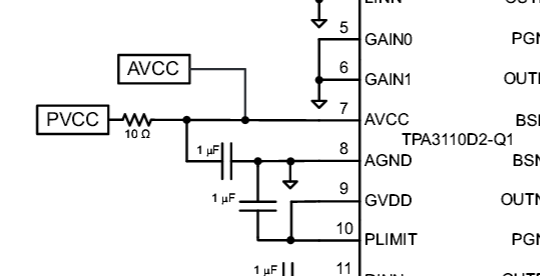

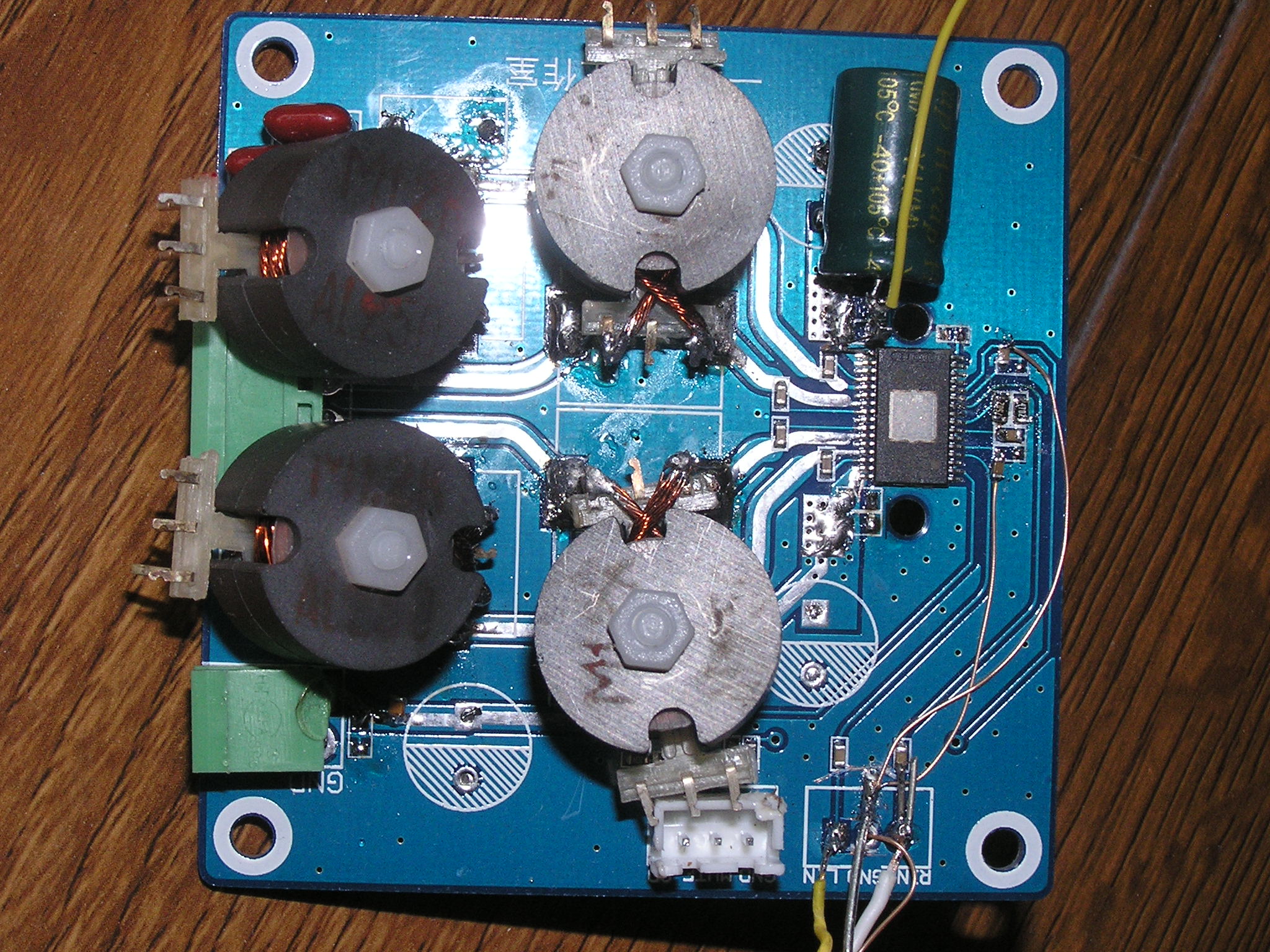

Significant improvements from separating out pin17 (analog +ve supply) from its two near neighbours which are the output stage supply. My first tweak is 3.3ohms in series and 10uF 1206 to the plane. This has brought the soundstage alive and almost killed the sibilance on voice, very worthwhile mod. I rather suspect that HF ripple from the output stage easily floods the analog stage LDO reg (see DS p4 for internal diagram) so this passive filter's giving the signal processing stages a cleaner supply. I'm also bypassing the power connector to the board and feeding the ground in directly to the hexacap, meaning the switching currents aren't flowing across the groundfill now. Next up - move the grounding of the output filter caps off the fill....
Resurrecting a 10-day-old post here. Does this address a problem unique to the blue Taobao boards you have, or is it something that someone with a YJ 2.0 blue/black board should consider addressing?
(And just out of curiosity, could you share images of how you accomplished this? Those pins are mighty small to my aging eyes.
I don't believe its unique to my board though I've not examined the others. The reason for my belief is the decoupling isn't mentioned in the DS for TPA3116, though it is in at least one other member of the family. So the implementers who followed the DS won't have included it. Its not on TI's example schematic.
Pic attached - I don't have a macro lens so this is about the best magnification I can do - pin17 is right beneath the green electrolytic (top left corner of the chip). I lifted it from the board and wired it to the top side of an end-mounted ceramic cap (1206). I then wired that cap to the 'lytic - fine wire is required, 30AWG or thinner. The yellow wire is brought off board to a 100,000uF bank of caps.
Also note the inductor substitution - the 0.68uF caps were taken to the reverse side of the board to create space for the hulking great coils....

Abraxalito, my friend, you do not do things by half measures. I can't reconcile your above photo with the other photos of the Taobao 2.0 I've seen, it's been altered so much. And then there's your power input cap arrays... Rave on!
So you have two caps in parallel off of pin 17. What do the other leads of the caps connect to?

I started out with just the 10uF cap (going to the groundfill nearest pin17, just to the north of the chip). Then added 470uF (snatched from the board itself as I'm using off-board bulk decoupling). After that I was curious as to how much improvement could be gained by going 'the whole hog' hence the yellow wire to 100,000uF off the board. The answer was 'not a lot'. So I don't recommend going much beyond 470uF decoupling on pin17 - the performance can't be improved because the internal reg determines the impedance seen by the internal circuits, the cap is at the input to this reg.
Earth one assumes.
But isn't there a 3.3ohm resistor in series as well? I guess thats hidden somewhere in there?
