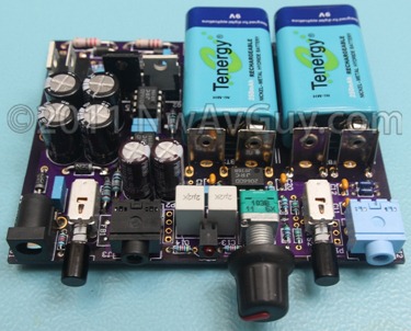

O2 Headphone Amps as best pre-amp?
Do tubes amps sometimes have more 2nd harmonic distortion, which is pleasing to the ears for many and sometimes the reason why tubes are favored?
I think if you want the best and most transparent (i.e., no coloration) pre-amp, I have heard that the Objective 2 or (O2) headphone amp can't be beat for the price. It is about $69 to DIY and $130 prebuilt with case.

This thing beats kilo$ headphone and preamps out there under testing.

It'd pay to bear in mind that we only have NwAvGuy's word for it that its 'transparent' which claim I believe he based on how it measures. Experience suggests though that it'll sound coloured given its using opamps with scant decoupling for their power rails.
