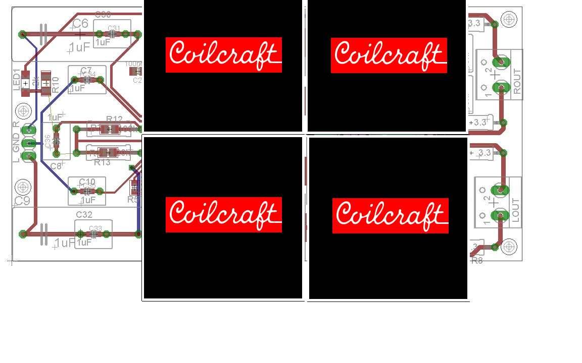

Only the wires needed to connect them might spoil dcr and some 🙂 you guys are joking aint you😕
I suspect they will improve the sound. However they're not the lowest hanging fruit, the power supply is.
True ... but they're the second lowest would you not agree? And by power supply, I take it you mean close-as-possible SM HF caps like the "weiner"?

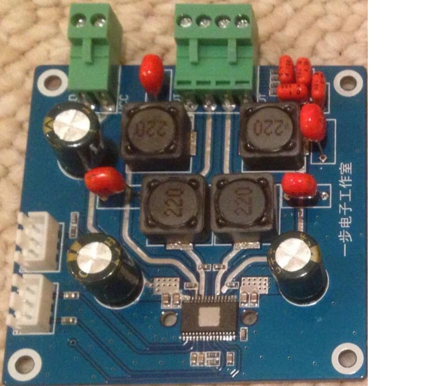

What's with calling the Ybdz 2.0 amp the 'Wiener'? As in winner? It does have one of the best layouts IMO. I will upgrade the stock PS caps to 1500 uF Panasonic FC's soon to see if it helps. I think one of the biggest overlooked upgrades is to change the 1uF input caps to 5.6uF - there is no harm and only upside is improved bass extension down to 20 Hz correct?

Ok, now I'm confused ... I thought the Weiner and the Mr. Tao were generally considered proper PS bypassing with proper components for the TPA3116??? And I was just about to buy them ... And I'm not technical enough to make proper arguments so others who are please jump in ...
Weiner
Mr. Tao
They are considered proper (in the sense of PC) - IOW they are as recommended by TI. But bear in mind that TI recommend NE5534 as I/V for their DACs. So opamps are the proper (PC) solution for DACs' output stages. Nuff said?
Guys (any gals?) on this thread in general though will find they have to dispense with the proper things in search of what sounds best. What sounds awesome is a long way from being proper in the EE sense.
Psu layout design could be good by the Weiner, problem is smd don't show what they are, so weiner could easily be worst performing pcb on market distortionwise. Components can indeed be replaced, smd is just tiny bit harder, I rather add a decoupling ceramic cap 1mm from chip myself on another pcb knowing it is just that smd I got to solder lol
