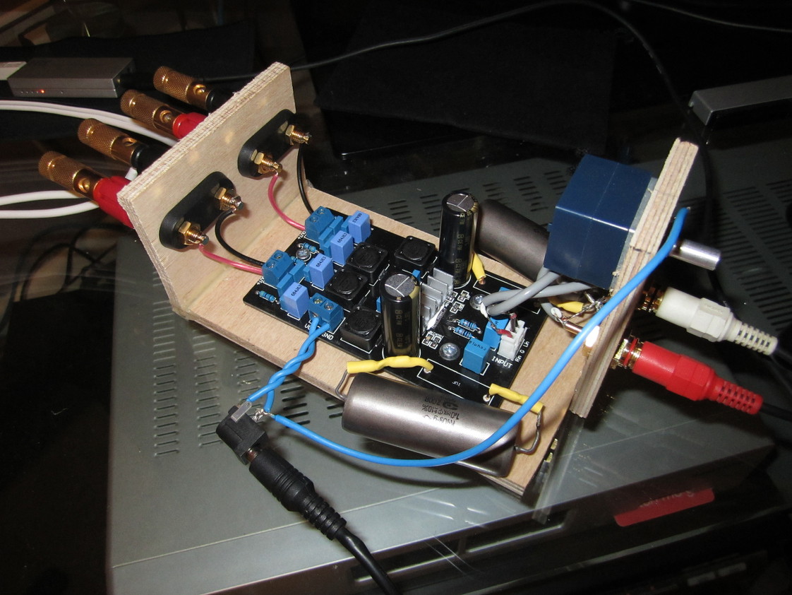

Finally got the Russian PIO input caps fitted along with upgraded Panasonic electrolytics for the power supply. Not the most elegant solution, but it sounds good 🙂.
I need to get round to putting it all in a proper case at some point. But I might wait until I've done all the mods/tweaks before I do that.
Next tweak is to add new inductors, tempted to be cheeky and get 4 samples of the 7447709100 WE-PD SMD power inductors from Wurth to try.

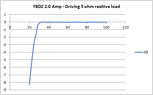

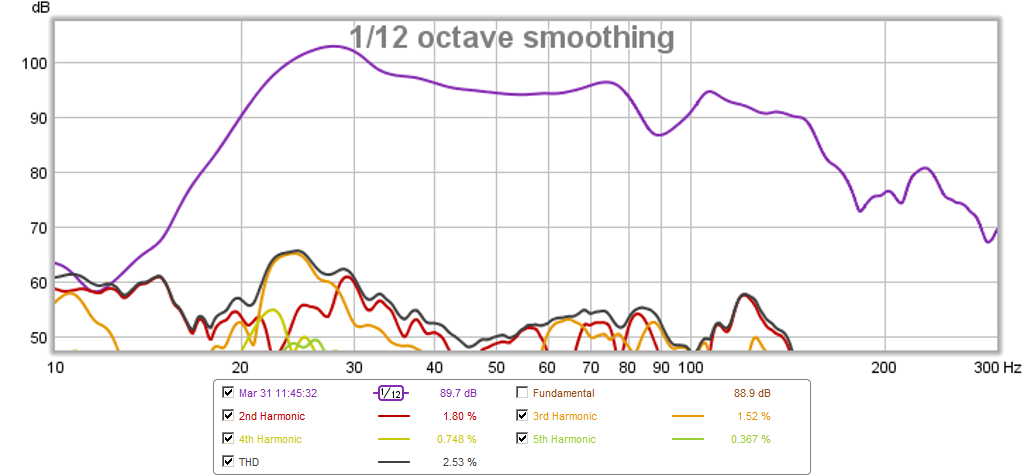

We don't all use commercially available speakers - did you forget that this is a DIY fourm? These are from sub woofers of my own design (a 4 foot long MLTL with 6.5 in driver), and yes, I can hear 20 Hz from them quite well. The YBDZ amp with stock 1 uF input cap will naturally have fall-of below the 40Hz. I believe TI recommends a 4 uF cap if you really want full amplitude at 20 Hz.
Here is a measurement of the RMS voltage drop on a 5 ohm resistive load in dB (6 volts nominal) from 100 Hz down to 20 Hz. It looks like there is a -8dB falloff in the amplitude voltage at 20 Hz - but you can still hear it from the sub.
And here is the output of the subwoofer's port:
