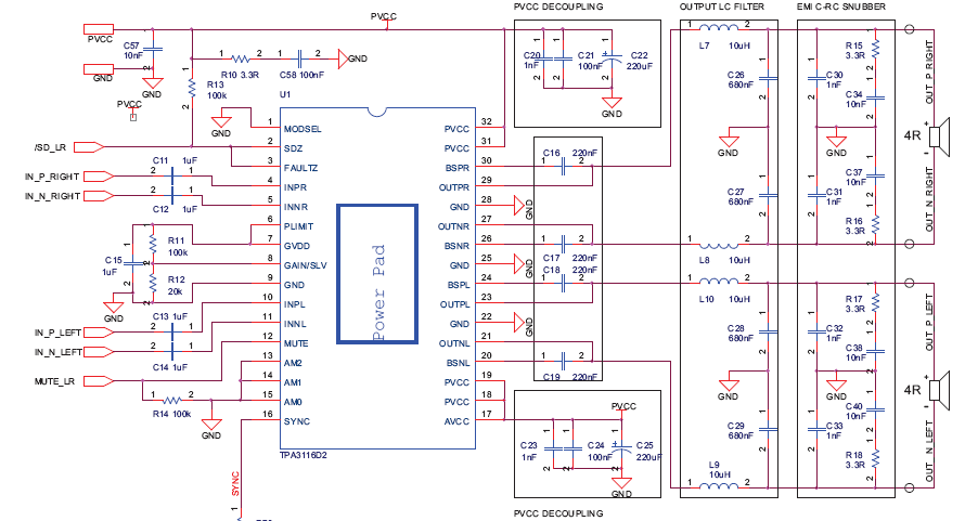

I agree comparing to a Lepai is not fair - but from the standpoint of an equivalent price point circa $20 - it is very pertinent. I am just saying for about the same money, the TPA3116D2 is a better performer and value.
I was unaware that the YJ "red PCB" TPA3116D2 amps are 8 ohm? The chip itself is designed to handle 4 ohms normally if one follows the standard TI reference design (of Fig 27 as used by @DUG). I am not sure which component change makes the YJ board 8 ohms nominal? Is it the switch to 22 uH inductors vs the factory spec'd 10 uH? That affects the mod frequency filtering cut-off.
TI's Ref Design (Fig 27):
Is there any literature or specs from YJ that says these are nominal 8 to 16 ohm loads?
Yup. And the output filter caps aren't 0.68µF either as specified by TI. It's a terrible blunder on YangJing's part to save $0.30 in parts and lose 80% of their potential market. And no, YJ doesn't specify load impedance but we can just calculate that it's designed for 8-16 ohm loads from the spec sheet.
Have to note that you can get decent TA2020 amps for under $20.
Good catch Saturnus. Looks like all we need to do is swap out the 22uh for 10 and swap C to 680nf. Should be easy enough. I just got mine and it is driving 4ohm MTMs and still sounds great.

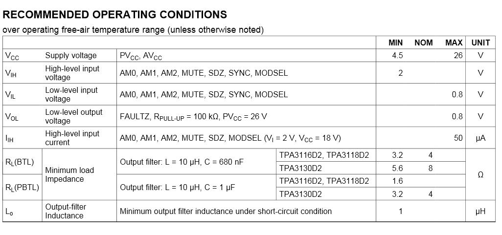

Here are the recommended operating conditions (see attachment)
The stock YJ 2.0 board comes with 22uH and .56uF and drove 4 and 8 Ohm speakers without any issues. I've now installed 10uH coils and have experimented with various film caps ranging from .47 - 1uF and again it drove 4-8 Ohm speakers without any issues.
Regardless of what is considered optimum, this stock board should provide decent sound for most speakers that might be used.

Also, the output from the chip has 220nf caps in series before the coils.
Does this value need to be changed when changing the value of the inductors?

The 220 nF cap is the bootstrap cap and is not in series with the output but tapped off of it if you look at Fig 27 several posts back. The bootstrap cap provides the switching FET the bias it needs to work and stays fixed at 220 nF independent of the LC filter. I don't know why YJ messed with the LC combo spec. The thing to look for in inductor specs is whether or not the specified nominal inductance value stays constant as a function of current. The cheaper ones will have a reduced inductance as current goes up. The other thing to look for is what the current rating is. For 40 watts driven by 17 volts the peak current is 2.35 amps. This level of current is really only for peaks and transients as we will operate below 25 w most of the time in a continuous mode. Many of the inductors should be rated for at least 2 amps and ideally 3 amps. I know Dug has looked into this extensively and can provide us more tips. You have to look at the manufacturers spec sheets for performance vs current.
