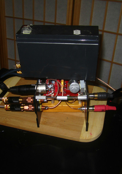

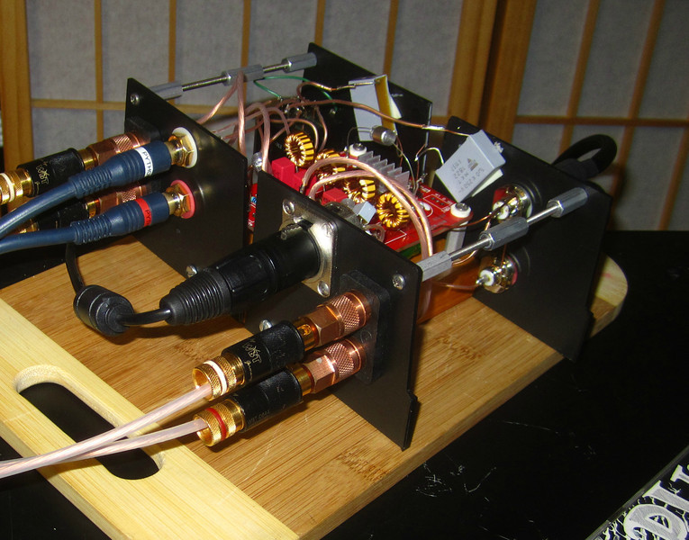

I like the way you set up the "box" for the amp (as per the photo a few posts ago). Two pieces of acrylic plates should work well. I am going to give this a try (I was never good at building chasis).
Let us known how the Bourn 22 uH coils work.
Thanks, Will do. I used some plastic dividers that came with some parts bins. It makes it easier to get to things when you're "fiddling" with it and I place an SLA battery on it to stop the "tug-o-war" from the cables.

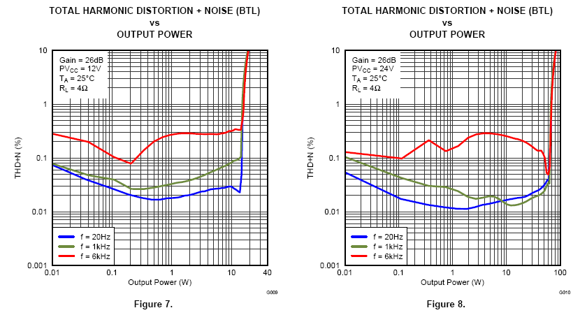

Not sure what spec you are looking at that says what you claim. If you look at TI spec sheet Fig. 7 and Fig. 8 they show THD curves for 12V and 24V power supply, respectively. For the 12V case, the steep transition to high distortion occurs at circa 15 watts (into 4 ohms), and for the 24V case, the transition to high distortion occurs at about 50 watts. Below these transition "walls", the distortion is circa 0.1%. If I linearly interpolate where that high distortion wall is located for a 19V power supply, I get about 43 watts. Do you have data or graphs from TI that show otherwise?
See graphs pulled from their spec sheet below.

why assume when it's already measured?
it's 2 page down from your figure.

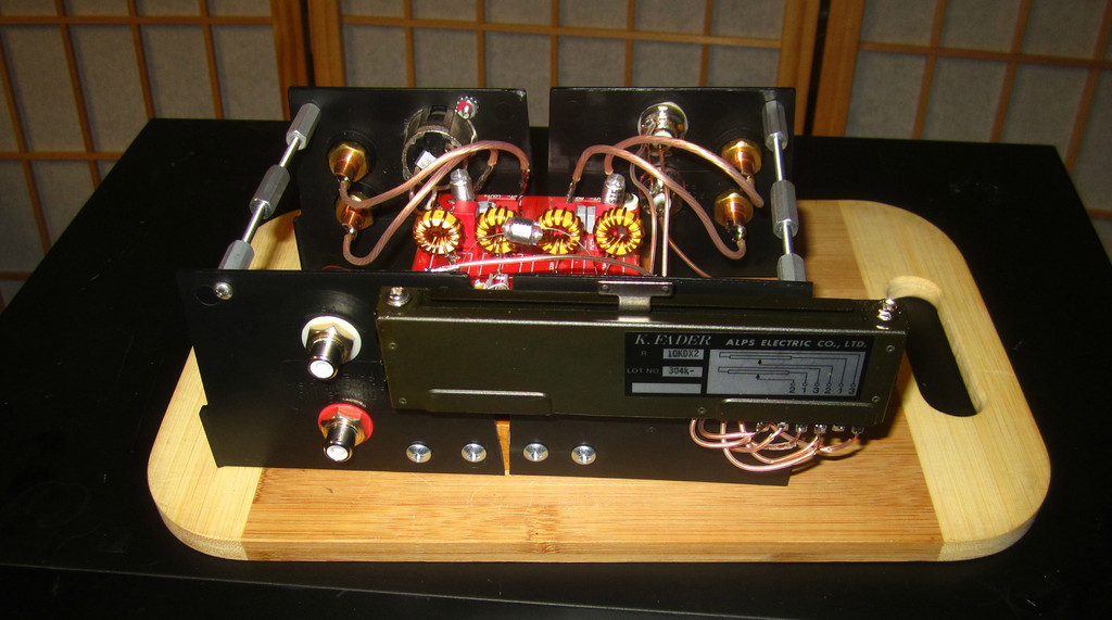

You owe it to yourself to change the volume control to something a bit better. I've tried six or seven different ones and although all were different, they were all an improvement over the stock one. I've put the 10K Alps K-Fader back in this one and am really loving the way this amp sounds.
Have fun!
