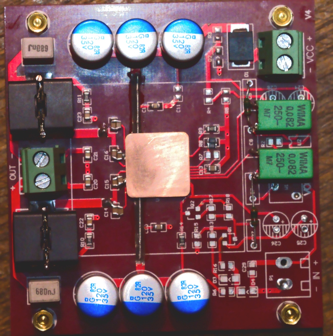

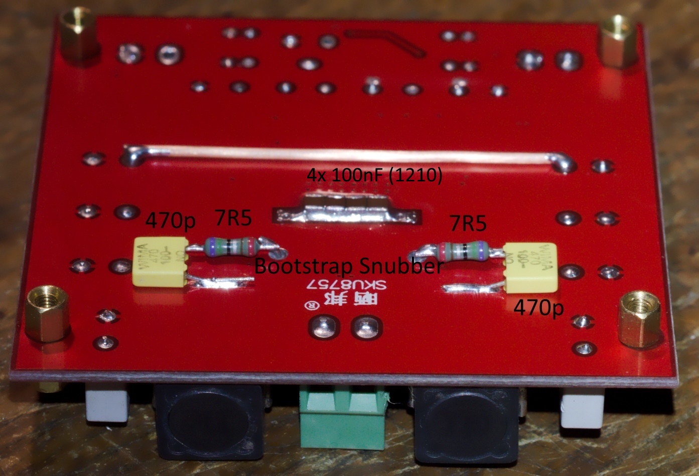

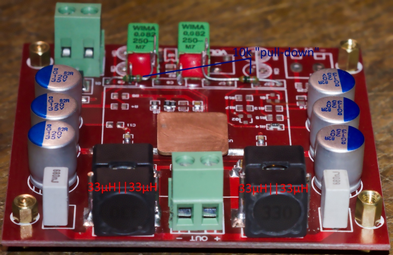

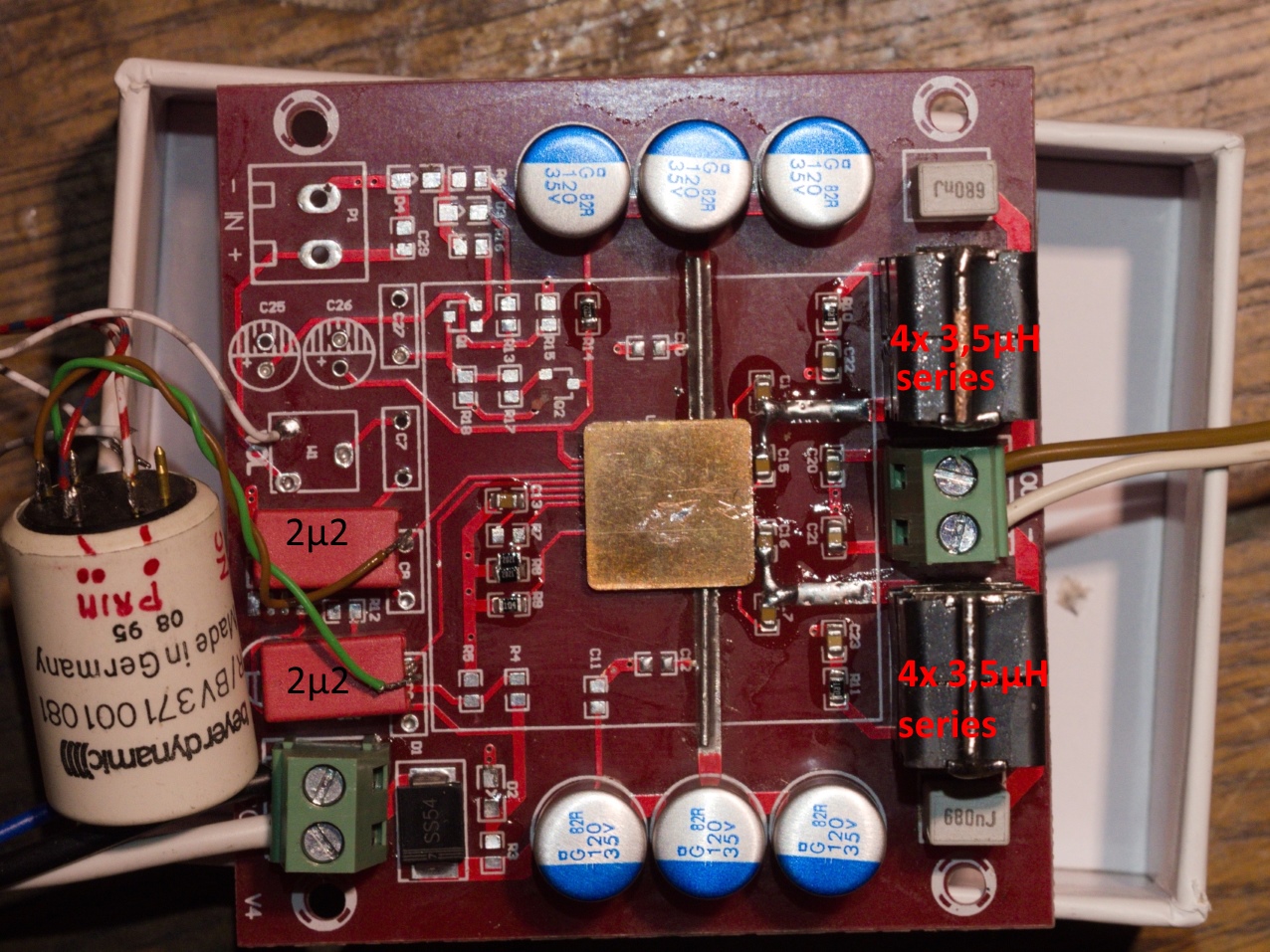

Hey all TPS3116 fans,
I'm about to build a 2 way active amp. 'Bought the "SODIAL XH-M544" from amazon.de - what I liked about this board is that it is not too densely populated and all SMD parts are 0805 at least.
I'll drive all the amps balanced, 'glad to find out that the turn-on/off-pop is completely missing in that configuration. I'm also experimenting with input transformers that I had on hand... will be driven by balanced source as well.
I modded the boards to comply with my speaker setup, LF will be Dayton RS225-4 while the HF will be Sica LP 110.28/380 TW.
Cheap 'lytics were replaced by Chemi-Con PSG series.
Amplification is set to 20dB and all boards will be run in master mode.
Whats funny is that these boards stay completely cool, while another amp of mine (Sanwu TPA3118 2.1) heats up like crazy, all amps powered from 19,5V laptop brick)
The amps will be fed from ADAU1701 that are I2S input. I'Ve not settled about the output format to the amps, either standalone DACs or balanced driven by the ADAU DACs (balanced in DSP SW).
Will report back once I'm done with all that stuff.
Cheers!
edit: I'm in doubt about the parallel/series connection that I did on the output inductors, If one has some insight about putting exactly this type of inductors in parallel/series I'd appreciate that.

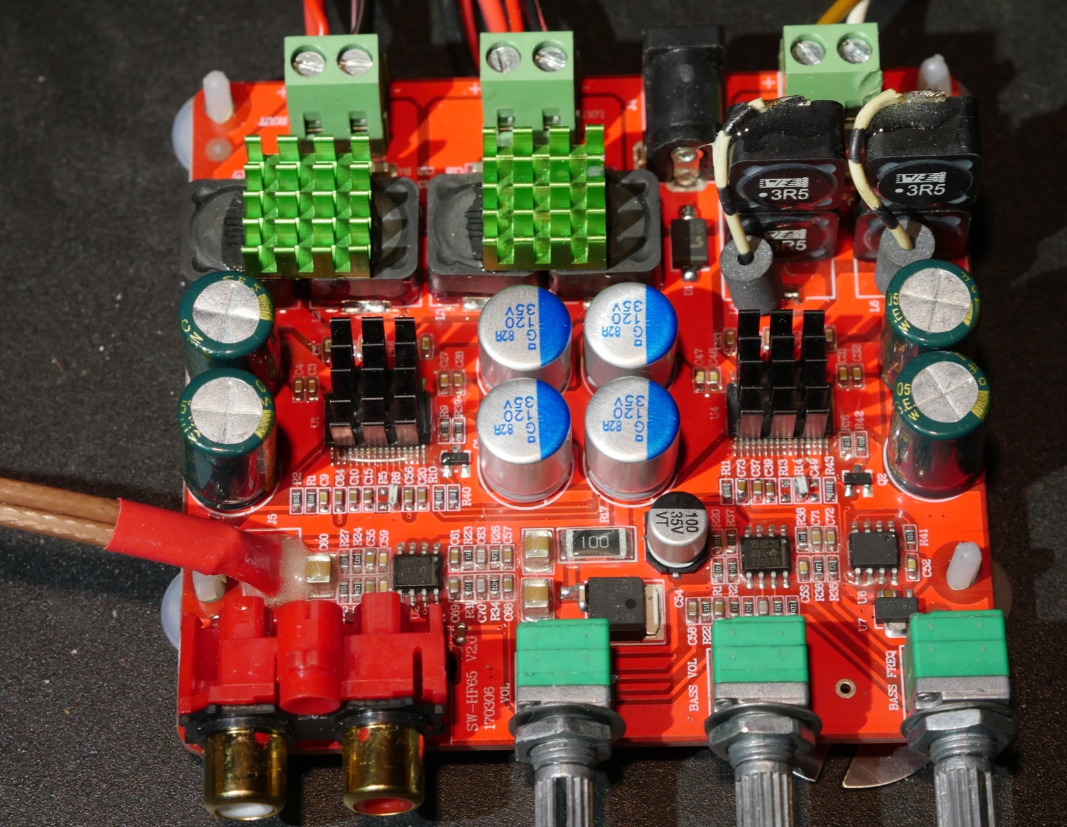

TPA3118 rely on the bottom pad of the IC to transfer heat to the circuit board.
If this is not implemented very well then the IC does heat up quite quickly.
Do the chokes also heat up? If so, it is likely that the carrier frequency of the chip is wrong. None of my TPA3116/18 boards heat up. One did and that was because the gain/mode setting was wrong and the carrier frequency became some 130KHz.
yes, the chokes also heat up, thats why I've fitted the green heatsinks. Thanks for the hint, will check the config.
edit: OK, easier said than done, I've got the weird behaviour to mold things into epoxy once I've found them to work. Well, that will be a massacre 😉
I'd exclude that. The mono boards (TPA3116) stay completely cool with the copper plate only, I guess they do not even reach more than 35°C while the Sanwu 2.1 board (TPA3118, GND plane vias have been resoldered + xtra heatsink on top) heats up to ~70°C. I guess I can trust "FalscherFranzose" aka FauxFrench in his diagnosis.
