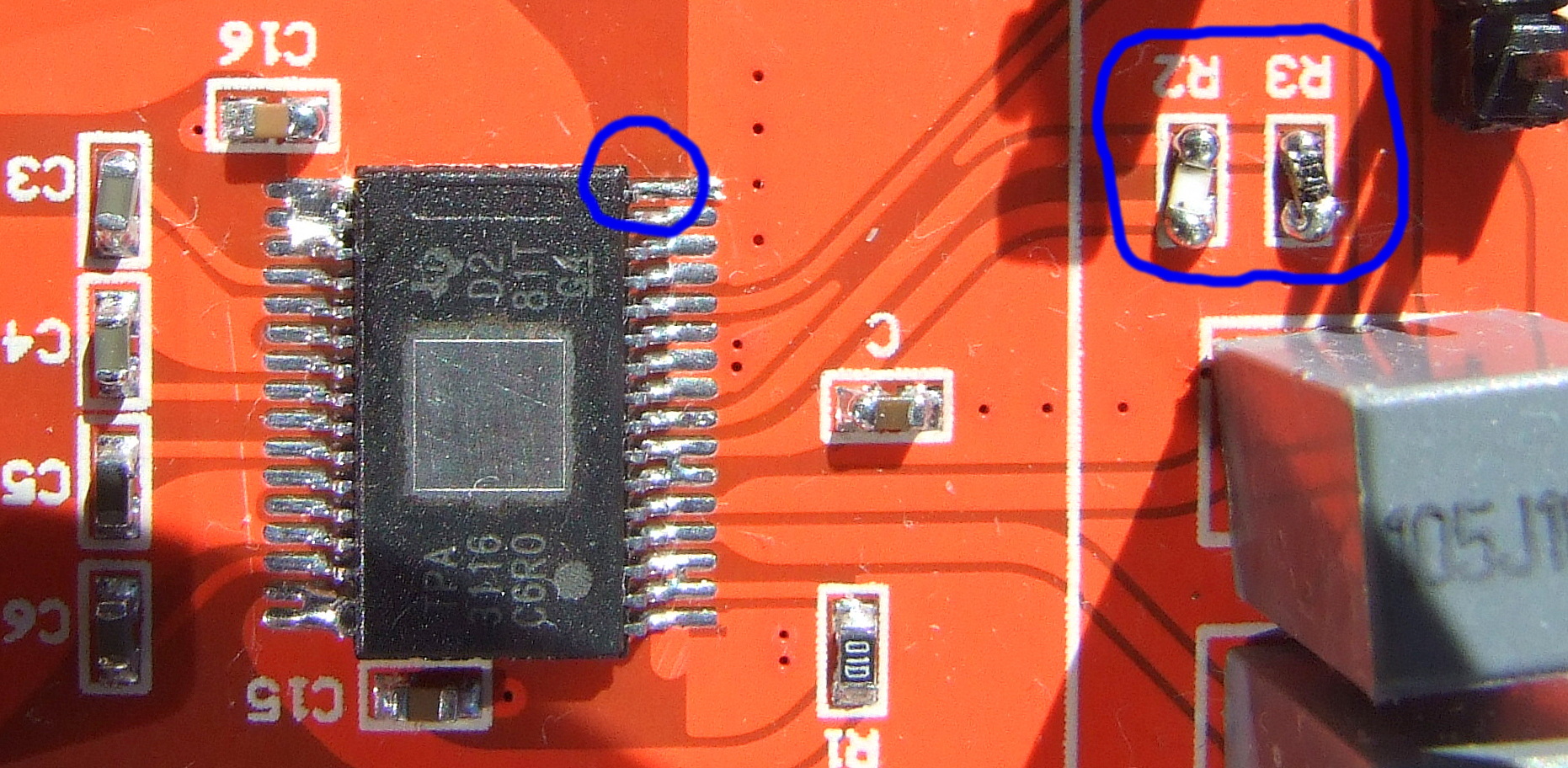

42 degrees Celsius hints a problem with a too low switching (carrier) frequency. With a multimeter (without amplifier power), measure the value (approximately) of R2 and R3. If R2 has a value less than R3, the TPA3116 is most likely set up as a "slave" and the frequency is too low. In such case, I suggest you to swap the two resistors around and cut pin 16.
your dutch as well? => groetjes
On both versions of the boards R2 measures ~ 43k and R3 ~100k so this is the case. I will mod. 1 board and report the temperature back. Thank you and "groeten terug"
I did the mod and temps of the coils and heatsink seem to settle at 25C now after 20 minutes.
It looked so easy from your picture on my huge computerscreen; but I managed to get them on ..... hope they don't get any smaller, or maybe drink more next time; for a steady hand. 😛
Thank you very much, I will mod my other boards. I suspect all these boards have this problem, not just yours and mine.

I actually find it is a fine board (when corrected). What is weird is why it includes two obvious mistakes. The mistake with the resistor values causing it to be in “slave”-mode could be a mistake in production. But, running a batch with a repeated component value error is seriously negligent. Why the “SYNC”-pin is grounded I simply do not understand the reason for. Configured as “master” it is an output and should not be short-circuited. Configured as a “slave” it is an input but expects a clock for synchronizing of the switching frequency. It must be a misreading of the datasheet or a PCB layout error.
Yes, also I do not like working on SMD resistors. They stick to the tip of the soldering iron. And, these two resistors are even not among the smallest you find.

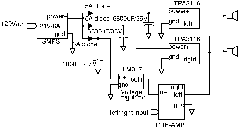

I was trying to follow your advice. I need a correct schematic for the decoupling board for running one 24v 6a power brick with 2 mono TDA3116 boards. A full schematic with preamp and and buck convertor power would be great also, but I really didn’t notice much of a difference between my dual NE5532P preamp and straight from an iPod. I’d rather build one than buy one and guess at the quality of the components or stability of the circuit.
It is almost midnight here in France. I will draw it tomorrow and post it. Your TPA3116 mono boards, are the power line decoupling capacitors rated for 25V or 35V?
Hi “1152”,
My suggestion for the system.
The three 5A diodes (ordinary silicon) serve to decouple the other units from the supply rail if one unit suddenly pulls a lot of power.
I would use a linear LM317 based voltage regulator and not a step-down Buck converter because the pre-amp consumption is low and the linear regulator has less noise.
Try without a specific “-”-wire between the LM317 voltage regulator and the pre-amp. Your signal ground, connected to the two TPA3116 modules, will provide the connection. I am afraid you may form a harmful ground-loop if you also draw a specific “-” power wire.
You write: ”I really didn’t notice much of a difference between my dual NE5532P preamp and straight from an iPod”. With a perfect pre-amplifier, the output sounds exactly like the input (your Ipad). Nothing is changed. Did you mean that the sound level was the same with or without the pre-amp? In such case you may increase the gain in the pre-amp.

Yes, a bad hum happened before. Would this be like a virtual ground?
My preamp is basically a “Classic 47” headphone amp with only a volume potentiometer. 12v battery power to avoid noise. The gain is set before clipping when the volume is turned to full. I may or may not build a better preamp. What would you suggest?
