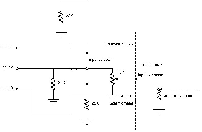

22k resistors to ground? What do you mean? Have you got a schematic? What do they do?
If the smps' won't take the capacitance, I could always just use a 230/24VAC trafo and a Graetz, right? Bulkier and less sexy🙁
The 22KOhm resistors serve to bias the output capacitors in the sources correctly (so you don't have a "plop" in the speakers when you change source) if the sources have not already solved that problem.

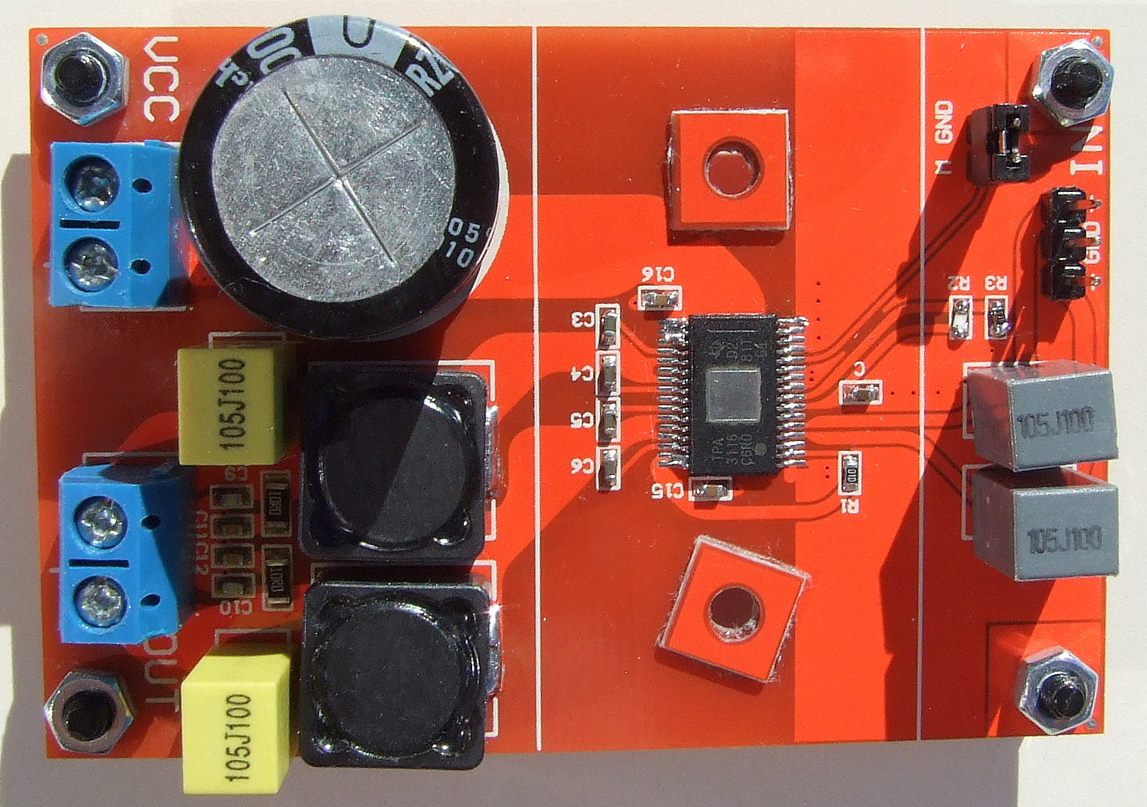

Issues with the read mono TPA3116D2 PTBL amplifier board.
Recently I had to test a 24V SMPS for continued operation after repair. I used my red mono TPA3116D2 board (PBTL) as load. The 24V supply worked well but I noticed some important issues with the TPA3116 board.
After operation for about an hour, the output filter chokes became pretty hot. That is unusual compared to more other TPA3116 boards I have, also running PBTL.
I did not know the 10uH filter chokes so I changed the chokes into a type I know, assuming the heating could be due to excessive core losses. The change only improved the situation very little.

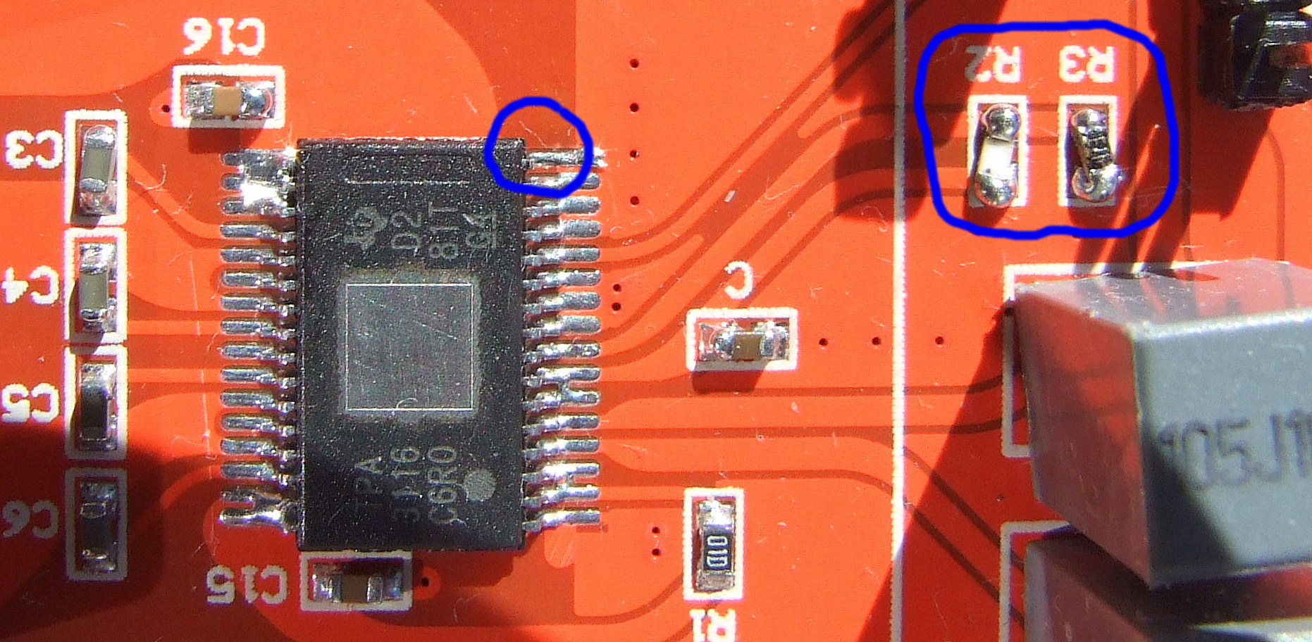

I put my oscilloscope on expecting that the operational frequency would be higher than normal (400KHz). Actually, with only 120KHz the operational frequency was much lower than normal. Realizing that the operational frequency is set by three chip input pins (AM0-AM2; pins 13-15) only and they were all grounded for 400KHz, I concluded it had to be a chip error. I changed the TPA3116 chip but even with the new TPA3116 chip, the frequency remained 120KHz.
Then, I studied the layout and concluded that pin 16, “SYNC”, was grounded. In “master” configuration, the SYNC pin is an output. Strange.
Following, I looked at the operational settings for master/slave and gain (two resistors described in Table 1 of the datasheet). With in-circuit measurements of the resistances, it seemed the configuration was “slave” and 36dB gain. I swapped the two resitors (R2 and R3) around on the board. Then, I had a the correct 400KHz operational frequency.
It seems that a number of these boards have a PCB error such that the SYNC output is shorted to ground while it should be left open. And, at least for the batch of which I have an item from, the two setting-resitors (R2 and R3) have been chosen wrong such that the amplifier is operating at an idle frequency of 120KHz and configured as “slave”.
If your chokes on that 3116 board tend to get hot, check if you also have a 120KHz operational frequency. If so:
The board has now been tested for more than an hour at 24V and all appears normal like my other TPA3116 boards.

- Cut pin 16 on the chip such that there is no longer a connection to gound and pin 16 is open,
- Swap the two resistors R2 and R3 around or remove R2. (R2 on the board corresponds to R2 in Table 1 (datasheet) and R3 on the board to R1 in Table 1.
