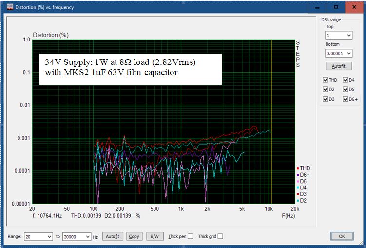

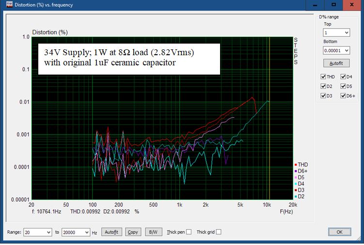

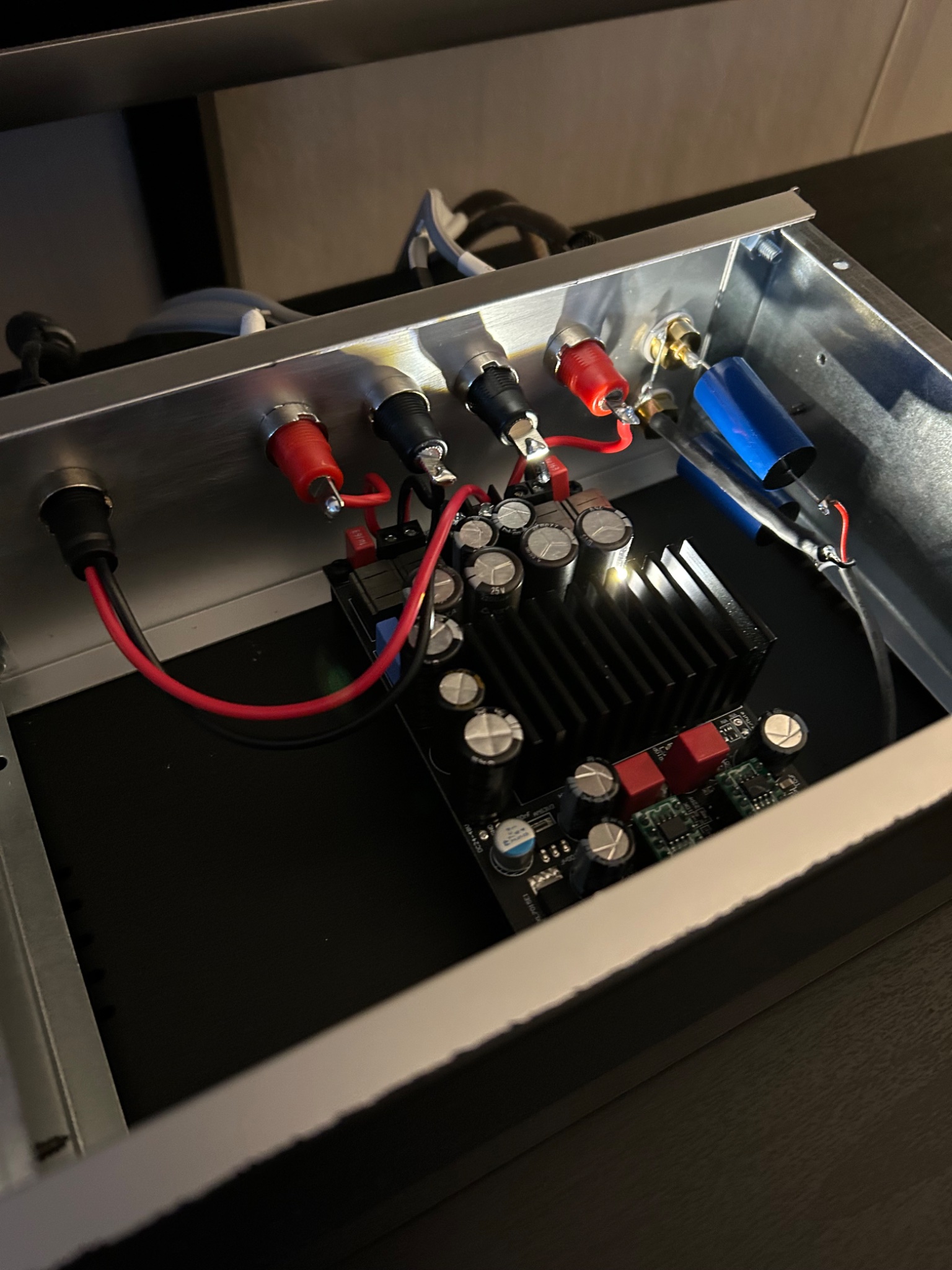

4 Wima:s 4,7 uF has replaced the 4 Elna capacitors right before the tpa chip. They were 2mm to thick to fit in a row so two of them is mounted below the board.
The 4 output ceramic caps are replaced by 4 Wima mks2 1uF ( two of them below the bord . This lowers the distortion significantly above 2 kHz with this board ( Audiogues measurements ).

It's so nice to see bold claims backed-up by actual measurements. 😊

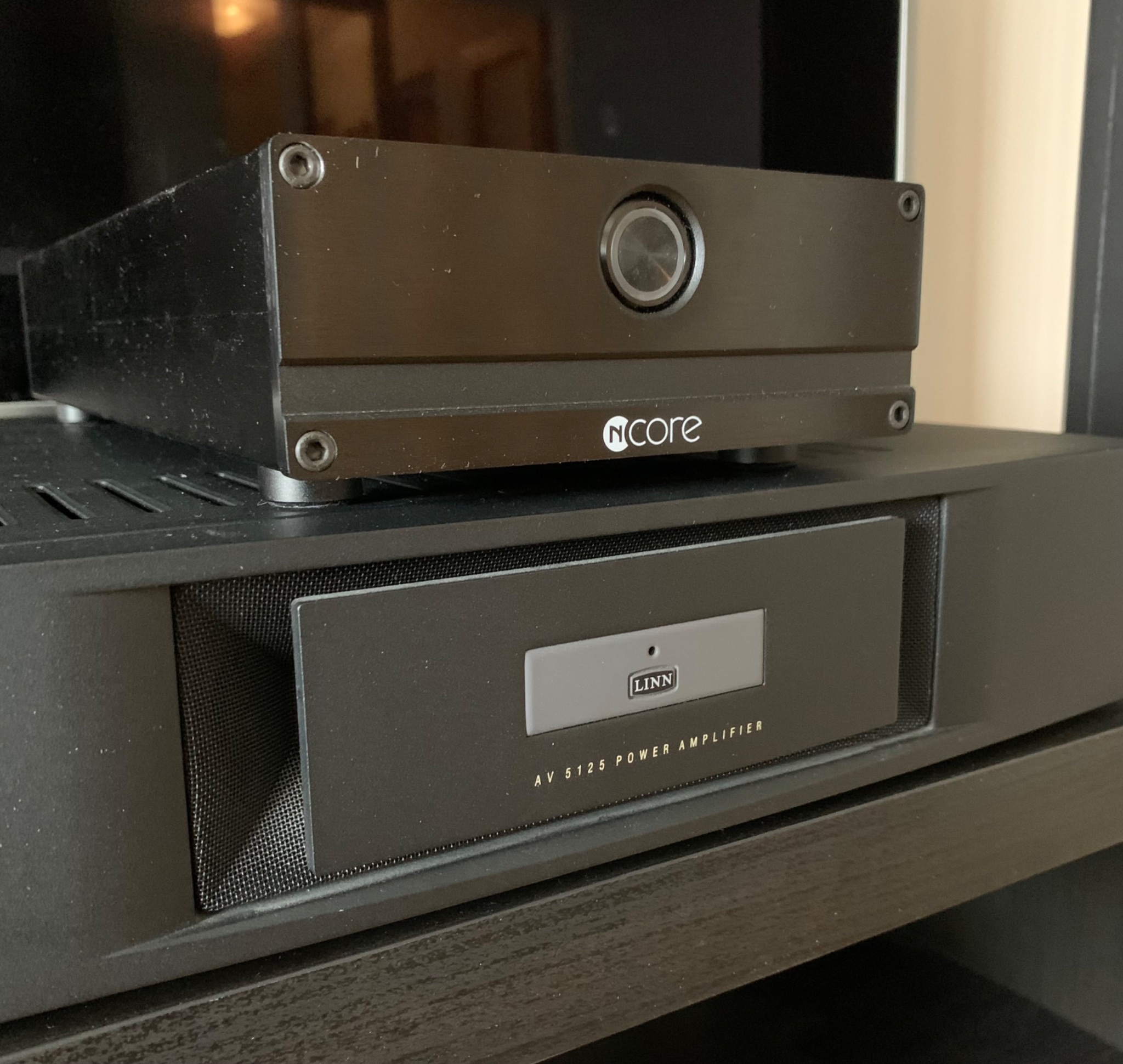

I did a comparison recently , before the last mod.
The hypex ncore 125 and Linn 5125 are very similar in the bass - they are both very good and you get a bass thats easy to follow , soundstage is bigger on hypex ncore , deeper and wider and the 5125 is slightly brighter in the treble, but at the same time not as clean sounding
The tpa3255 with 36V supply and opa1612 sound more punchy, have even better bass thats even easier to follow, very exact soundstage where every instrument can be pinpointed , the treble is better than both the 5125 and ncore, more open than ncore and cleaner than 5125.
Its more fun to listen to the tpa3255. The musicians are there in your listeningroom right infront of you.
The ncore and tpa3255 is dead silent even when having your ear right next to the speaker , with 5125 you can hear a silent noise.
I havent heard many class A/B amplifiers regardless of price thats better in playing bass than ncore, 5125 and this tpa3255. Most amplifiers cant articulate the bass in a convincing way.
