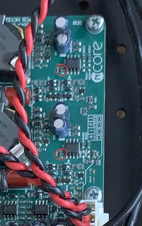

Jean-Paul, I wonder If its as easy lowering the gain on this board as it is easy to lower the gain on Hypex ncore 125 ? In Hypex, all one has to do is to desolder 2 smd resistors , lowering the gain about 13dB leaving the buffer at unity gain. The soundquality with this mod made the sound slightly better.5 or even 50 Minutes is by far not broken in. Takes at least a few hours, possibly days. Opamp rolling should be done when it is broken in and then giving the opamps also enough time to settle. Multiple day venture normally.

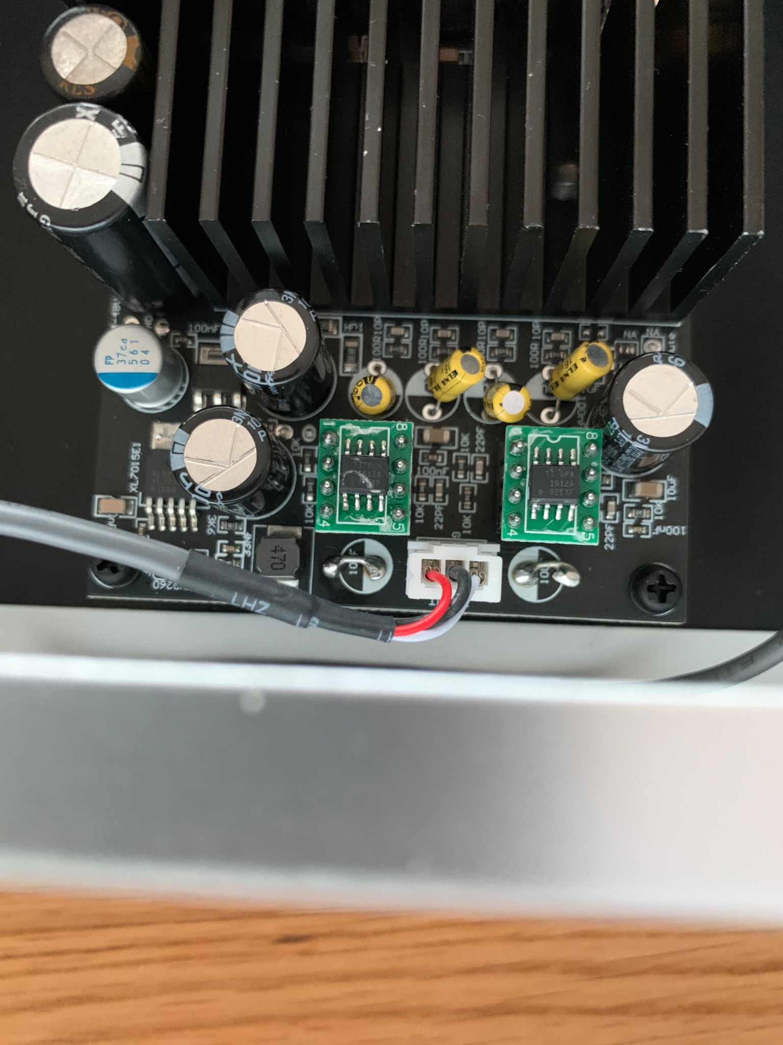

Can one do the same with this board ? I guess one half of the ne5532 is amplifying the signal maybe 15 dB, ( unessessary ) and the other half is doing conversion to balanced signal to feed the 3255 chip ?
Picture show the gain mod on my Hypex amplifier - those two smd resistors are simply desoldered to lower the gain about 13dB. Makes it perfect to drive with my Rega dac.

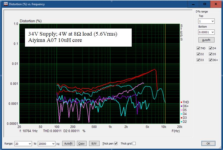

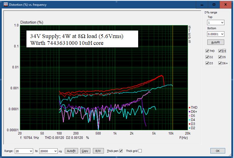

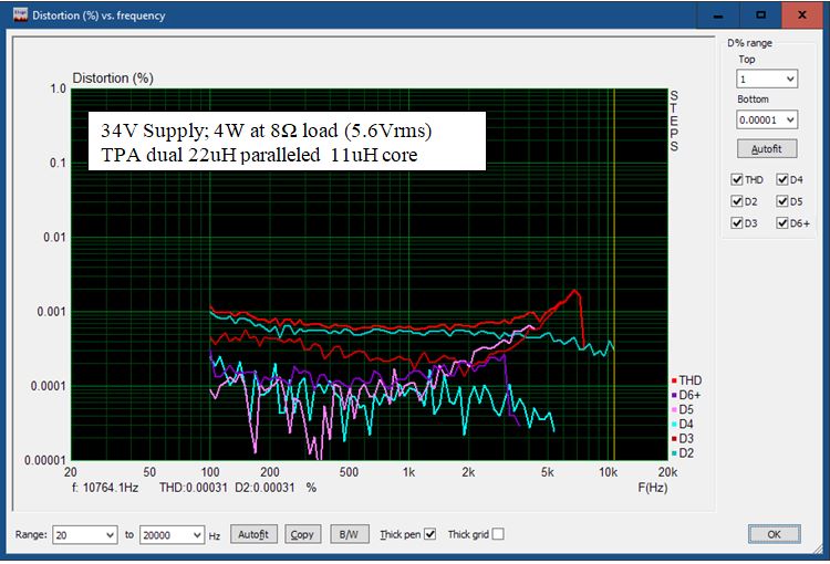

About the output coils on this board , according to Audiogue they are really good . They are paralelled 22uH per channel= 11uH with very low resistance. They are better than the original coils inside the Aiyima a07 , and about as good as the expensive Wurth.
”The dc resistance of the dual core paralleled to 11uH is only 11 mOhm and they seem to be flat copper wire type”

I forgot to mention that the inductor saturation current is at about 10A in the 11uH configuration (Würth indictor 22A). This is also fully akzeptable.
My post was addressed to people which have this board and plan to exchange the cores. In my opinion this is not necessary due to the electrical good data and measurements. The sound was improving with these cores in Aiyima A07 and has not notable changed (or further improved) with the Würth cores).

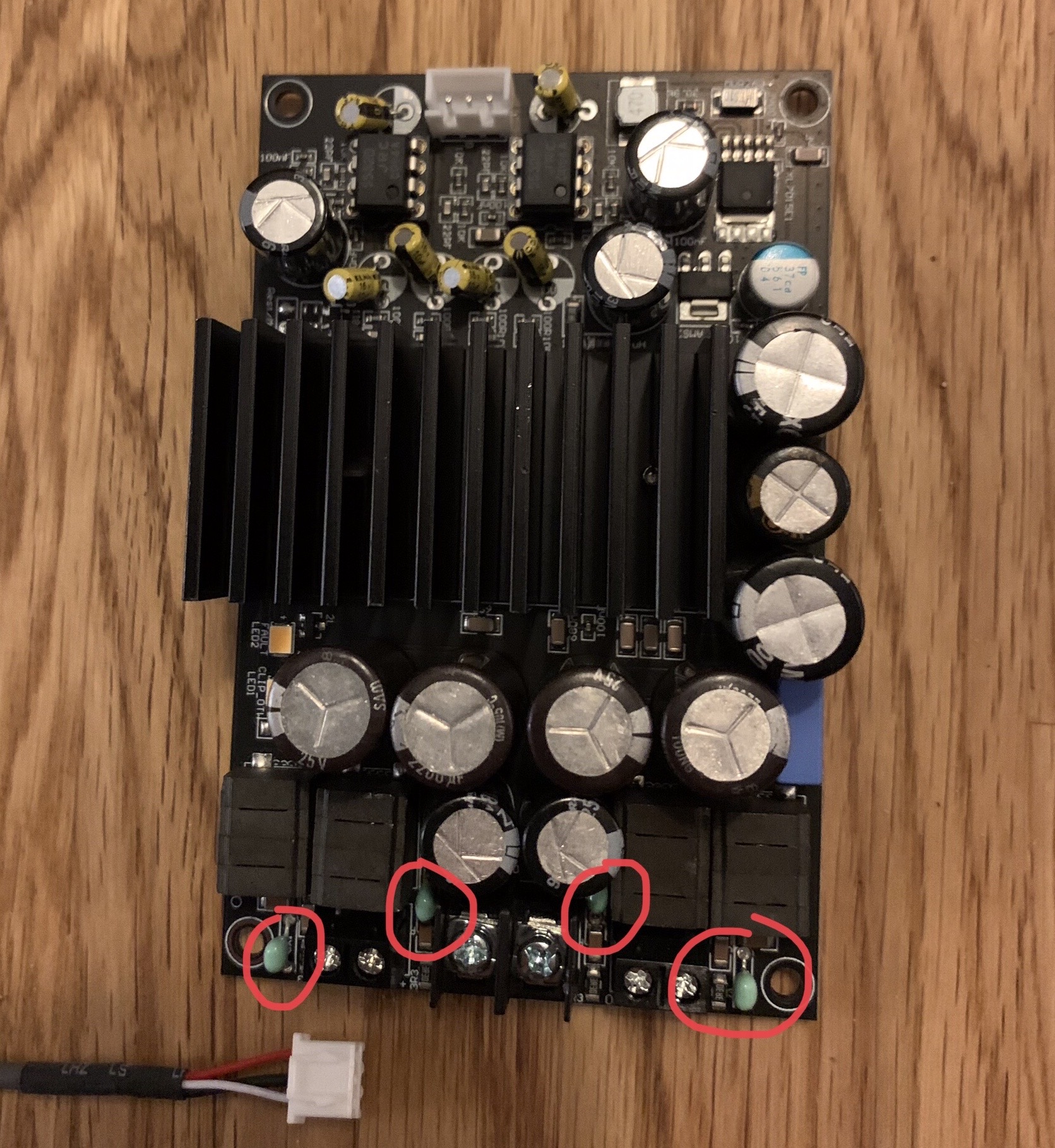

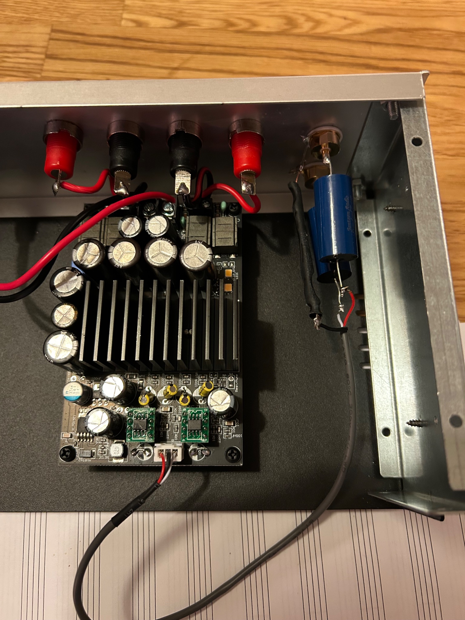

This tpa board has some surprises. First, we have the power capacitors, some of them coupled in series making them have higher resistance than paralelled. Then we have the output coils that are paralelled making them having very low resistance and apparently low distortion with saturation at 10A.
Those 4 output caps has to be replaced with 4 WIMA 1uF 63V, lowering the distortion above 2 KHz ten times.
Usual practice with chinese boards. X7R already being too costly.

Yes, but only If the IC before the 3255 is a unity gain buffer . Those Chinese boards often has some gain in the preamp, for unknown reasons . I can take my modified Aiyima a04 tpa3251 as an example. Almost as they expect that the source will give less than 1V out…
After 1 day burn in the sound has clearly changed for the better .
Continuing modification - bypassing the two Elna 10uF caps at the input. My rega dac R RCA:s output is free of DC , being digitally driven by my WiiM ultra, so this can be done.
The sound went clearly better, so now I must replace the 4 Elna:s before the tpa3255 chip with some WIMA capacitors. This will be easily done cutting the elna:s and solder the new wima:s below the board.
The sound is now, in some areas, better than my Hypex ncore. Im talking about bigger soundstage and more open above 6 KHz . Maybe Im fooled by the outputcap distortion ( they are still original )

You can use 4 WIMA MKS2 1uF 63V polyester capacitors and solder it under the board , just cutting the replaced caps , price below 1 dollar each. Those capacitors was what Audiogue used, and the ones I have bought on audiophonics .I've also thought about replacing the capacitors on the output, but the problem is that a good quality polypropylene WIMA capacitor has a leg spacing of 22.5 mm, and I'm afraid that longer legs (because I could only install the legs bent and longer on the bottom side of the panel) would cause some problems (due to the high frequency), and I don't have an oscilloscope to check if everything is ok.

Jean-Paul, you’re right . But it might be a risk if it’s hard to unsolder the replaced component from below , possible destructing the board if the soldering used on the board is only melting at very high temperatures .
I have no clue if that’s the case here - but my modified Aiyima a04 was a little tricky .
One can try unsolder the original capacitor with a careful hand using desoldering braid and not using very high temperatures. If it goes just fine - do it and mount the wima capacitor through the hole on the upper side of the board, soldering below the board .
IF they are hard to remove (I doubt that) then cut the lead wires from above and destroy the cap, just leave 2 mm of both lead wires sticking out. Heat the pad and then either desolder and pull the lead wires out with tweezers or push them out with a stainless steel needle while heating up. The solder does not stick to the needle. Clean the PCB with isopropyl alcohol and a cotton swab.
The OPA1612 modules have debris and should also be cleaned with isopropyl alcohol and a cotton swab. ESD safe.

I took Jean-Pauls advice to use coupling caps at the input. I had two 3.3 uF polypropylene capacitors and used a common ground for both channels The sound is much better than with the Elna caps, but slightly worse than without caps, but its a very small difference - I can live with this. Soon, my 4 Wima 4,7 uF will arrive and I will desolder the 4 coupling caps ( same elna as input ) for the tpa3255 , expecting even better sound .
