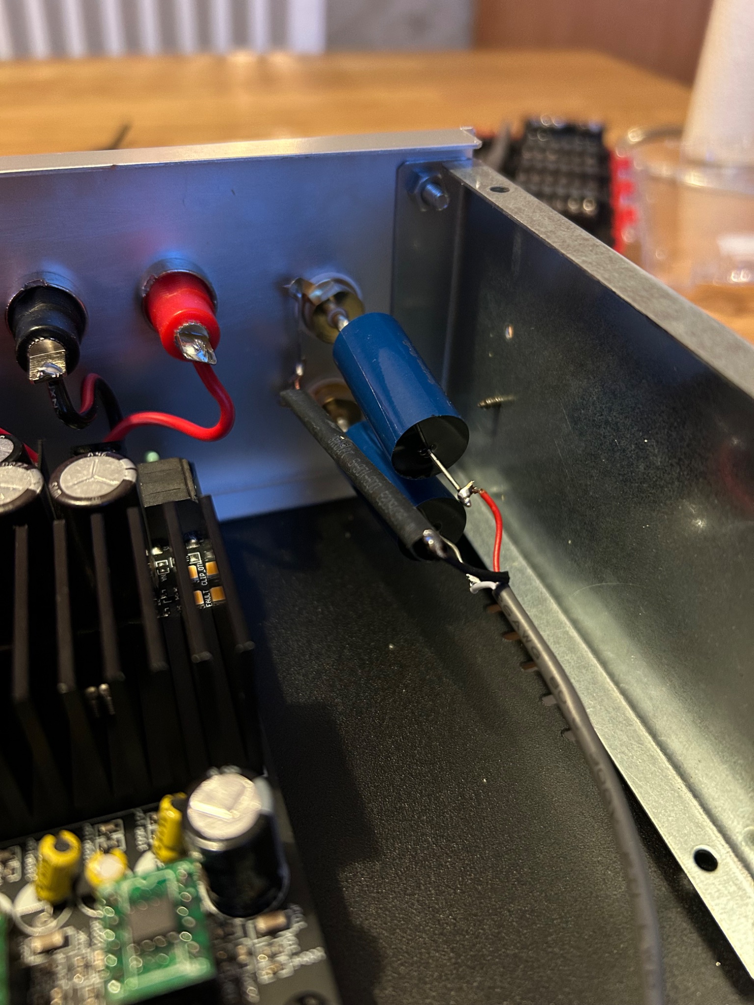

Just try out connecting the casing to PE with a switch.Strange thing is, when I put back the lid on the amplifier the sound turns a little less bright and more clean, the sound of less RFi.

My power supply is external without earth wire.Just try out connecting the casing to PE with a switch.
It’s like a class II device .

Still you can try out. There are no class II DIY devices anyway 😉 So just the box. Experiment of a few minutes.
Yes RCA isolated from box. If you connect the box via 10 Ohm to GND you’ll have a nice antenna.

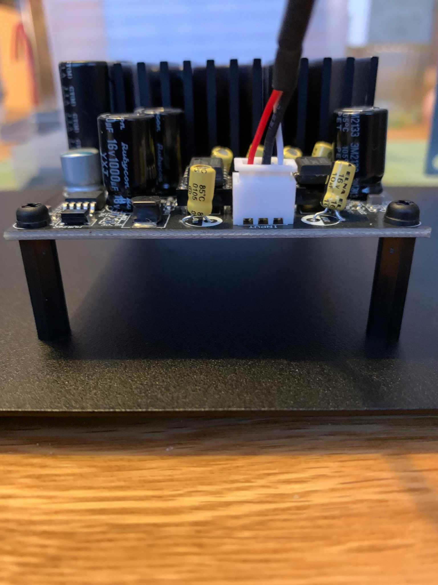

Is the board technically grounded to chassis through the fasteners?
^^what jean-paul said^^

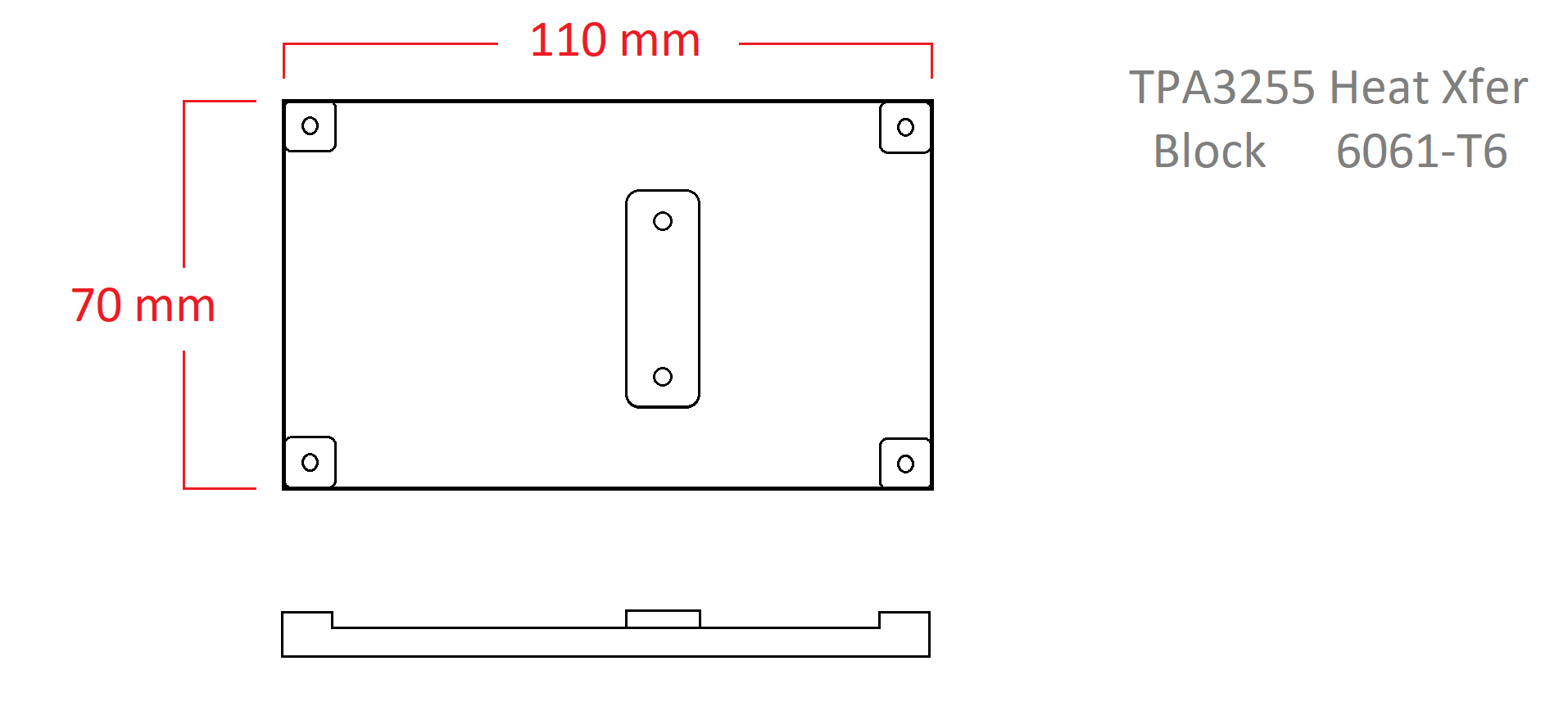

When I was initially planning the A07 build, I intended on adding a base heat-sink plate to the bottom, but was not 100% sure of any grounding issues, so I just mounted the case vertically for air flow. I updated the drawing for your 3255 board as I can pick up one of these and experiment too....
