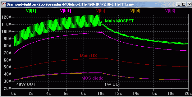

Hi Pawel,
Sorry, my last post subcircuit was forgotten in the zip. The missing ones are in the latest one below.
This one shows heating up from idle with 40W, then change at 10s to 1W and it cools. It is the version for 8 ohms and includes electrothermal models for the main MOSFETs and the MOS-diodes (4 MOSFETs). Sorry about the clutter from the thermal model bits. M4 is coupled to M3 via Ts3 label, likewise M6 is coupled to M5 via Ts5 label, and M3 and M5 are not thermally coupled (but the could be linked by changing the labels). The thermal resistance for cooling M3 and M4 is 50C/W, assumed to be that of two TO-220's coupled together.
This show the thermal time constants in the main MOSFETs and the MOS-diodes. The idle current (t=0) is 295mA, t=1s is 318mA, t=10s is 347mA, t=11s is 325mA, t=20s is 301mA.
With 40W, once the heatsink reaches final temperature the crossover current is 50mA more than at idle, the HS rise is 17C from idle. About half the current change occurs in the first second.
The FFT was plotted for the first 5 cycles from t=0, 1s, 9.5s, 10s, 11s, 20s. There is a check box for the in the FFT dialog.
At t=0 40W the dominant harmonic is -70.9dB, then at t=9.5s it is 70.8dB so the increase in idle current is not causing more distortion.
At t=10s 1W the dominant harmonic is -98.5dB, then at t=20s it is 93.7dB so the increase in idle current from 40W reduces the distortion compared to after the heatsinks cool back to their normal idle current of 295mA. This is because an idle current of 295mA is "under-biased", deliberately to reduce the idle heat to a "reasonable" level.
BTW The "optimum" idle current for this output stage is relatively high because there are effectively no source resistors (the MOS diodes have only about 20m Ohms of resistance, much less than the usual 200-300m Ohms.)
In this simulation I have used guestimate values for the thermal properties of the MOS-diodes. They are not on a heatsink, just back-back with a thermal pad. Once bench measurements are made the thermal linkages can be updated for real life simulations. In the mean time we can see the general effects such as thermal lag in the MOS-diodes and the effect on distortion.
BTW D1 and D2 are added across the MOS-diodes so LTspice can find the correct operating point. They do not normally conduct in this circuit and are (probably) not needed in a real circuit.

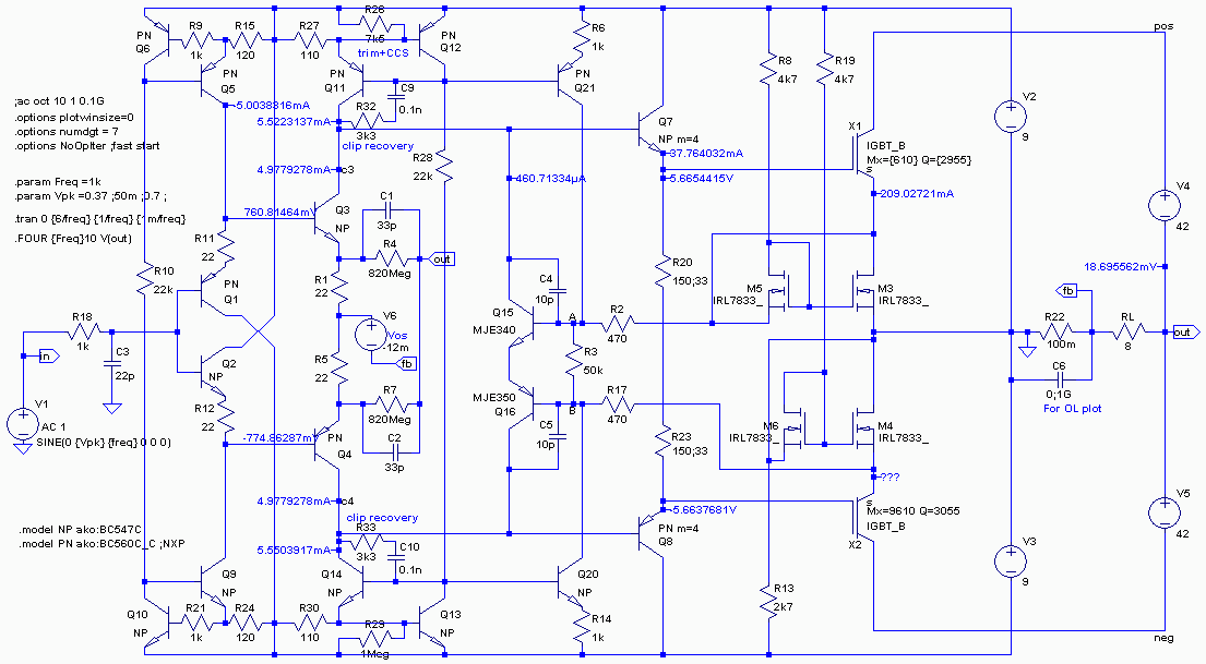

Autobias versions
Hi All,
Here are the autobias versions for BJT and MOSFET power transistors (below):
What's changed? The spreaders (Q15,Q16) now have current sources for setting their operating point rather than the feedback resistors used in a Vbe multiplier (see Post 83 above R6,R16).
To get the autobias to cover the full output current range several CCS conditions need to be met. Q15,Q16 are operated at 100uA by R6,R14. Then R3 and R14 are chosen for the idle current. Then R28 and R30 need to supply the same current as to the input stage (Q5,Q9) plus the 100uA to the spreaders.
Also, to get autobias to cover the full output current range the minimum idle current depends on the choice of MOS-diodes; the lower their Ron the lower the minimum idle current. For the MOS-diodes used here the minimum idle current to cover the full output current range is about 200mA (for about 38V peak or close to 100W into 8 ohms).
When the CCS balance conditions are met the MOSFETs can be swapped for BJTs (and once the base-emitter resistors are lowered and the compensation is changed to suit the BJTs) then the autobias circuit automatically gives about the same idle current -- and that's without altering the CCS balance😎. And notice there's no trimpot for the spreader (which was a Vbe multiplier but now an autobias loop).
The MOSFET and BJT versions are in the attached files so you can see the idle currents are about the same for the BJT version as for the MOSFET version without changing the CCS balance conditions and without a trimpot.
In a practical version of this amp there will probably need to be a trimpot somewhere to get the CCS balance about right. But there doesn't seem to be any need with this autobias amp to operate at an optimum idle current for minimum THD because the wingspread curve is fairly generic and fairly insensitive to the idle current.
The main requirement is to get the autobias to cover the full output range so it doesn't create a sudden gain change (near full output swing) if the common-mode feedback for autobias loop stops. But we knew autobias is living dangerously😀 (see Post 1 an a few of the early posts).

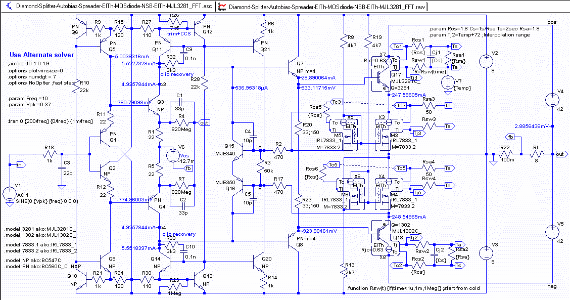

A few performance figures for this autobias version:
BJT version f-3dB 1MHz, MOSFET 2MHz (as per attached files).
SR both 38V/us and OK to 200kHz full output with no cross-conduction and above 200kHz the crossover collapses (which is nice and safe😎).
THD at 1kHz 50W 0.04% BJT and MOSFET 0.013%.
THD at 1W 0.005% BJT and MOSFET 0.007%.
Idle current and THD don't change much with ambient or power transistor junction temperatures.
This provides, after a fairly long journey, a wideband autobias topology that is not overly complex.
Admittedly it's a bit tricky to set up the CCS operating point but it's early days. After building several amps we may find the best way to get it to work first try. Here's for hoping😉.
BTW the above amp is configured for current drive amp with R22 in series with the load for feedback and with R4 and R7 disabled.
For a voltage drive amp short this resistor and reinstate R4 and R7 back to 820 ohms.

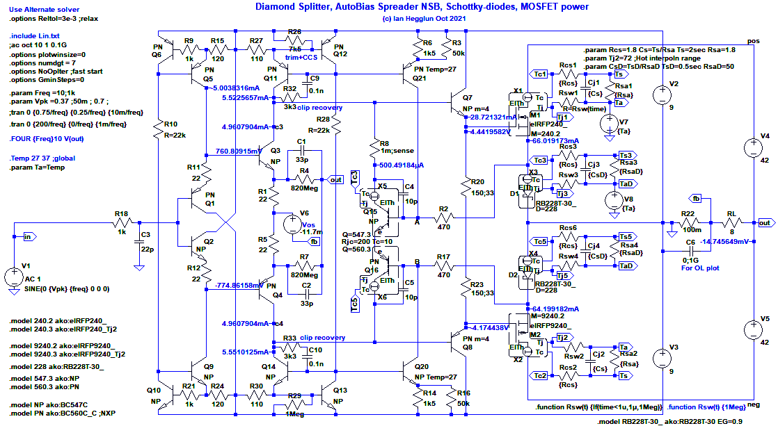

Autobias with Schottky's
This version is similar to the previous one but the MOS-diodes are replaced by Schottky diodes.
Since the Schottky diode temp-co is negative (opposite to MOS-diodes) the Schottky diodes must be thermally linked to the spreaders to prevent thermal runaway.
The circuit below is thermally stable - starting cold at 66mA and ending at 73mA after 50 seconds. The crossover current peaks at 2 seconds at 95mA which is acceptable.
Using Schottky's rather than MOS-diodes allows autobias to operate over the full output range down to 60mA (was 250mA) because the dynamic resistance of the diodes is lower than the MOSFETs as diodes. The advantage of MOS-diodes is thermal coupling to the spreaders is not needed.
The Schottky diodes have a thermal resistance (Rsa) of 50C/W which is effectively just a TO-220's on a PCB (no added heatsink). Thermal coupling to the spreaders (Q15, Q16) is Rjc of 200C/W with time constant of 10 seconds which I have used for a TO-92 thermally coupled to a TO-220 Schottky package (a guess until bench tests - such data is hard to get from datasheets). With about 30W output the Schottky's temperature rise above ambient is 15C, while the main heatsink used here rises by 40C above ambient. So the Schottky's should run cool even without their own heatsink. But mounting the Schottky's on the main heatsink seems to be detrimental. You can check this by editing "Tc3" (in 2 places) and "Tc5" (2 places) to "Tc".
There's a lot more that I could explain about the electrothermal subcircuits but that is best covered in another thread. For now feel free to ask questions in this thread. One thing is the ".param Tj2=72 ;Hot interpoln range" card. I have had trouble with LT-XVII when Tj2 is set above 80C (it wont start). But this setting is not an issue with LT-IV which I use. This parameter sets the valid interpolation range for the subcircuit and should be set to the highest likely junction temperature during the run.
The sim still works in LT-XVII if the junction temperature exceeds this value but then it is extrapolation which is becomes less accurate (but still useful).
Since Mike Engelhardt is no loner actively fixing problems with LTspice I'm not expecting this issue to be fixed. So if you need a high Tj simulation (above 150C) then use LT-IV. And if you want the latest model updates in LT-IV then copy the latest LT-XVII libraries across.

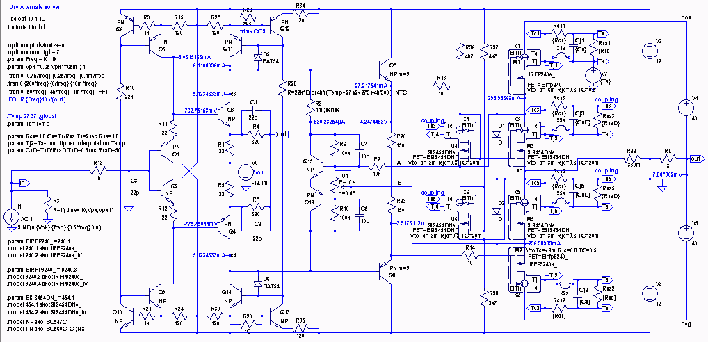

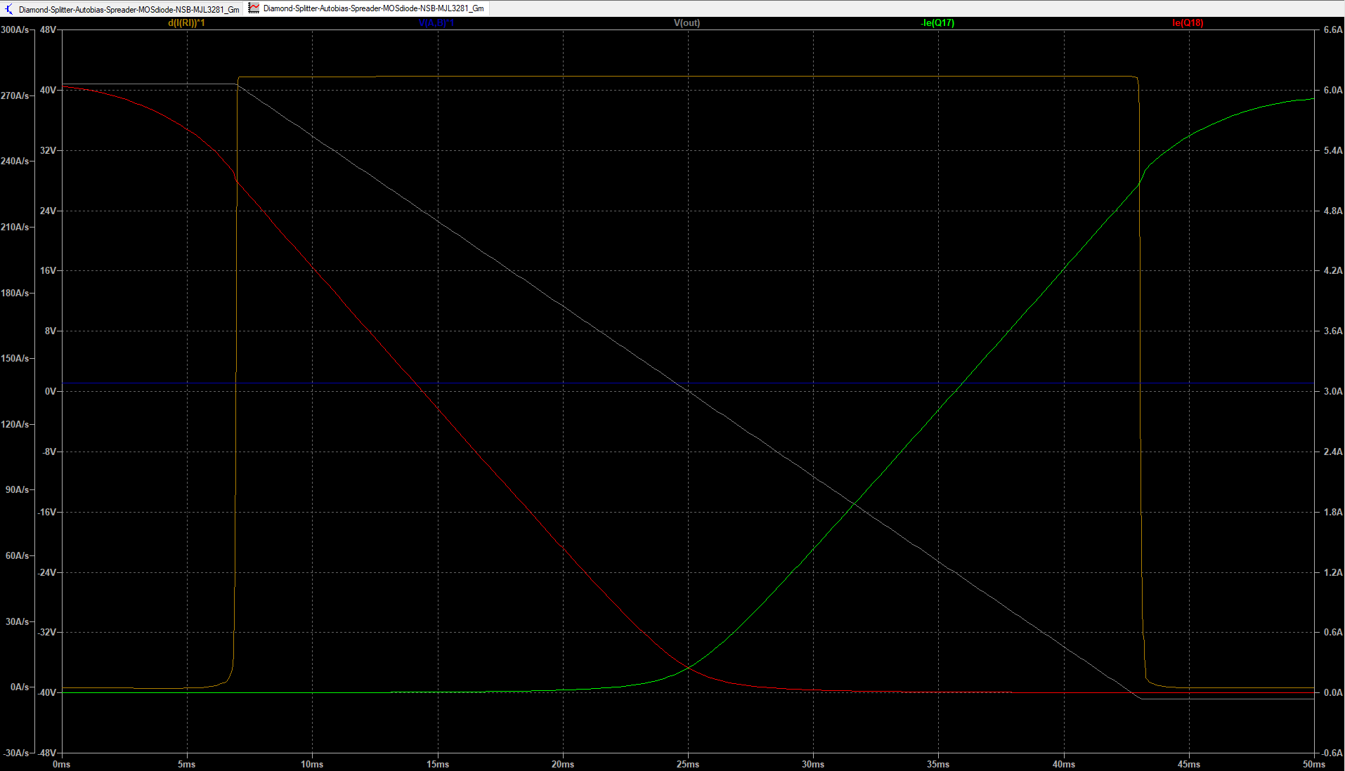

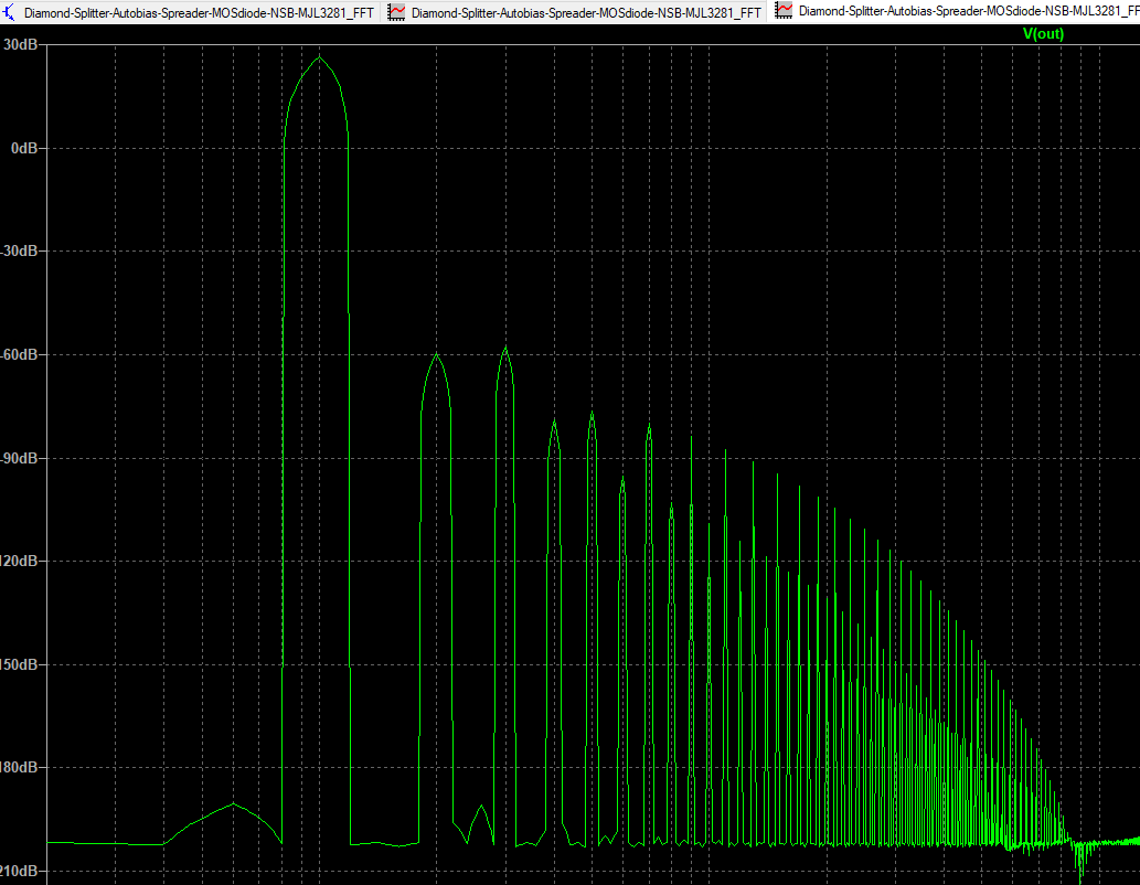

Bug fix and Update
Hi All,
For the previous electrothermal simulations I found a problem with switching a resistor from 1u ohm to 1Meg. Probably not a bug but a dynamic range issue (even with double precision and the Alternate solver). Changing the switch to 1m ohms and 1 Meg allows it to find the operating point in most cases and is faster starting.
The resistor switch is used to clamp the RC thermal model to ambient to disable the electrothermal feedback so the operating point can be found, then the transient simulation can start and after 1us the switch opens and the electrothermal feedback become active. You can select an alternate switch that is stuck on 1Meg so you can start at the warmed up idle temperature. But sometimes LTspice can't start because it can't find the warmed up operating point. (If that fails you can find the warmed up operating point by starting cold and doing a run with no input signal).
I also found a bug in my electrothermal MOSFET subcircuit for the gate voltage temperature coefficient - it is now referenced to the MOSFETs 'Tnom' value (usually 25C from datasheet plots). The attached electrothermal files have the updated subcircuits - delete or over-write any earlier ones you may have downloaded.
Attached are the updated electrothermal files for the previous Schottky diode autobias method.
Also attached are the electrothermal files for the MOS-diode method with autobias. Circuit below shows the electrothermal sim for BJT power transistors (Q17, Q18) and MOS-diodes for autobias.
The idle current from cold is 250mA and during heating at high output power the crossover current stays within about 10mA of this. Also changing Q17, Q18 to MOSFETs without changing any idle current settings (apart from the Locanthi resistor), the idle current is 220mA. Proof the Autobias loop operates as expected. Notice it does not use emitter/source resistors - the MOS-diodes eliminate them and they do not get hot, even without a heatsink.
Using MOS-diodes rather than Schottky's makes the idle/crossover very temperature stable. One thing not yet determined are the time constants when the MOSFETs are thermally coupled. The time constants I used are deliberately shrunk so the simulation does not take weeks to reach steady state (like 99% of the final values). I shrunk the heatsink time constant from about 2000 seconds to 2 seconds and the MOS-diodes to 0.1s so steady state can be reached in 20 seconds real-time, which takes around 5 minutes on my PC.
This completes the initial phase of this thread - a wideband non-switching autobias power amplifier that is thermally stable without emitter/source resistors, and robust, and not too complex. It clips cleanly and gracefully handles any RF input at full power without cross-conduction issues. It can use power MOSFETs or BJT's interchangeably.

Hi Ian!
unbelivable!
wingspread is so acurate, hf harmonics at full power are descending so quickly!
unbelivable!
