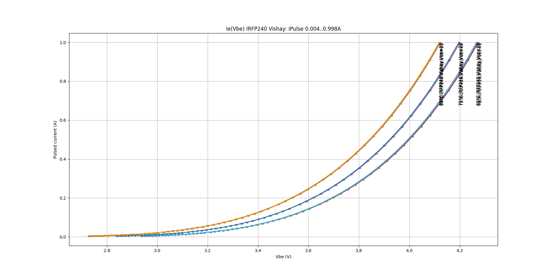

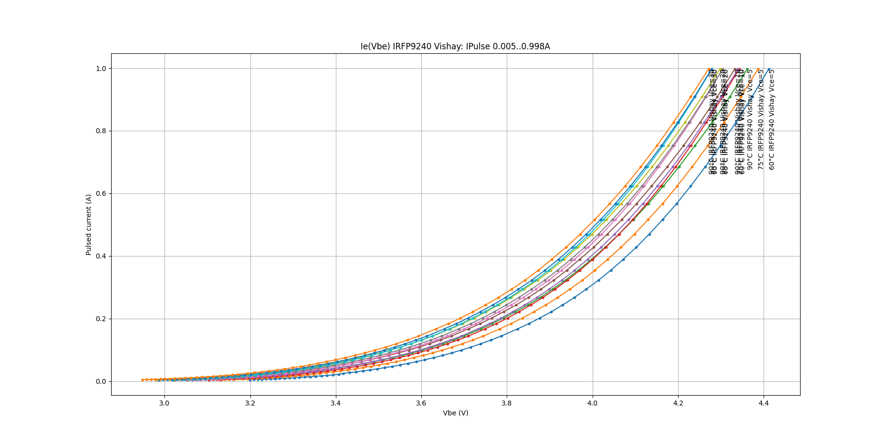

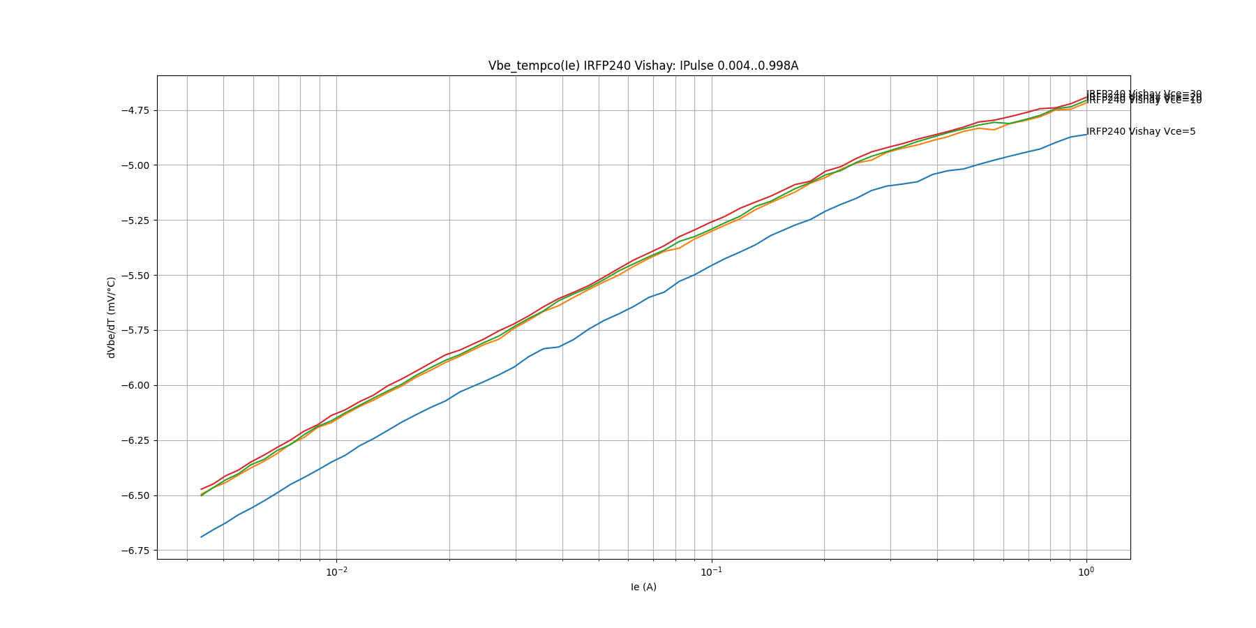

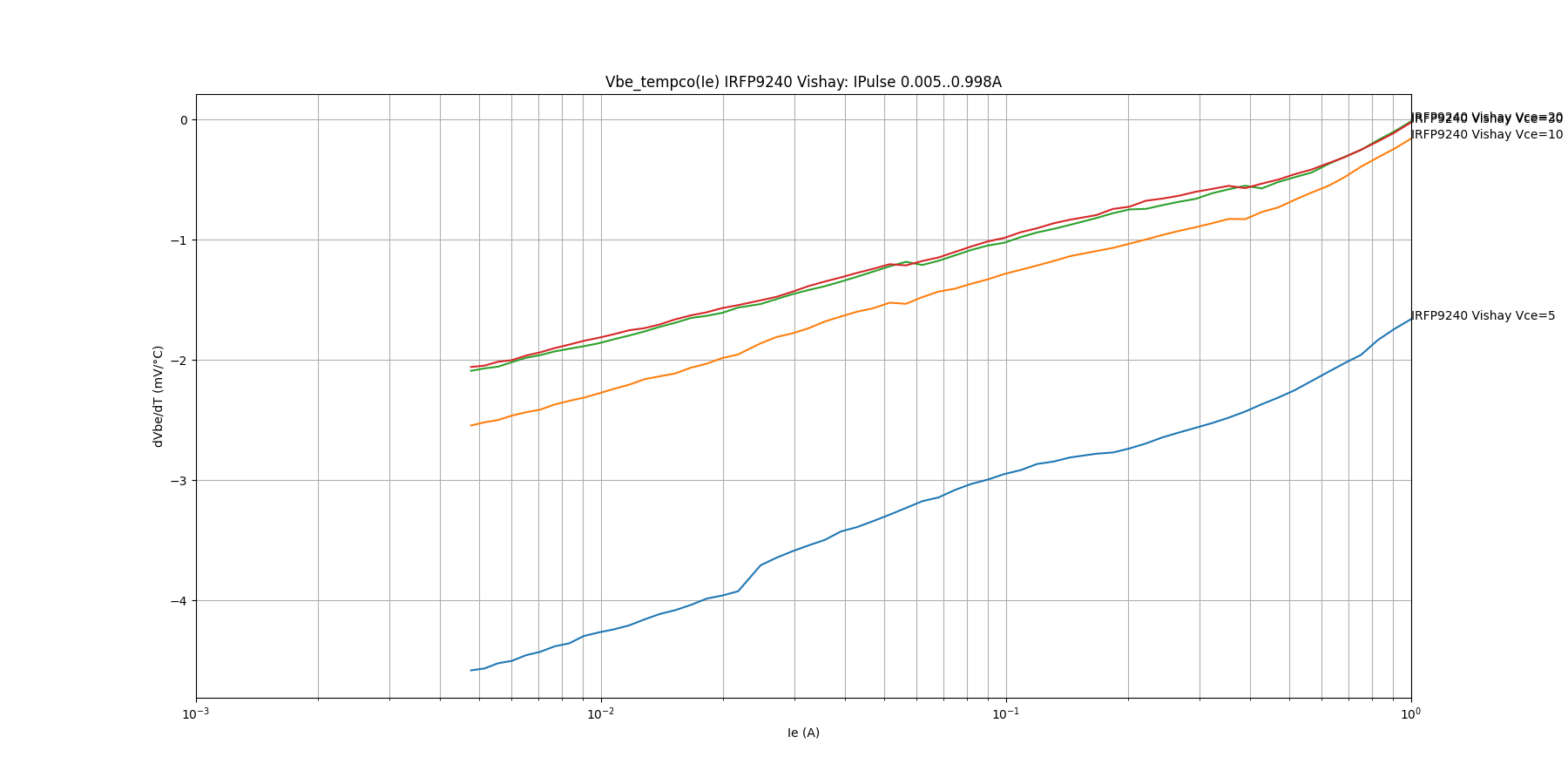

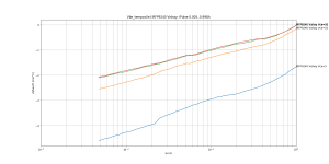

MOSFETs still have wide variations in the wingspread curves with junction temperature changes due to music power variations. Also startup of amp.
Tj only changes threshold voltage (see attached graphs), so changes in temperature are equivalent to changes in bias current setting of the amplifier. Since there is no gm-doubling with FETs using reasonably low source resistor values (<=0R15) and bias current, bias drifting higher when it gets hot isn't a problem: on the contrary, it reduces crossover distortion.
Placing the temperature sensor on the center pin of TO-247 package, which is internally connected to leadframe, eliminates most problems with the standard Vbe-multiplier. Bias settles in a few seconds and it is stable, even in the worst case, which is bipolars without any emitter resistors. It will work with vertical MOSFETs, no doubt.

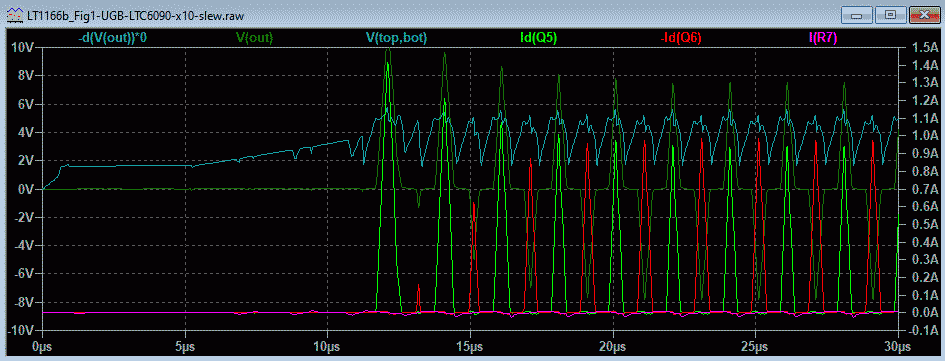

My interest in simulating auto bias loops was after analysis of Bob Cordell's DoubleCross section in his 2nd Edition. DoubleCross seemed to reduce the distortion in the first watt zone to about 100 times lower than classical output stages. But this distortion null cannot be maintained when the transistor temperatures change during normal use. So I thought why not look at using auto bias with DoubleCross? I had never used them before in an amp or simulated them.
After a month of simulations of 3 types: the LT1166, Class-i and Edmond Stuarts AutoBias2 -- What I found is that auto bias can give similar low distortion to DoubleCross for the same idle currents - so no need to use DoubleCross. And there's no need to trim auto bias circuits for low distortion, unlike DoubleCross.
My earlier post 20 using the LT1166 and the LT6090 opamp seems to give sub-ppm distortion at 1W and 1kHz. That's without DoubleCross.
BTW if anyone wants to make Post 20 circuit, the CCS transistors Q1,Q3 will need up rating for Vce. Else use a +/-15V bootstrapped supply for the CCS's then you can use the fast LV transistors. Add an input filter (50kHz 1 pole) and a Zobel (eg 100nF and 2x22R/2W non-inductive).

...The next question: Does that safe operation with SR limiting also apply to driving the top and bottom pins with an opamp? Yet to confirm.

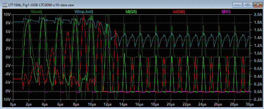

I think the answer is No. Driving the LT1166 Top/Bottom pins with an opamp like the LT1364 at high enough frequency eventually causes cross-conduction that's fatal. Aparently an opamp driving the LT1166 Top/Bottom pins can override the LT1166 bias control function at HF and cause serious problems unless the frequency is limitied.

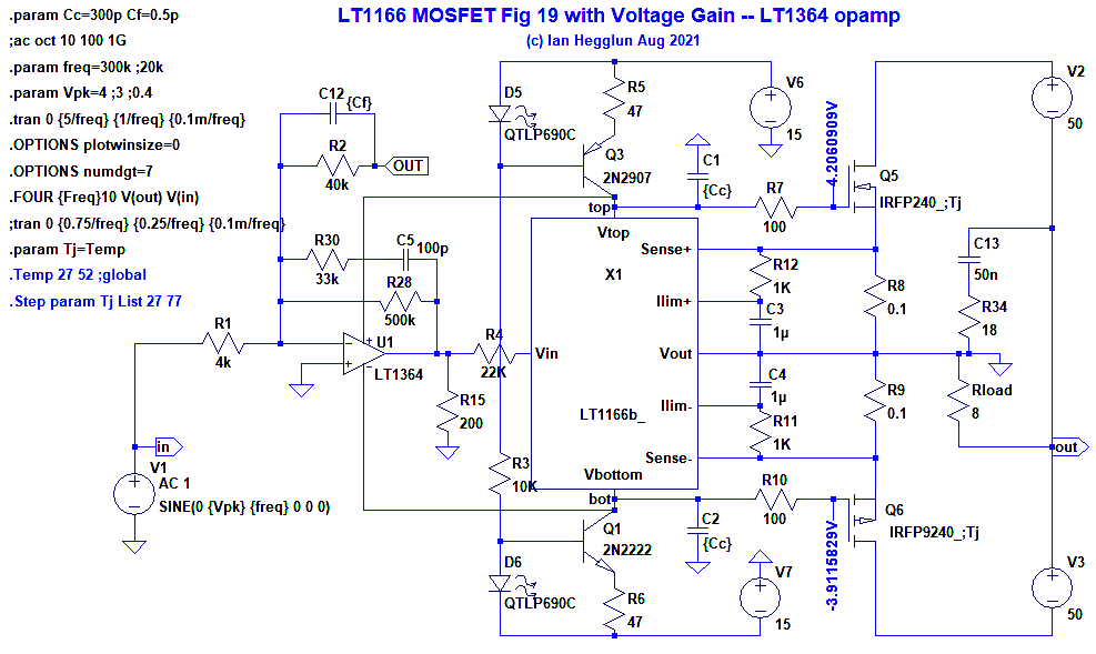

I used the circuit below
Up to 300kHz at full output just below clip of 40V cross-conduction is starting with the p-MOSFET Id6 at 300mA. With 500kHz both are conducting at crossover at 400mA, and 1A at 1MHz.
In Post 9 with drive to the Vin pin cross-conduction did not happen at high frequencies, at 1MHz the bias voltage collapsed and the amp shuts down with no cross-conduction.
So an opamp driving the Top/Bottom pins the LT1166 there is a problem at 300kHz and above which means an input filter should be used. A simple RC filter at 200kHz -3dB did prevent cross conduction up to 1MHz, but 1A cross-conduction was back at 1.5MHz. Looks like a 2nd-order filter is needed (at say 200kHz).
This amp topology allows full output to 200kHz with a slew rate of 40V/us. THD at 40Vpk and 1kHz is 0.002% and idle current is 180mA.
CF Post 20 topology with the LT6060 opamp was 50kHz full power BW and 10V/us slew rate.

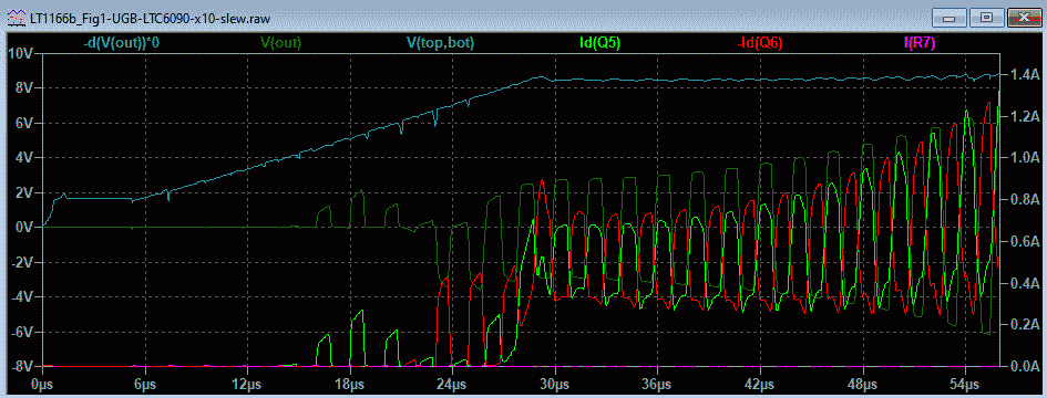

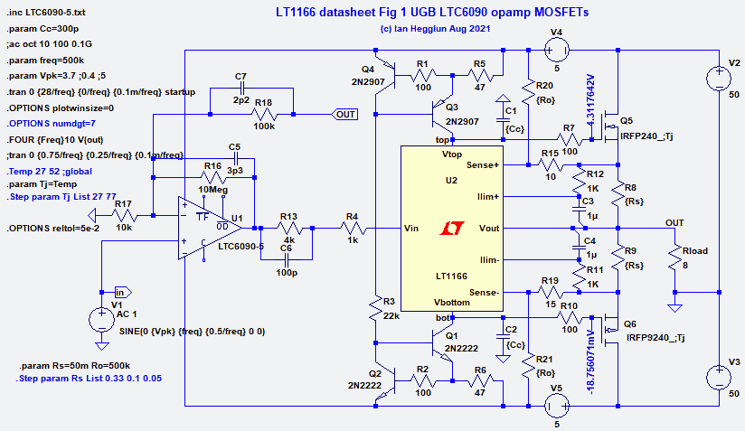

Running the LT-XVII LT1166 model
For a comparison I use the LT1166 model (in Special Function library of LT-XVII). The circuit I use below with no Schottky diode or series inductor.
The LTspice LT1166 model shows with yellow in-fill, my custom model in earlier posts has no fill since it is a custom Block type subcircuit. BTW you can open my subcircuit and see the LT1166 circuit (but not with the LT-XVII model).
First the LT1166 model with 500kHz below
Startup with DC sources from 0V is used because this LT-XVII model did not start with the standard .trans command. I left in running for 2 hours and it still didn't find the operating point. With Startup the circuit reaches steady state after 20us. There is no collapsing of the Top/Bottom voltage like with my LT1166 custom model. But what does a real LT1166 do at 500kHz? I don't have the parts on hand to find out.
Next I uses Startup on my LT1166 custom model at 500khz, below
My custom model gives a different Startup showing high cross-conduction (0.8A) and a slow move to steady-state condition (it rans so slow that I used .Options reltol=5e-2 otherwise it would take hours to get to 50us.
Then my custom model without Startup (standard .trans with the DC operating point) below
This shows the same collapsing of the Top/Bottom voltage that I reported earlier (Post 9). The reason for the collapsing Top/Bottom voltage is a capacitor in my model which I found made it possible to run the LT-XVII LT1166 model without having to use the Startup flag. That is the main difference of my model, a capacitor on the +bias rail for all the CCS's in the LT1166. Somehow adding a capacitor there allows the DC operating point to be carried over into the .trans run. But as we can see from the above plots this capacitor does not give the same Startup plots as the LT-XVII model. So it a case of pick your poison - there is no trouble free LT1166 model as yet.
BTW LTspice has had 4 versions of the LT1166 - the last one (shipped with LT-XVII) works for most of my circuits-- but in this case it can't find the DC operating point, so I have to use 'Startup'. That's not a big problem, but it can't do .AC runs for this particular circuit because it can't find the DC operating point😱.
What does it mean? My previous conclusion that driving the Vin pin is better than driving the Top/Bottom pins assumes my model is giving realistic results. But I can't be sure my model (and conclusion) is valid until my circuits have been checked with a real LT1166. That will take time... Anyone feel free to do some tests? Like Post 9.
The plot I showed in Post 9 at 500kHz with the Top/Bottom voltage collapsing used a custom LT1166 model....Now with the inductor at 500kHz the LT1166 cannot maintain its proper control and the bias voltage falls causing severe crossover distortion...

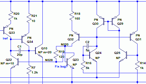

Hi Ovidiu,
Re: Saving OP. Thanks. I remember keantoken mentioning saving the operating point in LTspice but I have never tried. Looks I need to now that I am out of other options.
Re: Your LT1166 circuit.
Thanks again for that post way back then. I used your circuit and the listing in the link to Bob's interview to create my LTspice model. I also extracted the LTspice model from their library file to check theirs against your listing. The LT-XVII model (4th update) is slightly different to the LT-IV three earlier versions and all are slightly different to your schematic.
One difference with all LTspice versions and your schematic is both Q20 and Q23 have their B-C reversed! See below.
I compared the two and strangely I didn't find any difference in the external currents. So I used the datasheet circuit connections for Q20 and Q23 in my subcircuit rather than the LTspice models. Maybe one day we will find out if this is a "bug"😱 or a deliberate "feature".
I attach the present LT-IV model as a block subcircuit (revision dated 28 Aug 2018) for anyone wants to look inside and probe inner currents and voltages etc. The BJT parameters can also be easily changed.
The LT-XVII model has a different bias startup arrangement to all earlier versions, but I can't find my block subcircuit just now to show you.
