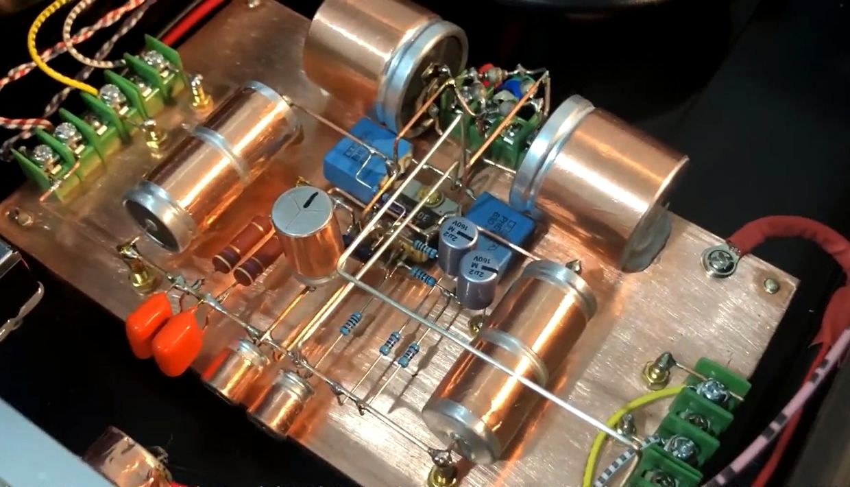

And this with solder but no PCB.

If we have a soldering iron and some thick copper wire, P2P amps like this Juma designed F5 is a lot of fun. No PCB needed.
