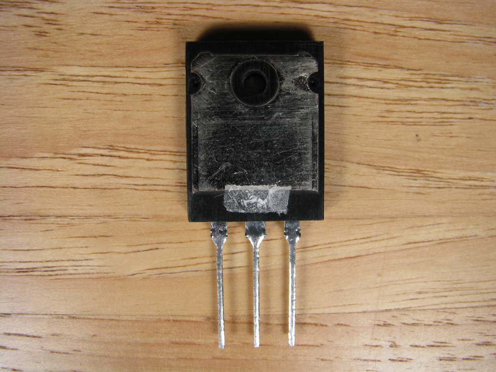

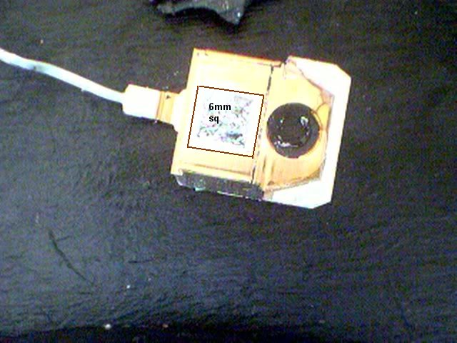

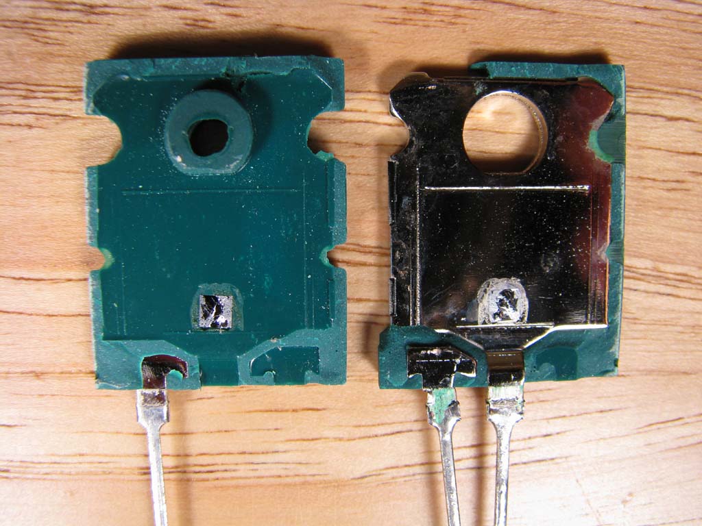

OMG , those dies are small . ON semi NJW0281/0302 are 4 X larger ,the NJW21193/4's are 6 of those. FAKES !!!
mje15032/3 dies are the same size (drivers )
OS
edit - here is the real thing (big die - not glued on , either - attachment)
OS

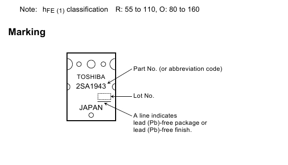

here's the marking layout from a 2SA1943 datasheet. if you compare this with pictures of KNOWN ORIGINAL devices earlier in this thread, you will see the proper placement of the beta code as well. according to Toshiba's Semiconductor Reliability Handbook, the date code is a digit and letter, the digit being the last digit of the year, and the letter (A-L) is the month code (A for JAN, B for FEB, etc,.. with L for DEC). the dot is a factory code, and i've always seen a single dot here on all Toshiba power transistors. the other options are 2 dots or no dots. now for RoHS devices, the date code is underlined,

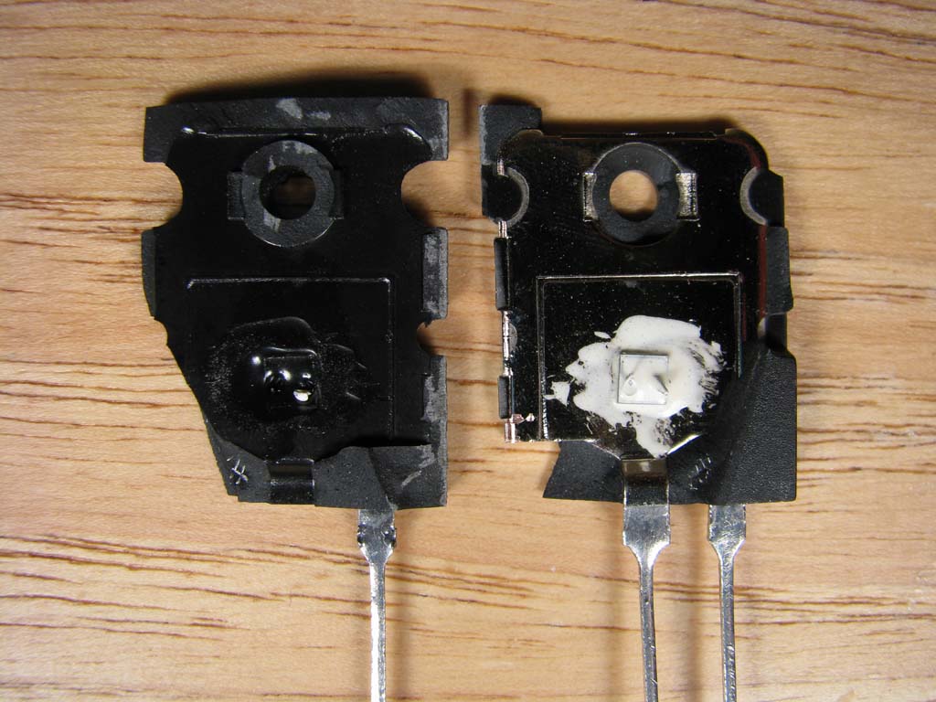

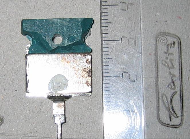

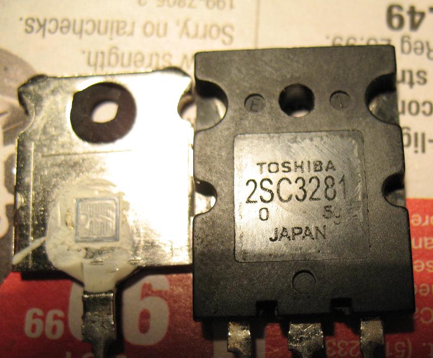

Oooooooo, this is interesting, one chip is smaller than the other, and there is some white stuff on the small one!That ain't a 100 Watt BJT!!!!! 😡
The other one appears to have some copper pad, and has a much larger piece of silicon on it, I killed it!![]()
Well that solves that mistery, I think when I need to find new Toshiba outputs.... I will just go to Ebay and buy some cheap SS amp such as the Fisher CA860 that the really good "O" types were found in.

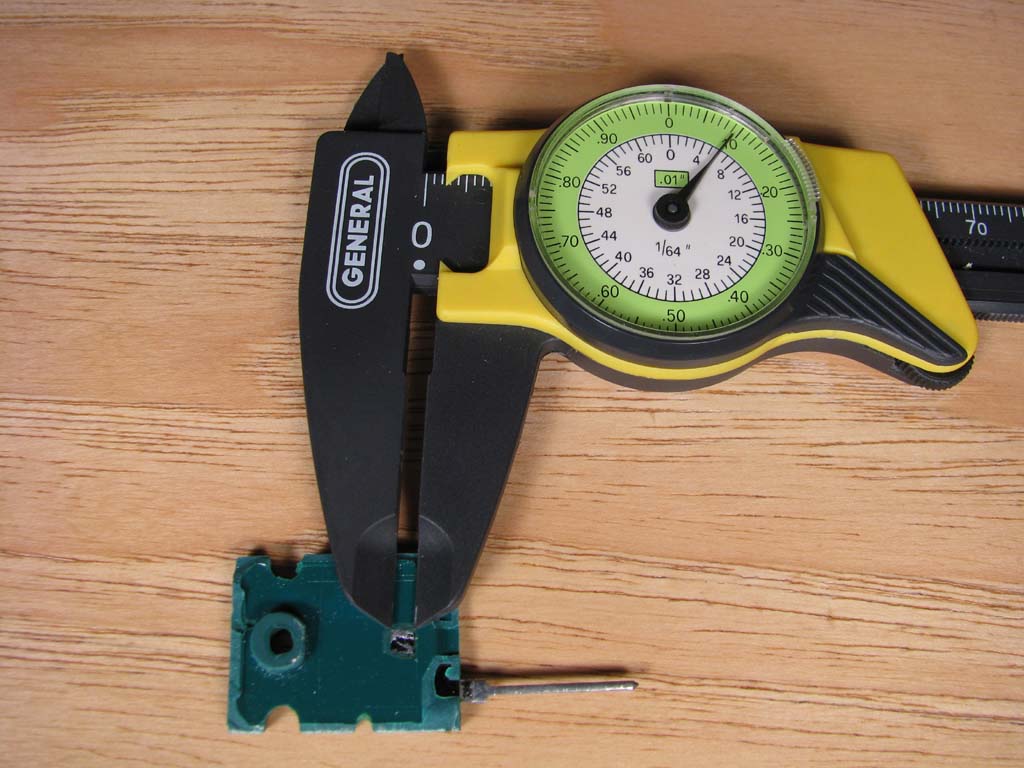

I read over these thread because I have some so called original Toshiba transistors. Need for P3A project..
I purchased here in Toronto from local store "they told 100% orig".
So I break up one after I saw some picture here and sadly realized that 100% fake.
The number on the chip perfect (now is magnified many times so it does not look like) and engraved but the chip inside much smaller than the regular Toshiba's.
When the case similar to to the ON semi "has that island for the writing" that 100% fake after my experience.
Also when the chip is green but the lettering is black that 100% fake to.

Capacitance !
Can you measure base collector capacitance ?
That should be a dead give away.....isn't it ? Most DMM's nowadays seem to have some capability to measure capacitance.
Small wafers should have much lower capacitance. Check what the data sheet says about capacitance. Of course it will not be the same as you will have hardly any voltage on the terminals when you measure but the 'range' might be an indication.

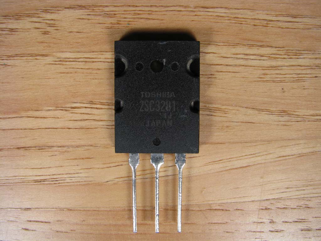

That being said, I've bought my share of surplus NOS C3281/A1302's, among other parts. But I only buy when I can hold them in my hand, crack a few of them open, and then buy from the same tube(s).
