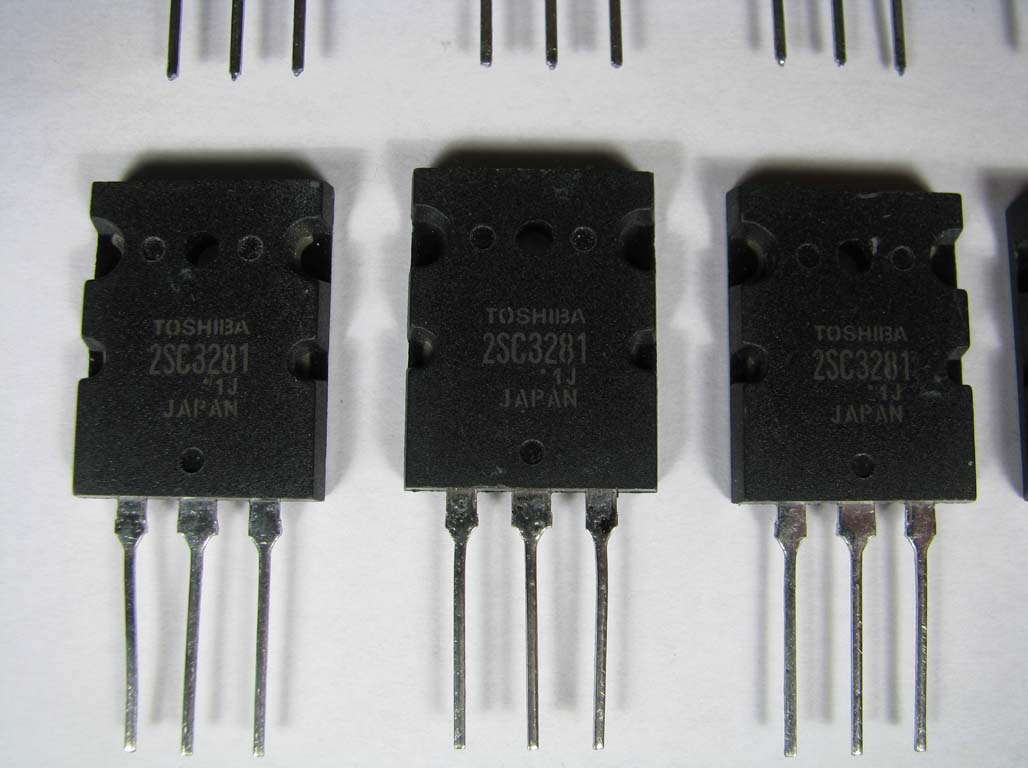

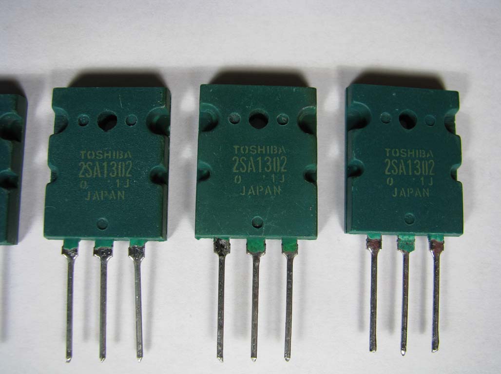

could you do me a favor, and list for each of those two devices the following:
all of the printing on the case
the codes in the dimples on the plastic (as well as which dimple each one is in)
as well as the same for any other sets of known good and known fake transistors you have. i'm putting together a counterfeit identification guide, and i have a theory that the numbers in the dimples have some form of date coding, and the date coding should match somehow with the printed date code.

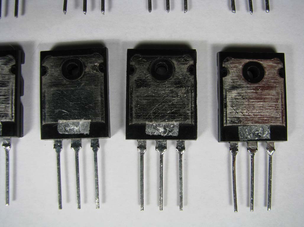

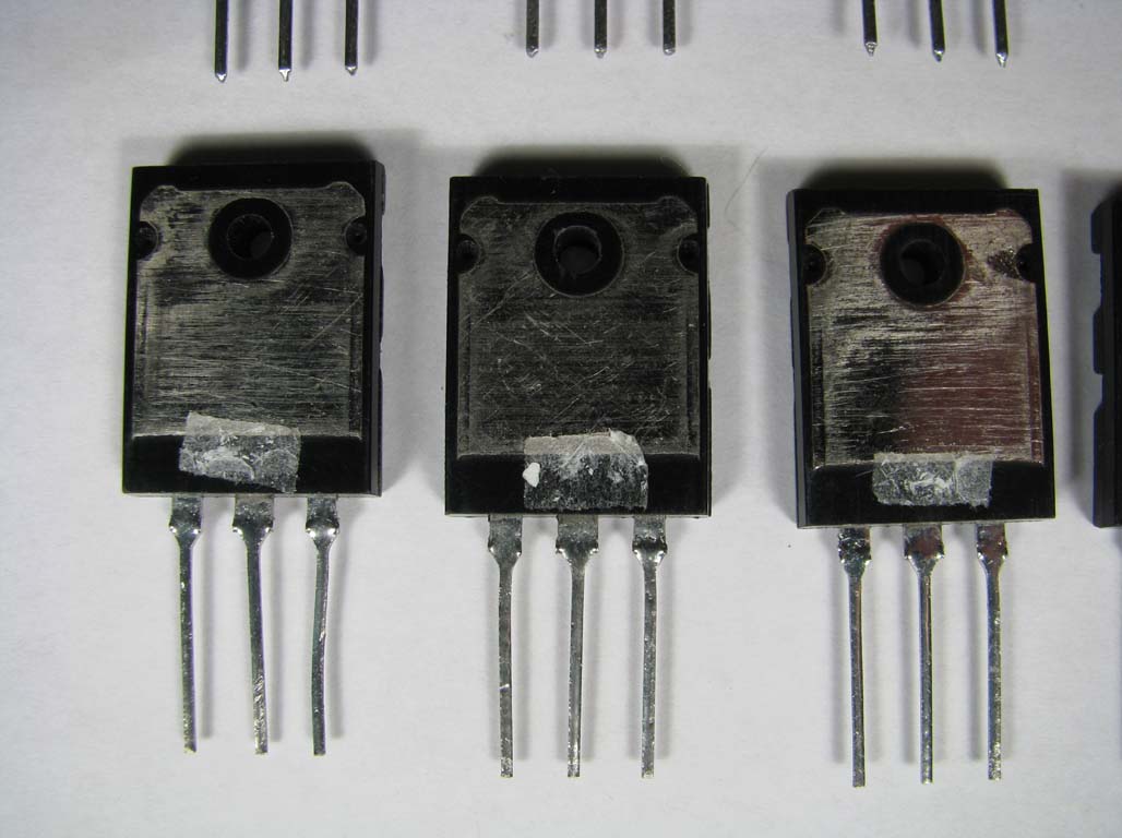

hat was a nice picture. how did you accomplish separating the epoxy from the tab and die so cleanly?
The Funny thing is I made a Video in the process of doing this 😀 My technique only shows me using a hammer and gently whacking them directly on the seam

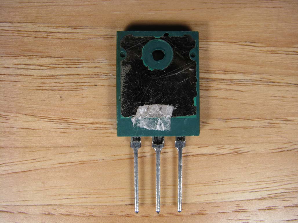

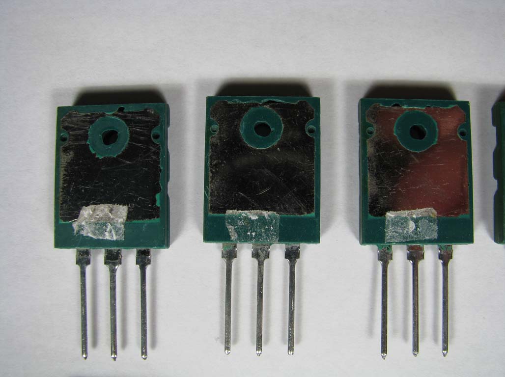

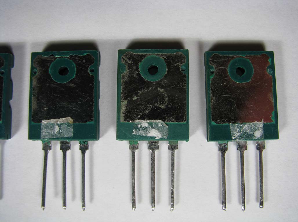

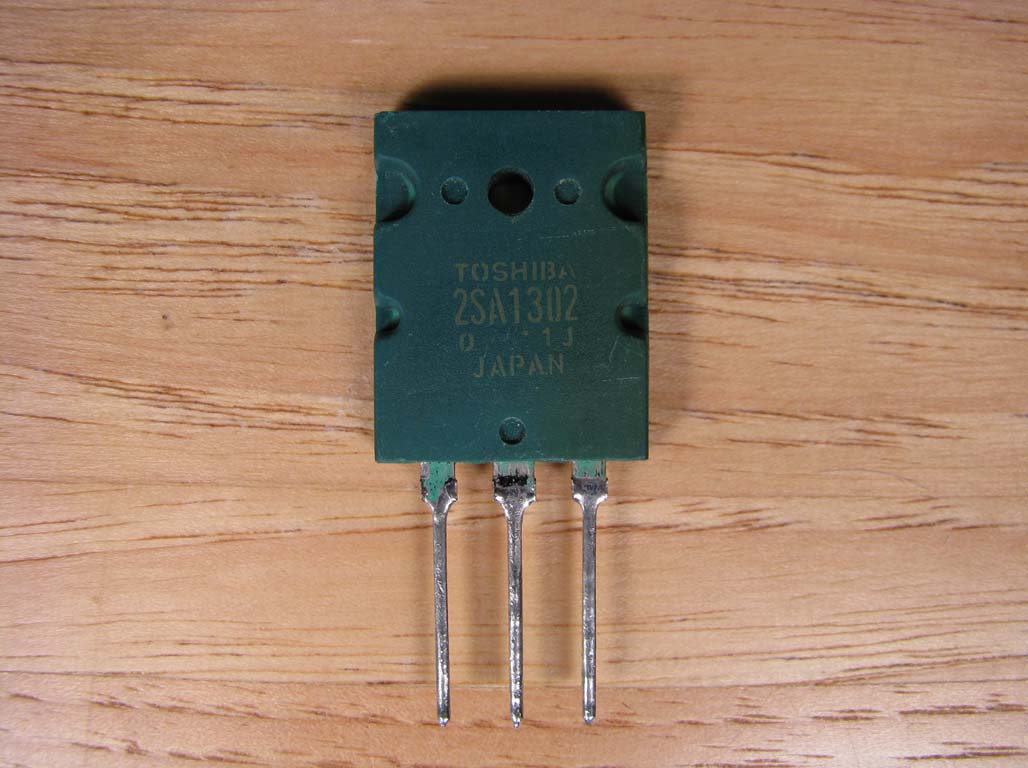

One thing that was obviouse about the green fake was that there was no "O" or "R" and as someone else said the screw whole was smaller, and the numbers just did not look remotely similar to the others.
I would split one of the black ones open but I left the bag of fakes at my uncles house, and won't be able to get them back till next week
I am glad now to have made a video to resort to, because I announce the exact numbers of the green fake; 7L in place of what would be 5H/5I and the number below that was 0109 I sound horrible in the video but it makes for good reference.

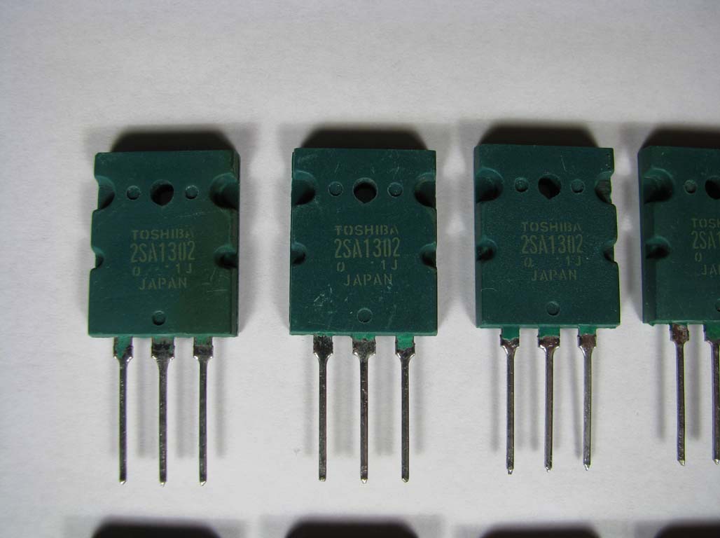

Yep! These ones on eBay seems as real FAKE as they can be. The cheaper lighter green color on PNP package and only partially visible words are a giveaway they are FAKEs. And then, "Japan" underneath is just to assure you they are not made there.
Coming from HK? I wouldn't used them in the circuit even if it's FREE.

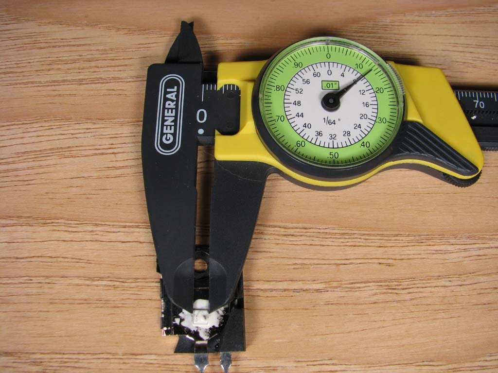

Back at the end of August, I bought some 2SA1302 & 2SC3281 transistors from ebay seller lpcsunny2008. I didn't know about this counterfeit thing at the time. Now that they have arrived, I cracked 2 of them open. They look like fakes to me.
- Toshiba 2SC3281/2SA1302 - Are these fakes?
