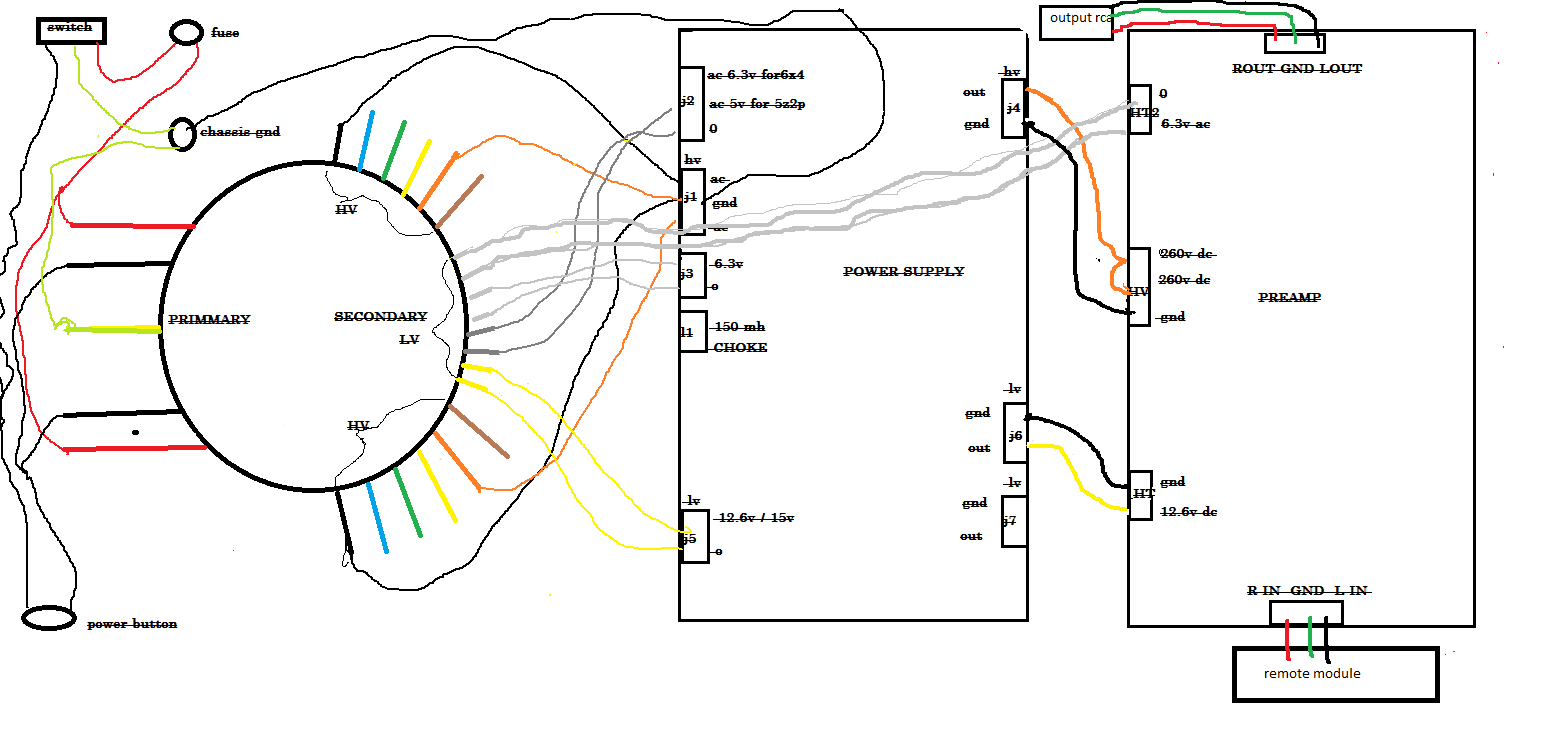

how do i get 9-12v ac from this transformerOutput Power: 132W
Insulating strength: 10Mohm, AC2000V/1min
Input Voltage (AC): 115V /230V 50Hz/60Hz
Output Voltage (AC): 0-200-220-260-280-320 (100mA) x2
0-6.3V (2A) x2
0-5V (5A)
0-18V (1A)

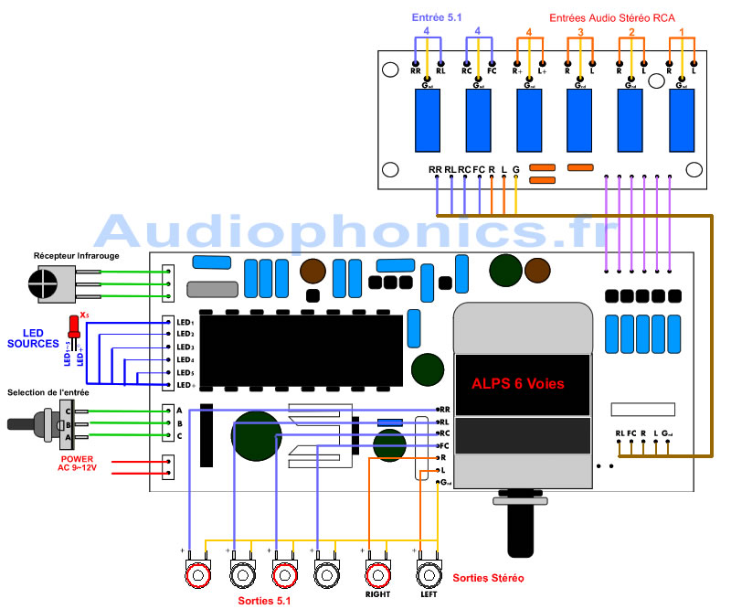

I am installing a MV04 2 Channel ALPS IR Remote Control Volume & Input Selection Module on a preamp IR remote control
ALPS Motorized volume control for 2 channels, board size: 120mm x 55mm
Input selection (4-to-1 way, stereo), board size: 130mm x50mm
input impedance: 100K Ohms
Supply voltage: 9-12V AC
how do you check polarity

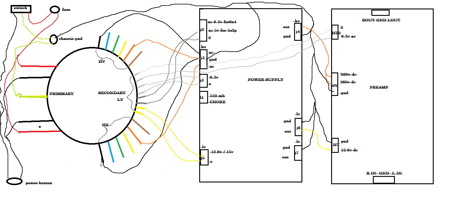

i can,t tie into the two 6.3 taps
No, because they're each being used for two different circuits. They can't be connected together.
You may be able to use ONE of the 6V windings (not the one for the 6X4 rectifier) with a voltage doubler
rectifier to get around 16VDC, and then use a regulator to reduce it to 9-12VDC. But this entire motor/drive
circuit will have to float and cannot be connected to ground anywhere, because of the other circuit that also
uses the same winding.
To be sure that you can do this, post the schematics of the boards that you are using.
