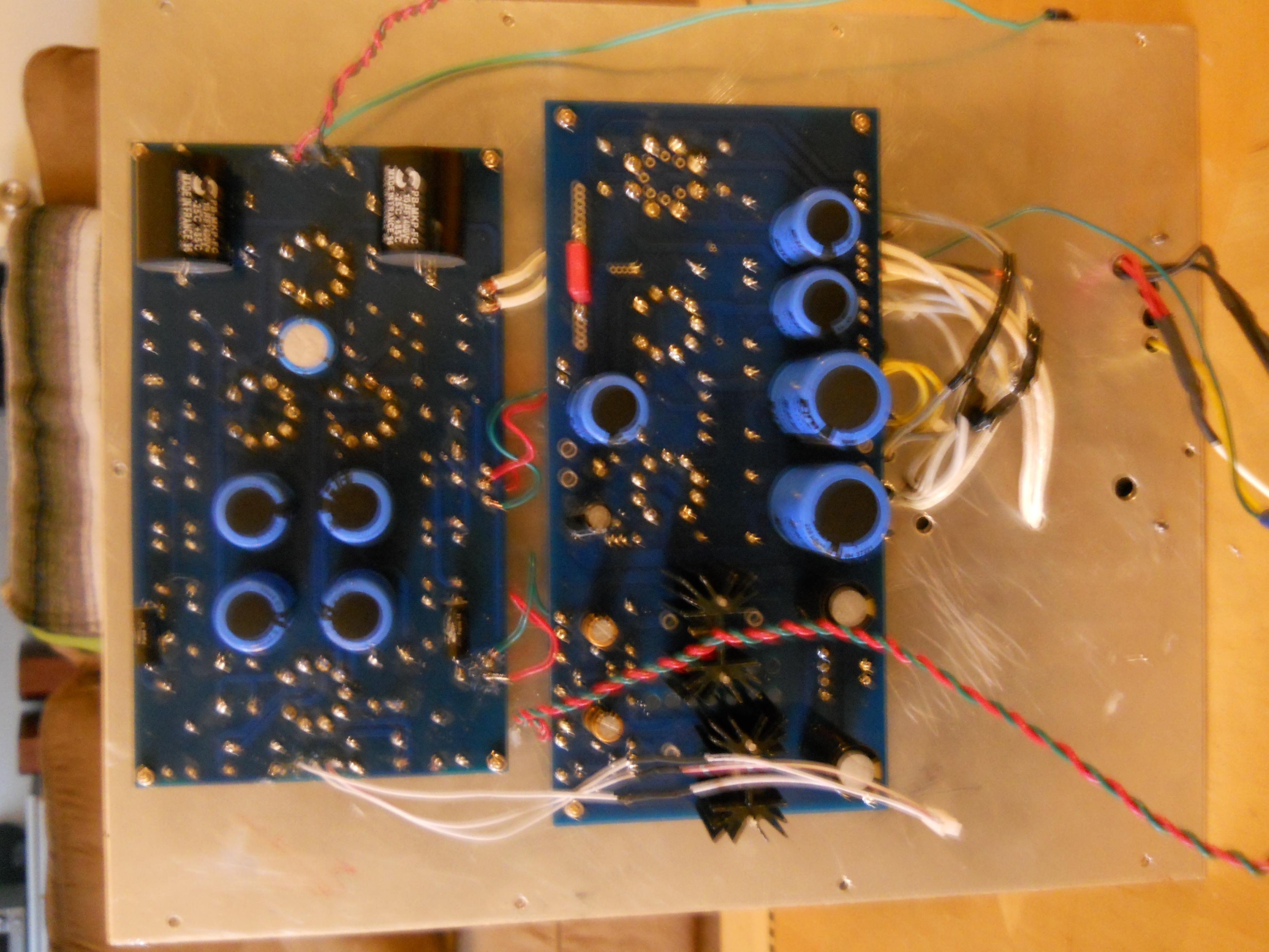

I don,t know what you mean by the grounds connected together ,only using three leads from the
volume control module the R & L and a ground going to the preamp board
On both boards, the left and right channels have grounds that are connected together instead of being kept separate.

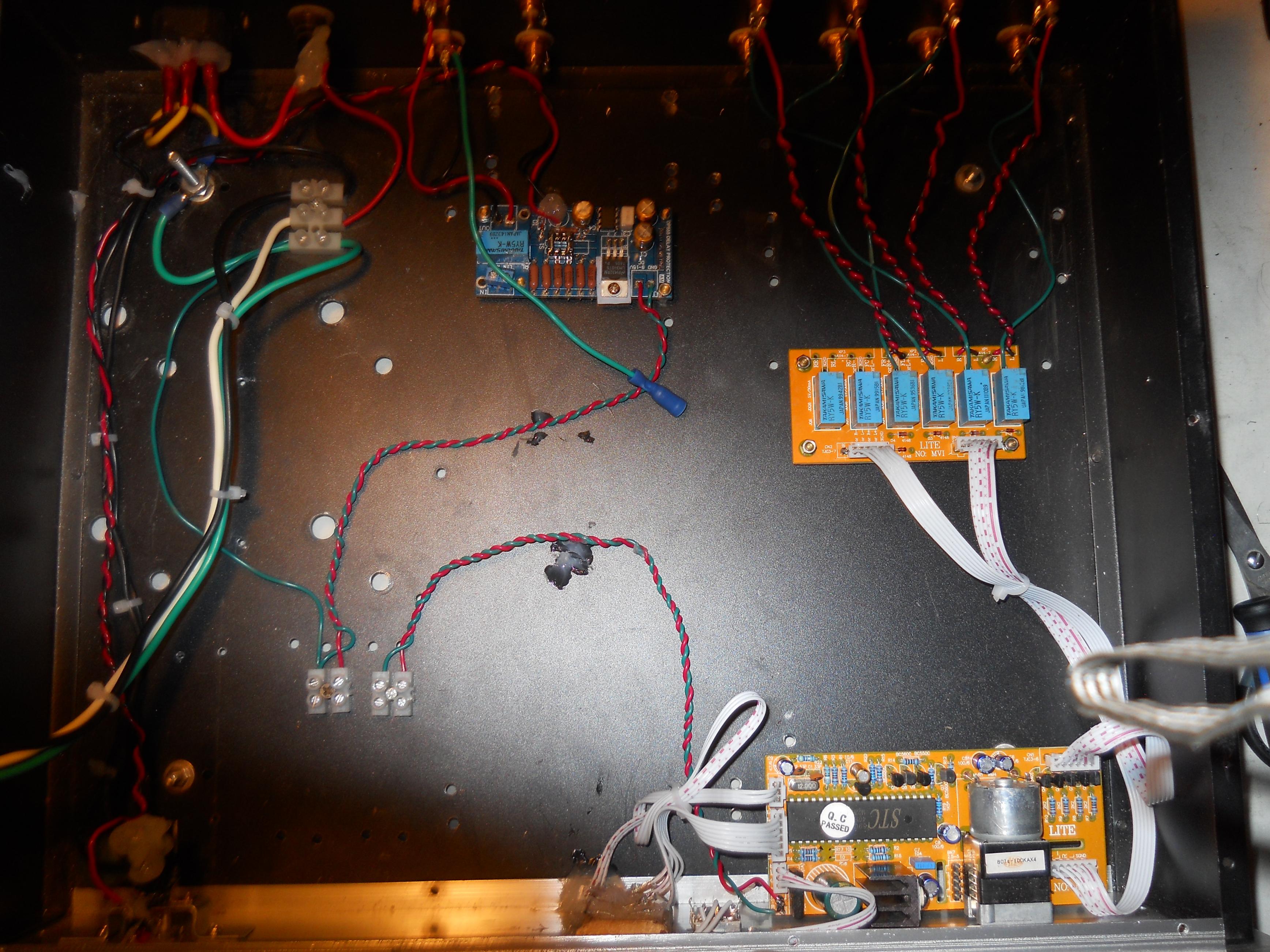

Well I gave the 10 ohm resistor a try with no success . the preamp with the standard pot has no hum , the remote module on its own has no hum, the 9 vac power supply floats on its own , put everything together we get a hum . not sure what to try next.
Remove the resistor entirely. Now try only connecting only the left channel and the ground all the way through,
from the input to the output. Is there hum now?
Next, try only the right channel all the way through.
Not sure how much more soldering and desoldering the preamp and rca can take things are looking rough ,also the hum or buzz comes out of both channels don,t understand by removing one channel then the other what it will tell me.

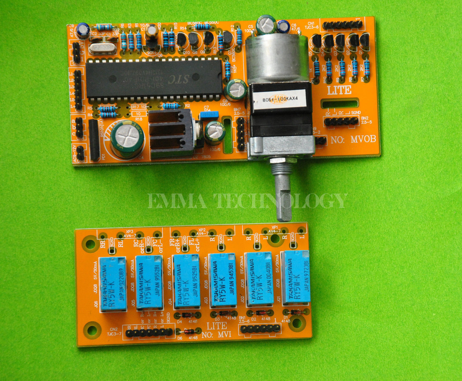

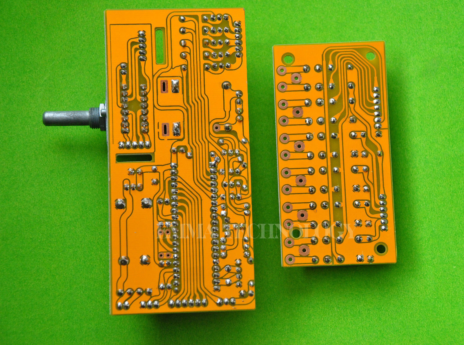

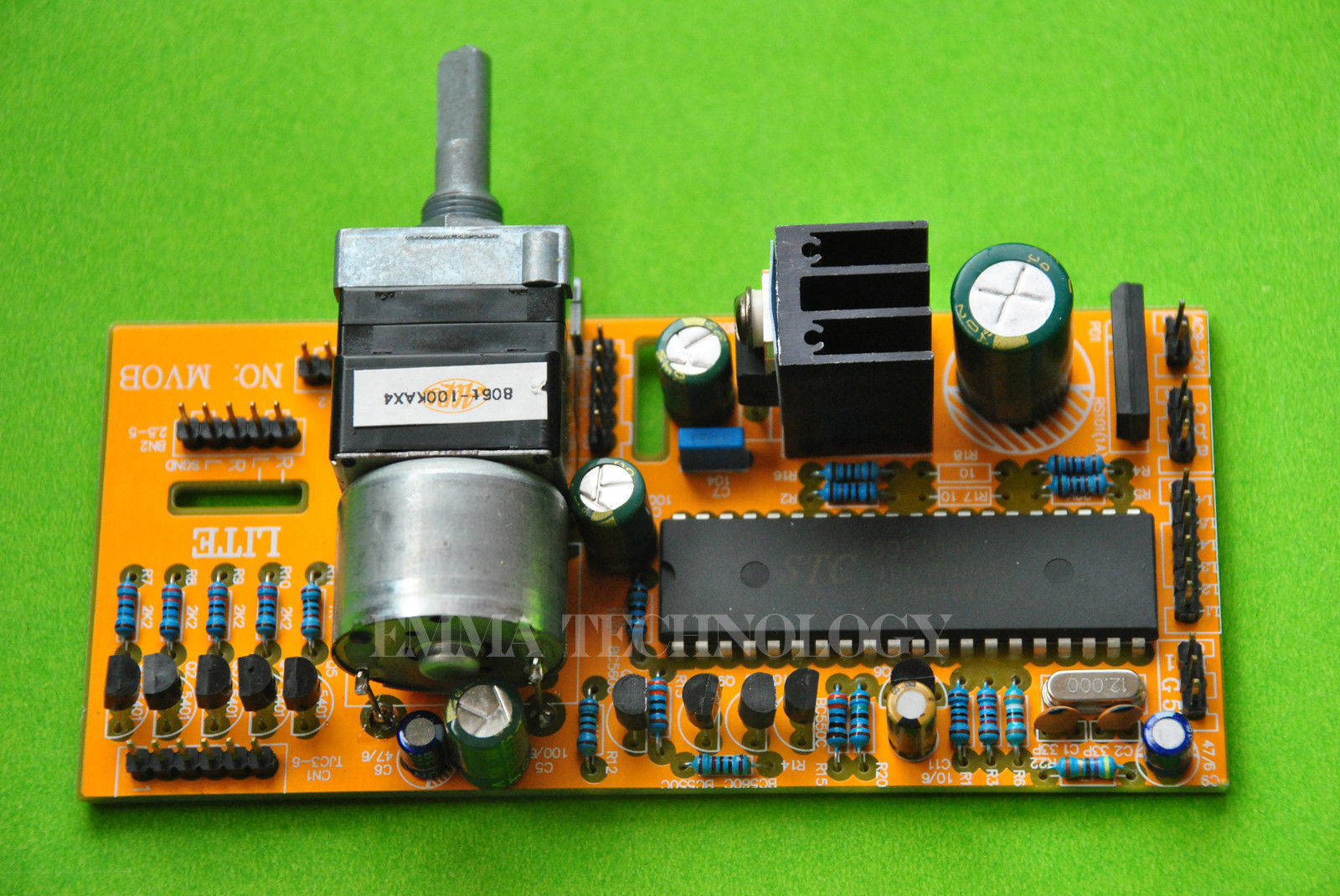

here is some pics of the boards
My guess is that this board does not have the analog and digital grounds separated
by the RC parts as in the schematic, but instead the analog and digital grounds are all
connected together, and cannot now be separated due to the board design.
This may be your problem. Can you discuss this with the mfr?

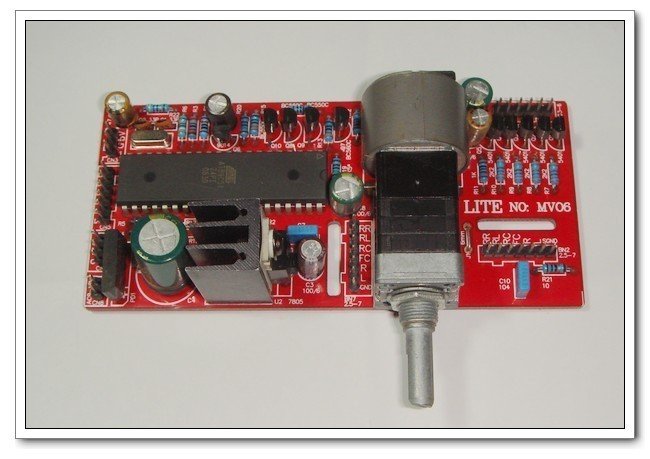

I found this one that has the r21 and c10 on it.
For a good reason, I suspect.
