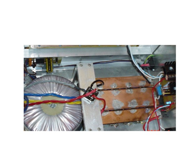

Here's my list of improvements,
1. Earthing.
IMHO I found this had a significant impact on hum and dynamics when developing my prototype Aleph 2 construction.
Use a 1 - 2 millimeter copper sheet to terminate your capacitors, not wires.
This seems to work better than simply sheer capacitance which tends to crush the dynamics if you are not careful.
Terminate the star ground point a short disance from the central point of the capacitors using a short copper spur. this will reduce hum from the large charging currents.(aka D Self)
see the image below.....
