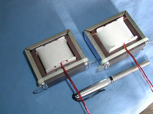

Forgot to say that in addition to the inductors I also made the following additios to the Aleph 4.
Bypassed the CCS zener to the dif pair with a 0.1u and also added a 0.47u to each rail, all of these caps are Wima MKP 10.
All in all very worhtwhile mods.
Did some extensive listening yesterday night. As soon as the break-in was almost over (about 3 hours) everything came in very nicely. No problem with bass slam as I mentioned before.
Not to say that the sound is dry but it seems to me that some decay information is missing, think that this has to do with the low voltage I now have on the rails (32V down from 44V).
CLCRC PSU
Now having the LCRC PSU I plan to add jet another section to it not because I need it but to get the rail voltage up again, And also because I want the inductors in that position to protect the caps which are only rated to 50 V (63V surge).
So the next step is to add some caps on the front to end with a CLCRC type of filter (kind of overdone???).
One question, is there a way to calculate the amount of capacitance needed at the front to get a desiered voltage?
