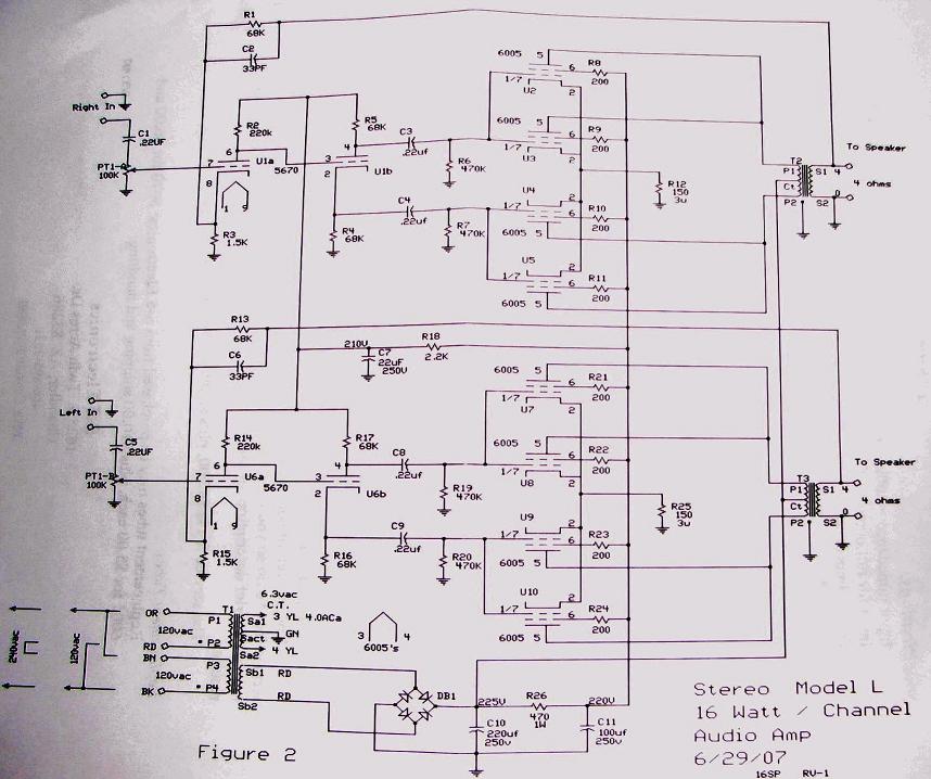

While searching, I did manage to find a production circuit that actually uses GE 5760 tube.
Interesting "nested" arrangement has 6db preference for the sound of the 5760 instead of the sound of the output tubes and output transformer. Probably, this mild amount is for leveling out the frequency response? Can this be done to prefer the sonic signature of a tube instead of the sonic signature of a sand amp, by the same proportion as the global negative feedback aka nesting?
Yes, the negative feedback is there to reduce distortion and to flatten the frequency response. However, I take it you will only be using the input stage and phase splitter portion of this circuit. I assume that the LM1875 accepts line level inputs. This would mean that using a concertina phase splitter (i.e. one 5670 half per channel) would be ok, since you don't need over-unity gain. You could decide to buffer the input with the other half of the tube (then you'll need 2 5670's for stereo) as is done here, but you won't need much gain. Less than in the schematic you posted above.
I don't think there's a ready-made and optimized schematic for your particular application. The topology of the 16LS kit (which I assume that is) you refer to will certainly work, but it might (will) need optimization for your particular purpose, since driving a PP (double) pair of 6005's is different from driving an LM1875.

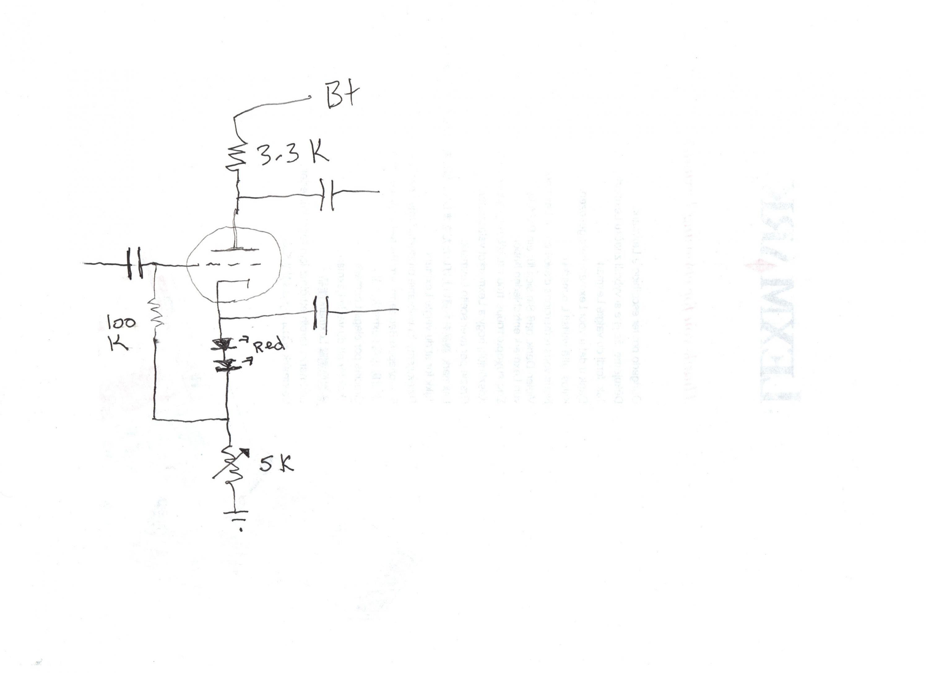

I think you can achieve that which appears to be your objective, using the 5670. It seems you want circuitry that adds a small amount of 2nd harmonic distortion to the "harsh", digitally generated, I/P signal. It is common to use at least 3X the triode's plate resistance as the net load impedance, as this makes for linearity. Use a lesser load and HD goes up, which is what your application needs. 😉
I've attached a crude schematic of a setup which serves as both I/P buffer and phase splitter. The 5 KOhm variable resistor is adjusted to make the pair of 180o out of phase signals otherwise "identical". You will need the "160" V. supply I mentioned previously.
Thank you for the drawing! Its very simple and do-able. Those LED's--clear, but shines with a wine red light? Is there a specific model or range of tolerances / specifications to look for?
To put it bluntly, many of the codecs, especially MP4 types are dull at the voice band and with treble harmonics that's slightly shouty and otherwise missing. So, the needed effect is "fresh" as in "nearly brash," but Not actually raspy. And yes, it would be wonderful if the amount of effect was adjustable.
Caveat: Most computer sound cards do well with approximately 11k load, else the extra low bass notes may be absent. I don't know why.
Pick LEDs that can comfortably handle the 9 or so mA. of current present. Off the top of my head, I don't know what size ("regular" or jumbo) to use.
You can tweak the grid to ground resistance, but a lower value requires the I/P cap. value to increase. That RC combo is a high pass filter. Speaking of the I/P cap., use a Soviet surplus paper in oil (PIO) part there for smoothness.
An important feature I left out of the drawing is a grid stopper resistor. Install a 1 KOhm Carbon composition (CC) part, with its body as close to the grid connection socket lug as can be. Use the "free" end of stopper as the connection point for the I/P cap. and grid to ground resistor. High transconductance (gm) types are vulnerable to parasitic oscillation. The stopper resistor is installed to block that nastiness.
Very much unlike the CD player source: With a computer source, you don't want to hold back any part of the audio band at the amplifier's input. With computer source, its like a "tug of war" and so a critically clean cap choice is needed for input.
Any standard (i.e. cheap) 5mm led will do; those are usually rated for 20mA, and light up pretty much completely at half that current. So as a nice bonus, you get some red light.
Note that in the schematic Eli posted, the 5k variable resistor is not used to dial in more or less distortion; it is used to adjust the balance between the in-phase and out-of-phase output signals. Which, incidentally, one could also interpret as a means to introduce (or prevent) distortion, so it might be what you're looking for. The HD Eli refers to is caused by choosing a relatively low value for the anode resistor (the 3.3k one). Of course, you could consider experimenting with that value as well for the most enjoyable amount of distortion.
