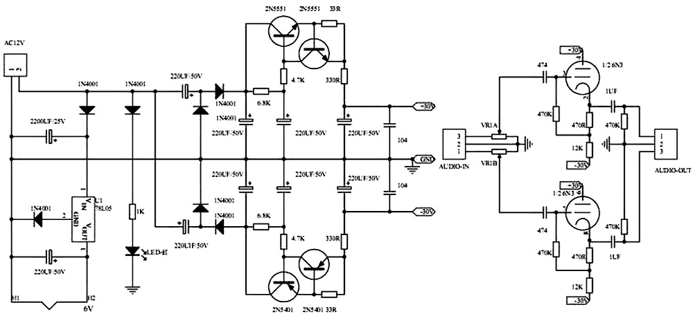

I'm looking forward to the example schematic (the 6n3 one); perhaps clears things up for me!

Clears things up? Exactly! This circuit's crisp clear treble enhancement will clear up a Sony HD radio, MP4 and also AAC movie sound. It will clean up any dull, lackluster source.
It can also be used at the input to a dull amplifier from Best Buy, and together they will sparkle.
It has an error. You'll have to cut the gain by 40% or else it will clip. Fortunately, it comes with a volume pot for this.
I wonder if one couldn't simply connect a 28vac transformer to fix the clipping issue?
This circuit requires an extra cheap 6n3. It won't make treble enhancement with GE 5670, because GE 5670 will increase midband instead, and I cannot find a practical use for that.
But, if you've got a super cheap 6n3 and a terrible Sony HD radio. . . this circuit posted literally will clear things up for you: 🙂
Nope; it would squeeze the tube (i.e. drastically reduce its headroom) and only worsen the problem.I wonder if one couldn't simply connect a 28vac transformer to fix the clipping issue?
The circuit you posted probably calls for a 6n3p; the 6n3 is a rectifier tube. Due to the low voltage and relatively small load resistance, I expect this circuit to add the same sort of 'coloration' (i.e. some harmonic distortion) just like Eli's proposal. You could consider using your 5670 as a buffer in the same way and implement it as a cathode follower, making for low output impedance and limited gain. It won't work as a phase splitter this way, of course.
Well, there's subjectivity for you: in my book, this circuit won't 'clear' anything up; it will 'soften', make for a 'warmer sound'. That's exactly my problem with subjective terminology. To you, it means something different than it does to me, while both of us may think that we have a common understanding...this circuit posted literally will clear things up for you
The right effect for cancellation of distortion in MP4 types would make an Increased Amplitude at 8khz and Up (high TREBLE INCREASED) due to triode type harmonic distortion. The 6n3p example does this more elegantly than usual.
The only forms of warm that are acceptable are those which are unavoidable:
1). The temperature of the diodes, tube, heater regulator, the amplifier heatsink and the elements of the capacitive multiplier.
2). The MP4 type input signal and Sony's HD radio's dull AF section, and/or a worn out tape.
Please don't think of the needs with a CD player source--that is opposite of what is needed.
Instead, computer MP4 and similar sound just needs a greater amount of richer treble.
It certainly doesn't need the intelligibility reduction of an unnecessarily warm mid-bass boost.
Uhm, this seems a bit odd; could you provide a reference for this? In my mind,The right effect for cancellation of distortion in MP4 types would make an Increased Amplitude at 8khz and Up (high TREBLE INCREASED) due to triode type harmonic distortion.
'Increased Amplitude at 8khz and Up' is effectively a high-pass filter. This has little to do with even order ('triode' type) harmonic distortion, which to the best of my knowledge is present throughout the audio band in any reasonably well-designed amplifier. If you want to lift anything above 8kHz, I suggest implementing a simple RC high pass filter.
Note that no amplifier can restore any high-frequency data that is absent from the signal source, which is often seen as the major drawback of digitally compressed audio, even though some 'MP4' compression methods are in effect lossless and therefore offer precisely the same audio quality as the original source (note that the DST compression used for SACD is also part of the Mpeg-4 complex).
I still don't buy that, since several high-end audio cards (still within the price range of the average consumer) offer more or less perfectly linear frequency responses up to 20kHz. But if you feel it's necessary, then go ahead and implement a high-pass filter. But personally, I would recommend investing in a decent sound card (and not use the onboard solution in your off-the-shelf PC or laptop, which can be crappy indeed) before trying to solve quality issues further downstream.Instead, computer MP4 and similar sound just needs a greater amount of richer treble.
Having said that, I'll promise not to nag about this any further and just try to help you out where I can 😉
