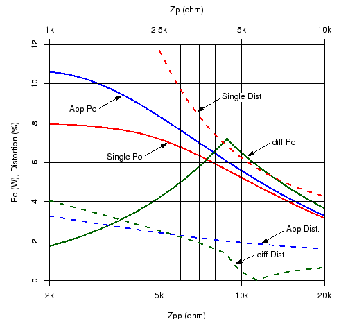

Class A push-pull and differential push-pull output stages have different characteristics as shown in the following graph, whether you can hear the difference, that's another story. Anyway, some food for thought...
App - Class A Push-Pull
diff - Differential Push-Pull (as used in Pimm's Tabor)
The graph courtesy of Ayumi Nakabayashi.
